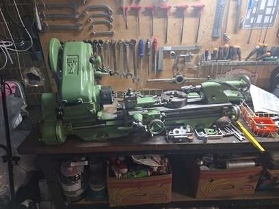

    davp1971
      @davp1971

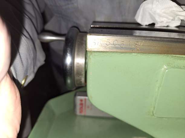

      A few months ago I bought a Myford super 7 in the Netherlands. a metric. I have a few questions here for the experts. the serial number is on the back SK50519. As far as can be found in the lists, it dates from approximately 1961. the lathe has a green color. Also the base cabinet that was there. Normally the green color was from the 70’s (1977 i found now). I had to do a repair on a part and there is a gray layer under the green color.
      Does anyone know if some Myford lathes for certain departments were already painted green at that time? How could I tell if this myford has already been overhauled?
      The next question is about the raising blocks. Normally there should be an adjustment screw here. I thought a 9/16 bsf. but in my blocks there is only a 5/16 bsw at the top (also on the bottom).
      blocks 1serial 1myford 1 klein

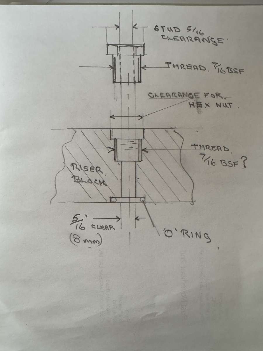

            JohnF
              @johnf59703
              Hi, I think there are two types of riser blocks, one with levelling adjustment and one without — not sure why but it maybe the fixed ones are for use with the industrial cabinet and the other adjustable ones for bench to other mounting ?
              However I made a “from memory” sketch of the mounting block hole/stud/adjuster arrangement, I’m not certain of the adjuster nut OD thread at 7/16″ BSF it may be 1/2″ BSF ?  I don’t want to disturb my lathe !
              Rooting around I also came upon this which might be of help https://misterlinnsworkshop.wordpress.com/2014/04/29/mounting-mounting-blocks/?

                noel shelley
                  @noelshelley55608
                  Johns sketch is unlikely to work as the 5/16 clearance hole and the 7/16 thread will leave nothing to support the lathes weight. The original may have been 9/16″, but for simplicity 5/8″ or 16mm will work. There is no need for the recess for the jack screw head, it was not considered required on the original and would require a large drill or mill to make it. Noel.
                  #777433
                  JohnF
                    @johnf59703
                    Yes it will Noel,  the 7/16 nut is screwed into the riser block, the lathe foot sits on this, the stud passes through the bench/cabinet with a nut on the bottom then through the riser block, then the 7/16 nut and the lathe foot with a nut on the top to clamp.   The 7/16 nut is used as a jack to level the lathe foot and clamped with a nut on the top.

                        1) Your S7 was made in September 1961 and would have been grey.
                        2) The fact that you still have the serial number on the back says it has never been reground so that’s a good indicator.
                        3) Your raising blocks did not originate from Myford. Various companies made the cheap version that you have but, as others have said, they can be made into the Myford pattern.
                        Dennis

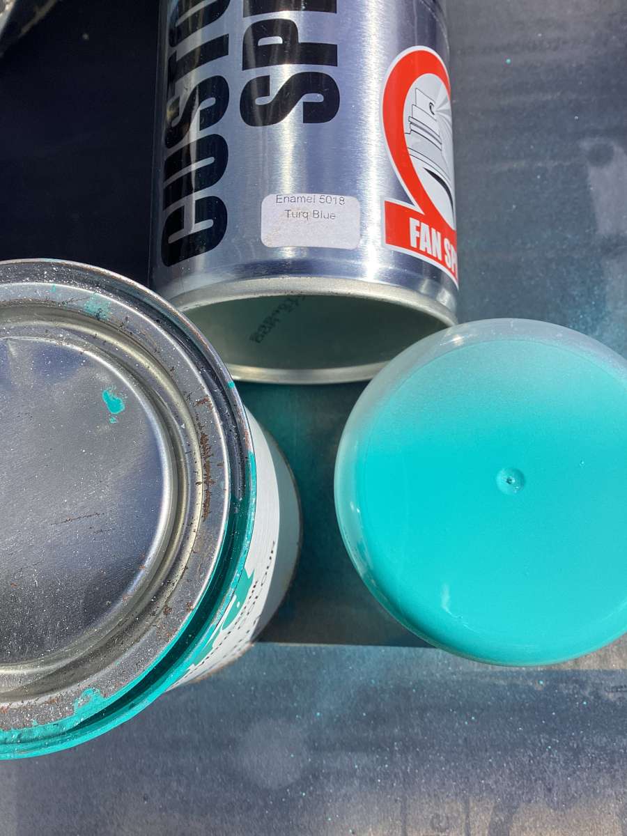

                                Bootlegger Blacky
                                  @bootleggerblacky
                                  Hi, there seems to be a lot of misleading articles about the correct RAL. or BS colours that Myford originally used on their lathes.
                                  I have now resigned myself to restoring my Super 7 in their premium colour that is Aqua.blue. More aesthetically pleasing than dull old grey?
                                  RAL. 5018.

                                    John Purdy
                                      @johnpurdy78347
                                      I’ve just checked the adjusting nuts on the raising blocks on my S7. They are 5/8″ AF and although the is not enough thread showing to measure what I can see is just smaller than the AFs of the hex, so I would guess 9/16″.
                                      #793205
                                      noel shelley
                                        @noelshelley55608
                                        From memory John your right, 9/16″ and I think BSF I bought the taps and die to do this, but can’t find the roundtuit ! Yet. Noel.
                                        #793210
                                        John Purdy
                                          @johnpurdy78347
                                          Noel, being British, in cast iron, and mid ’70s I would have guessed BSW. But perhaps you are right and BSF would be more appropriate as it would provide finer adjustment. There isn’t enough tread showing on mine to tell, and I am not about to take it apart to find out, sorry!!

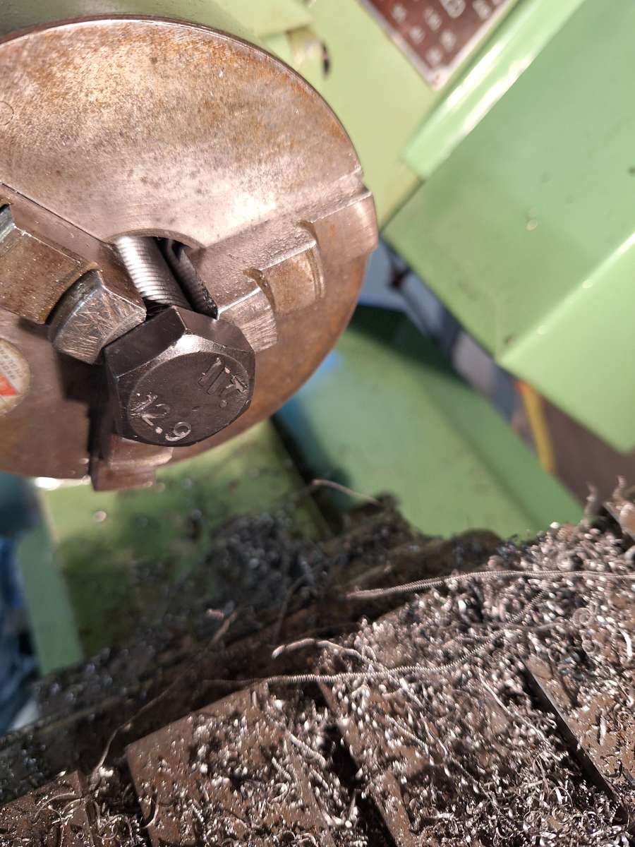

                                          Contrary to John F’s drawing above there is not a recess in the top of the raising block surface for the hex.
                                          #793224

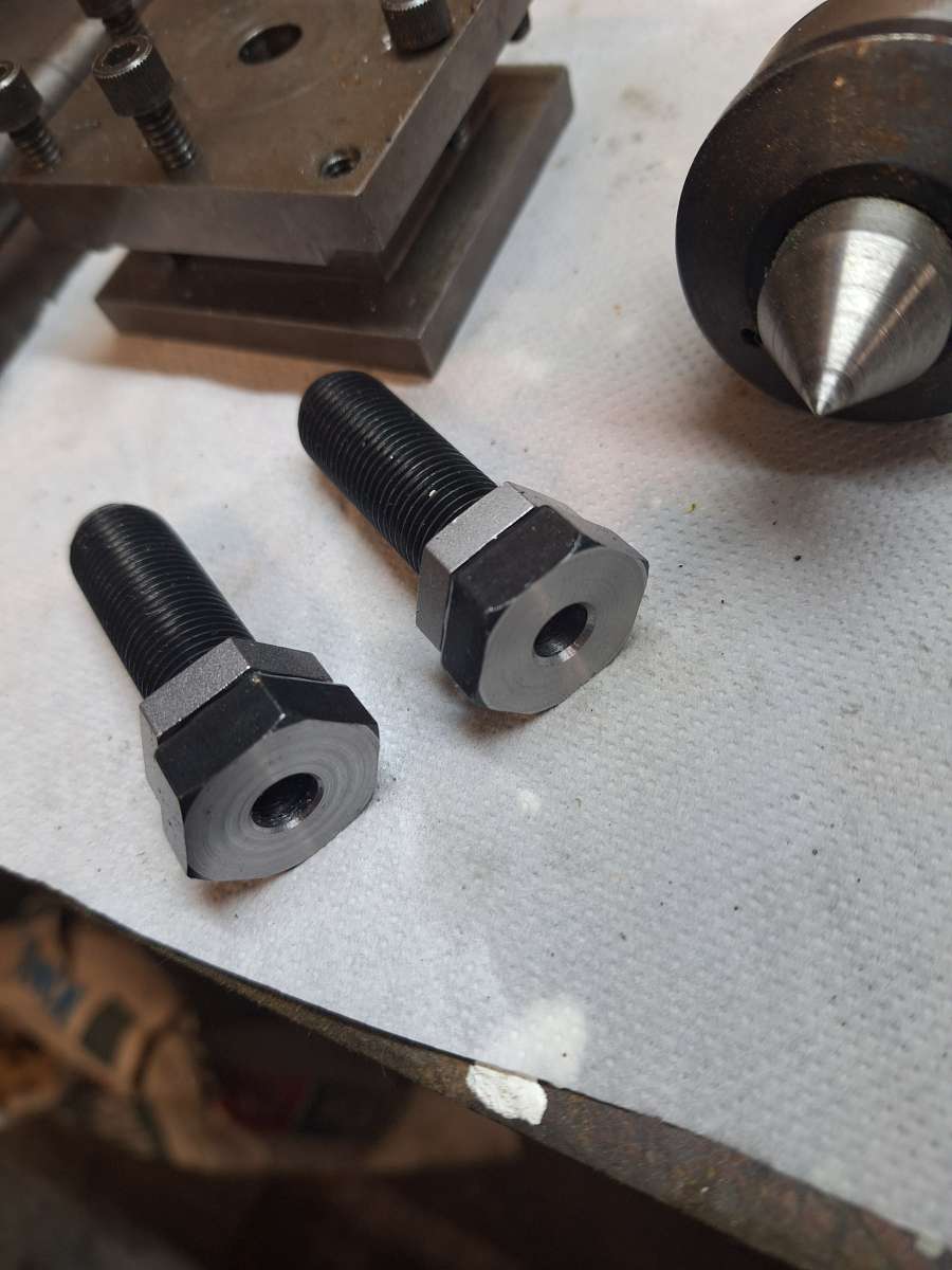

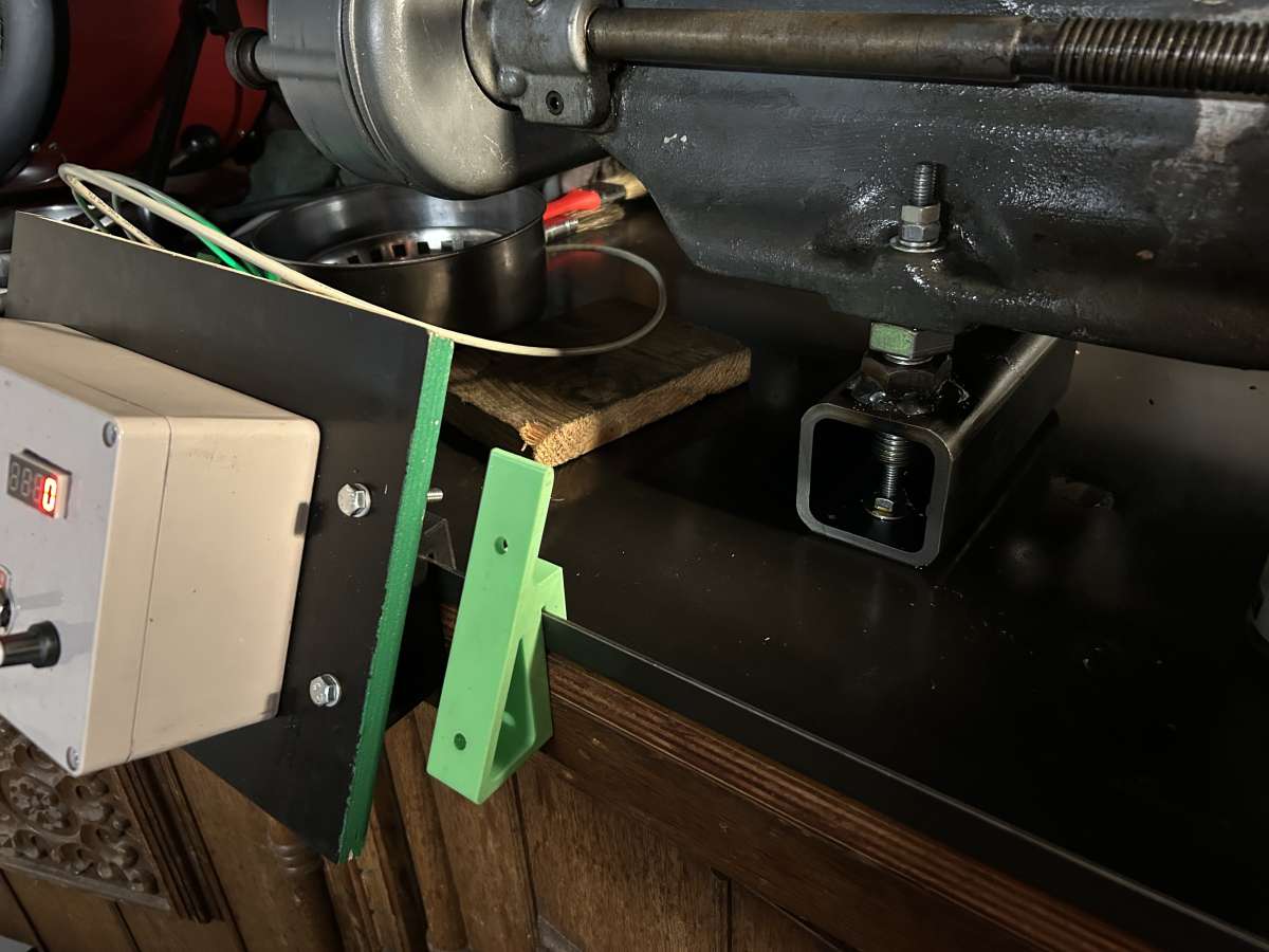

                                          davp1971
                                            @davp1971

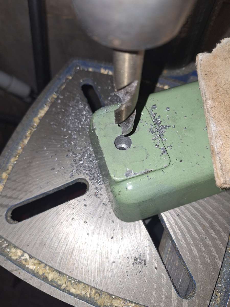

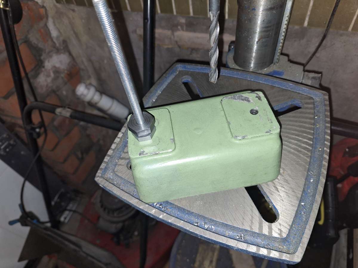

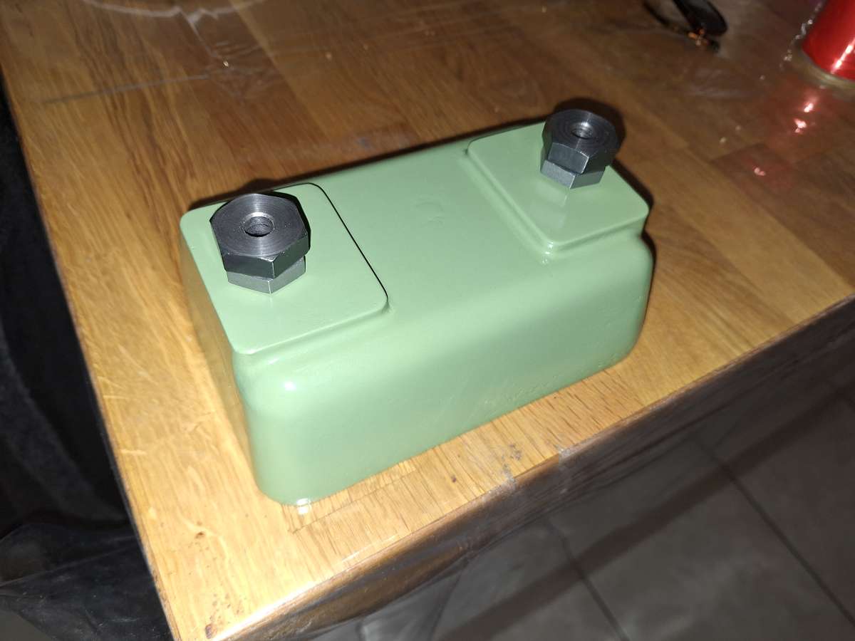

                                            It’s been a while since I posted anything. But I haven’t been sitting still. I followed your advice and adjusted the blocks. with an M16x1.5 bolt and nut. this worked perfectly for adjustment.
                                            #793227
                                            davp1971
                                              @davp1971
                                              20250127_12395720250129_17520520250129_17523220250130_16404720250202_073301
                                              #793231
                                              John Purdy
                                                @johnpurdy78347
                                                Neat adaptation! Should do the job admirably. It looks like you have added a locking nut on the 16mm adjusting bolt, the original didn’t have any. The original also had an “O” ring around the mounting stud in the bottom of the casting as per John F’s drawing above. Was to seal the hole through the bench top and is only needed if flood coolant/cutting fluid is to be used.

                                                halfnut
                                                  @halfnut
                                                  <p style=”text-align: left;”>With all the oil that pukes out of Myford headstock bearings and lies in the catch tray, o-ring seal on the riser bottoms is a good idea. As I realised last time I looked under the lathe bench.</p>
                                                  Not sure about lock nuts though. Don’t they jack the male threaded part upwards a small amount when nipped up? Or is it not noticeable?
                                                  #793249
                                                  noel shelley
                                                    @noelshelley55608
                                                    As has been said, The lock nut is not really needed as the long through bolt holds everything together, in fact could make things difficult setting up. On the Myford version a shallow spot faced hole in the bottom face of about 5/8″ dia held an O ring ( about 2.5mm  section )to stop lubricant or suds leaking into the cabinet below.
                                                    For those with a flood suds pump and jack screws on the stand, setting the stand to a gentle slope to the left whilst the raising blocks set the lathe horizontal  allows the suds to flow back to the reservoir. A small magnet near the return will catch the small swarf.
                                                    Danny s pictures and the job give a good example of the task and a good choice of thread in this modern world. Noel.

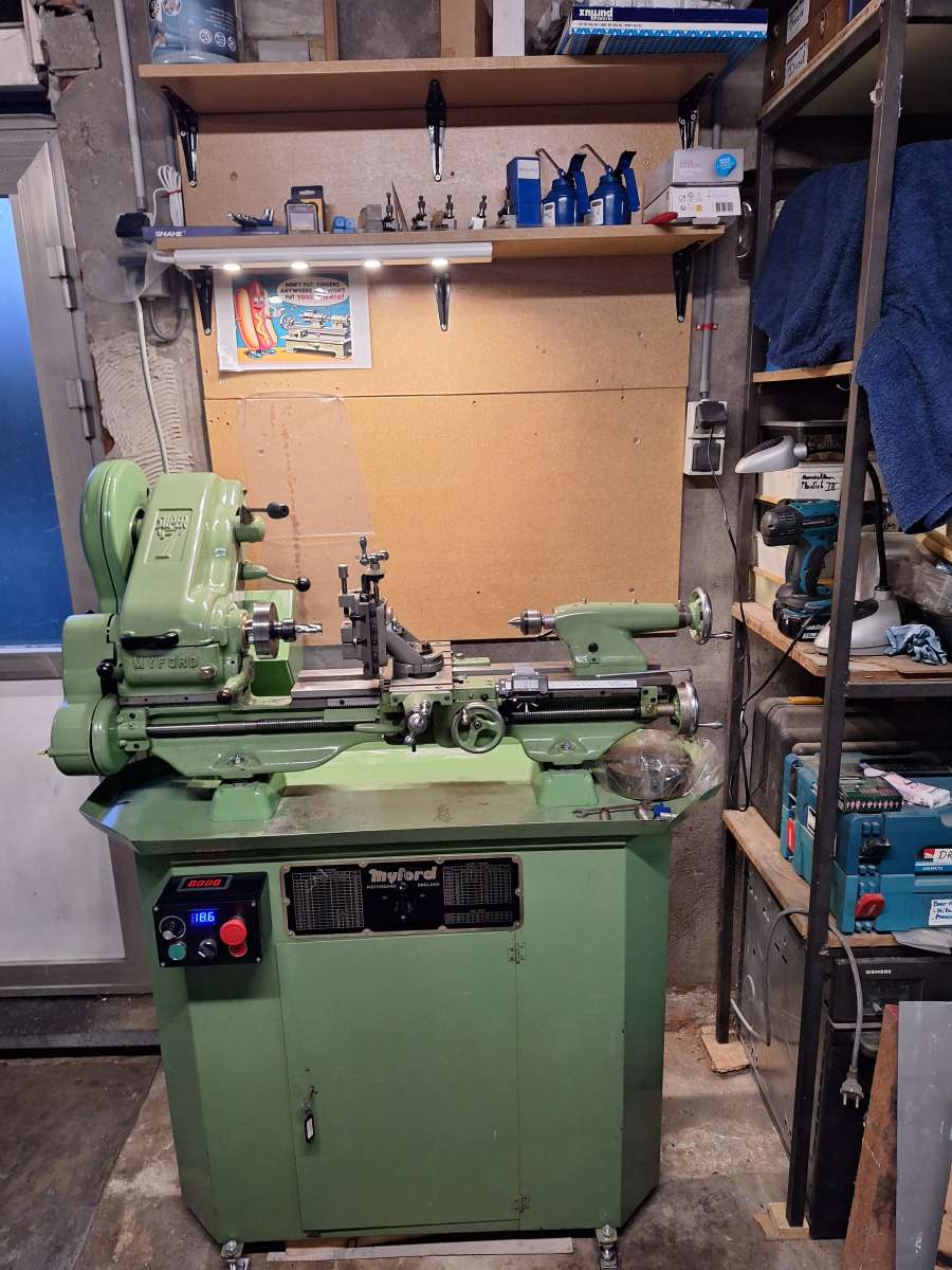

                                                    davp1971
                                                      @davp1971
                                                      Here is the Super 7. Ready to go. I am so glad I bought this. Should have bought the Myford a long time ago. I have done a few milling operations. Very smooth.20250414_204417
