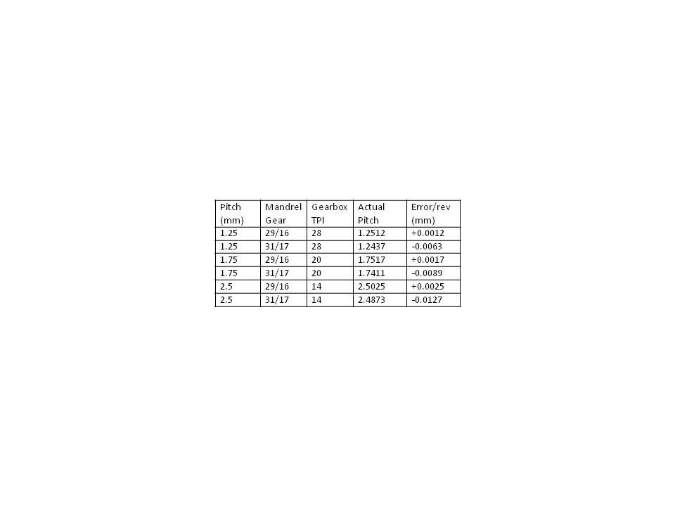

          Hello Simon,
          I ran a few calculations this afternoon based on a combo of 17/31 instead of your 16/29.
          The results were rather disappointing and erred unacceptably on the low side so I suggest you stick with what you have worked out
          I think the reason is that the error moves to the minus side of the equation for 16/29 which is 0.5517
          whereas 17/31 = 0.5484.The 'true' value is of course 16.5/30 which is 0.55 but now the error in minus has more influence hence giving low results. Check it out yourself, I think you will find I am right. I also now have a full table of ratios for the gearbox that you and Jester both have which might be useful to you. I can't send it by PM, my server screws all those attempts up but I can of course by email

            #438928
            Simon Williams 3
              @simonwilliams3
              Brian, Jesper, good evening
              I've spent a happy few moments with my trusty calculator and come up with the followingpresentation1.jpg
              Sorry it's a bit small, I've had all sorts of fun and games converting a table in Word into a format the forum can accept.
              Obviously my table only shows the pitches where the 29/16 or 31/17 gear is relevant. The error figure in the last column is the pitch error in mm per revolution compared with the nominal "correct" number. Of course we're quibbling about microns here, and arguably the limiting factor is the wear in the lead screw and halfnuts. But that just explains why the traditional 127 tooth gear isn't necessary.
              Using a 31/17 gear consistently gives a greater error than the 29/16 gear I chose. I can't take the credit for that as I didn't do the analysis at the time, though it looks like we came to the right conclusion nevertheless.
              Best rgds, let's post this and see if it's legible!
              Simon

              #438979
              Brian Wood
                @brianwood45127
                Hello Simon,
                When I look back at the calculations for the tables in my book, the pitch values that come from the gearing using a 33 tooth input mandrel gear are on the minus side of "true value"
                OK the error is only microns so who cares, they are really quite good enough for most work but that does explain why the 17/31 combination I suggested as an experiment was worse than anticipated by compounding another negative error with an existing one.
                Over several turns of a screw into a long nut for example, the accumulated error could result in thread locking. Not a very likely problem I will admit but if there is a better solution, such as 26/29, why bother?
                I have sent a copy of the gearbox ratio table to Jesper and will happily do the same for you
                As before, this has been an interesting exercise; I wonder how many others owning one of the early gearboxes will have found it useful
                Best wishes Brian
