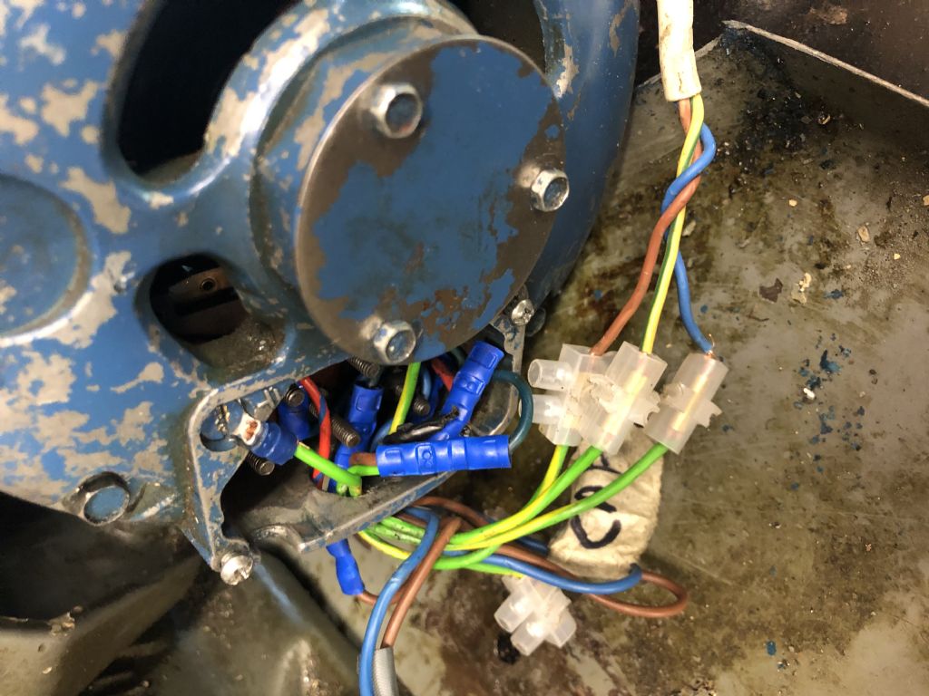

      Hi. I am a newbie with no lathe experience at all although I do have a fair amount of aircraft engineering time under my belt.
      I have just picked up a Myford Super 7 lathe which was all working fine when I bought it. I am so excited but now it’s installed in my workshop it won’t switch on. It trips the house rcd as soon as forward or reverse is selected on the Dewhurst switch. I have cleaned and rewired the Dewhurst but no improvement. Everything else in the workshop works fine with no trips.
      Any suggestions to fix this?
      cheers
      Nick

          Does it trip ‘as you select the dewhurst position’ or if the dewhurst is in forward or reverse when the machine is switched on at the mains? If only the former, it seems that there may be a make-before-break occuring within the dewhurst or leakage to earth as it is changed over?
          Most Dewhurst switches are just that – for change-over – not as a starter. They are (mostly?) not rated for starting duties. A dedicated starter should be incorporated in the supply to the motor.
          #516914
            The RCD is detecting an earth leak, ie somewhere along the wires, switch, or in the motor, live electricity is dribbling enough current through the insulation to signal an electrical fault.
            Old-fashioned fuses are far too insensitive to react to small earth leaks so it's possible the lathe ran OK in it's previous home and would be happy in your workshop too if you had a pre-RCD consumer unit. But earth leaks are at least a little dangerous – if the earth fails, as they do, the lathe becomes a shock hazard.
            Although the Dewhurst is suspect, and should be operated as NDIY describes, never used to power the lathe on and off because that damages the contacts, it's probably innocent here. (By modern electrical standards Dewhurst's aren't a good design.)
            First step is to carefully inspect all the wiring for damage. Although a well maintained Myford made in 1947 could be mechanically excellent, the same can't be said of ancient electrics. Rubber insulation perishes and over the years physical damage due to vibration or cables being trod on or pulled etc. If the wiring is rubber or looks in any way tired, replace it. Damaged switches are a possibility, but more likely candidates are:
            • Suppressor capacitors – if fitted. These can be removed without effecting electrical safety; if disconnecting them lets the lathe run without popping the RCD, replace them. The lathe can be used while they're in the post.
            • The motor. More complicated, possibly as simple as drying out damp windings, but… The exact type of motor fitted will need to be identified. Can you post a photo so a motor expert can advise?
            Don't panic – in the event of very bad news Myford electrics and motors are easily replaced. Could even be a good opportunity to modernise the machine with a 3-phase motor and VFD. (Note how happy I am to spend your money!)

              Do you have access to any kind of test meter? While an insulation tester "megger" is required to do a proper test, a multimeter on resistance will show any gross faults.
              With the lathe unplugged but swtitches set to run and the meter set to it's highest resisance range check the resisance between tha earth pin and both live and neutal pins connected together. Any reading less than 1 megaohm is cause for concern.
              Robert G8RPI.

                  Don't forget that a neutral to earth fault will trip an RCD just as much as a live to earth fault. it's worth checking that the neutral and earth are not connected together.

                    Its worth remembering that the RCD is probably looking for 30ma of earth fault current, but this can be a cumulative 30ma. As an experiment try switching off all of the other breakers in the distribution board and then try the lathe. If it trips the RCD then the lathe is probably faulty. If it runs then add the circuit breakers back in one at a time until it trips. This may show that something else is causing the problem. The usual culprits are heating elements (kettles, electric cookers, water heaters etc).
                    To add to the complication it may be a neutral to earth fault that is causing the problem so you may have to disconnect ie unplug or switch off items to find the source of the earth fault.

                      The test I suggested, resistance between Earth pin and Live and Neutral tied together will detect both live and neutral faults.

                        ‘Fraid I disagree with SOD (yet again!🙂 ). I think the first step is to check as I suggested. If the motor starts snd runs without the RCD tripping that would exclude leakage from the motor or other wiring – even if the insulation is rubber and ancient.

                          I had a similar fault develop on the ML7 after turning a lot of cast iron. It has the I assume original Brook Compton motor with air vents and it sucked in a load of cast iron dust which accumulated in the terminal box. Opened it up, blew it out, problem solved.
                          Paul.

                                  You could dissconnect the motor connections and then try the on off switches. While the motor is disconnected, use a multimeter to see if there is any leakage. This is only useful if there is a very large fault. Some lathe motors are in a position where they can ingest particles of swarf if there is air flow through the motor. A 1/2hp replacement motor is not too expensive new.

                                    Is everything else in the workshop on the same circuit as the lathe? If the lathe is on a dedicated circuit, it is possible that the neutral for this has been wrongly connected in a split load consumer unit in the house (if that is what you have – if the neutral from an RCD protected circuit is connected to the non-rcd neutral busbar the circuit will appear to test OK, but the RCD will trip when a load is connected.).

                                      Nick, You could prove this by connecting a lamp or some other load to the lathe circuit. If that trips the RCD it probably proves Andy's theory. Tracing neutrals in a consumer unit can be difficult if it is fully populated.
