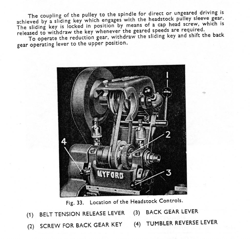

              Hi there, Jae,
              Have a look at the large gear-wheel attached to the mandrel (aka spindle or shaft). On the right-hand side there's an allen screw with a hexagon socket head. On the left-hand side, there's a segment of gear teeth held by the other end of that screw.
              Slacken the screw and slide the toothy bit down into engagement with the smaller gear on the end of the pulley cone, thenm tighten the screw. (You might need to grind a bit of the allen key so it'll fit between the screw head and the headstock casting.)
              That should cure your problem.
              To engage the back-gear to get the set of slower speeds, dis-engage the toothy bit and lock it in the dis-engaged position, then raise the back-gear lever to mesh the back-gears.
              Have a practice with the motor off before you try it for real.

                You have 1/2 engaged the Back Gear.
                Cog Behind the chuck has either a lever or a screw ( allen key ) you need to tighten​

                  To confirm what Swarf,Mostly! has said, here is the relevant section from the ML7 user handbook

                    The aluminium pulley should be an interference fit on the small brass or bronze gear. Yours has come adrift which is not an uncommon occurrence. I suggest you strip it all down, clean the pulley bore and the gear and fix the gear in position with Loctite retaining compound.. Or buy a replacement pulley assembly from Myford.

                        Agreed. It is clear that the pulley is slipping on the bronze sleeve. Loctite as suggested above is the fix.

                              thanks for the answers chaps……….when i went out to use the machine this morning the problem was gone………then once it got hot it started sliping again………..ive had 2 answers which both make sense here………
                              one says that the pulleys are an interferance fit and are just plain slipping, this makes sense as they are ali and will expand more than the shaft which is steel…..this is why they might slip when it gets hot…………………
                              also someone has said that the back gear is half way engaged which would also make sense
                              im going to investigate both senarios on monday firstly trying to fiddle with the backgear on the bullwheel
                              if that doesnt work then it looks like it could be the interferance fit has had its day……
                              if this is the case would i be making a real mess of things if i just drill and tap one of the pulleys then tighten them down to the shaft with a 5mm grub screw…????
