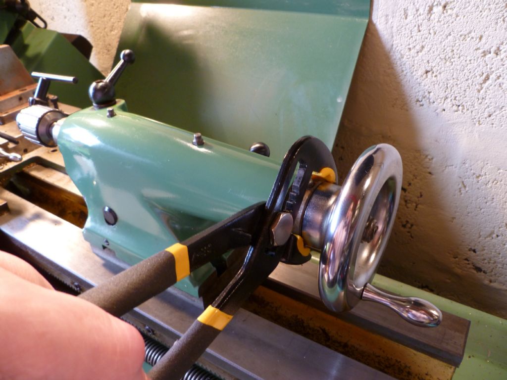

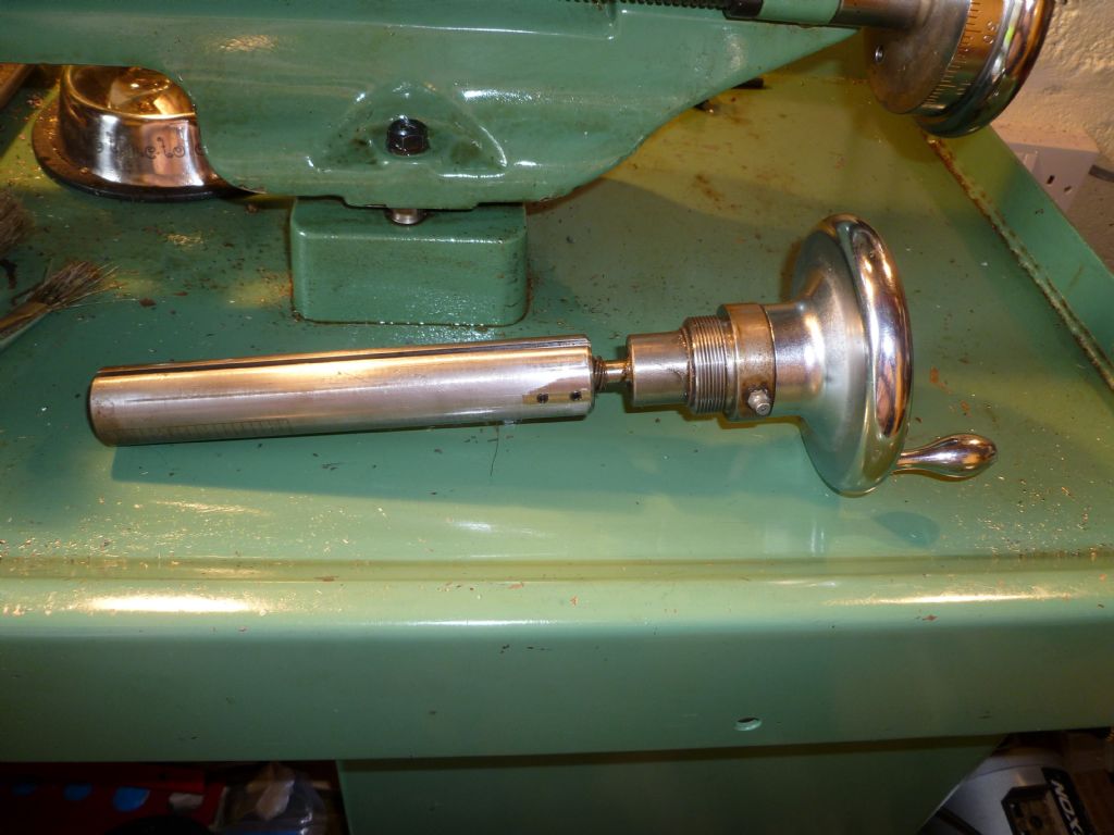

      Hi
      I'm trying to dismantle the tailstock from my ML7R. There's a turned steel component fixed into the back (right hand end) of the main casting – it has an oil nipple and a 1/4" hole in it. Myford call it a 'cap' in their diagram.
      It must be secured somehow, because it takes the thrust loads, but I'm being dense and I can't see what's holding it in place. There's a photo of it in GH Thomas' MEWM (photo 97) which seem to show two grooves.
      Can anyone give me a clue?
      Cheers

        Trying to remove the ‘cap’
        #106030
        David Clark 13
          @davidclark13
          Hi There
          I did mine like this.
          and this is the result
          regards David

                    Thanks David – that's what I needed to see. Stone me! It was on pretty damn tight, but I rummaged out a C spanner and a 2' tube that fit over the handle. That shifted it.
                    Cheers
