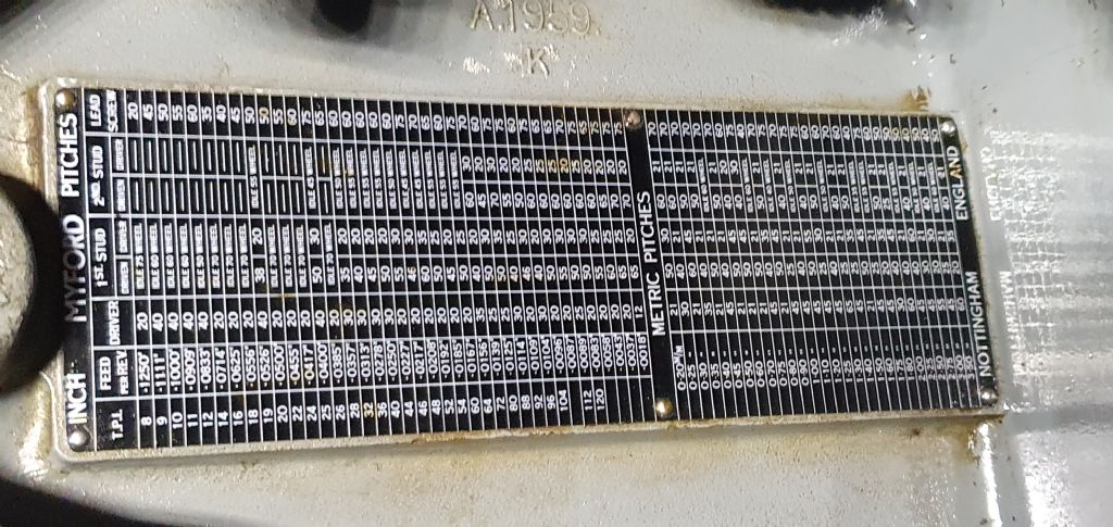

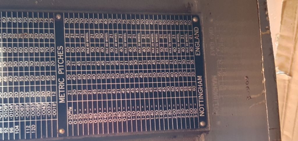

      Hi guys, I've lurked on this forum for some time and finally joined, seeing I recently acquired a metric Myford Super 7.
      I've many questions about these lathes. Firstly I was wondering what kind of leadscrew I have, seeing the tables look quite different to pictures I've seen online?
      I'm after 1.5mm on this table
      Zoomed out
      Sorry the pics aren't orientated correctly they look fine on my phone.

        #626261
        Roderick Jenkins
          @roderickjenkins93242
          Myford used the same 8 tpi leadscrew on both imperial and metric lathes, only the cross and topslide screws are metric pitch on the metric version. Myford's screw cutting chart is therefore the same for both the imperial and metric lathes. The metric pitches are not precise in the mathematical sense but are very close approximations, way beyond the accuracy that the machine is capable of.
          Rod
          #626289
          noel shelley
            @noelshelley55608
            The chart tells you what change wheel train to set up and you will need a 21T which may not be in a standard set but is available. Noel.
            #626291
            Hopper
              @hopper
              Is it a metric Super 7, or just an Imperial Super 7 with a metric screwcutting chart? Seems odd for a metric lathe to list imperial threads first, metric second.
              Are the cross slide and top slide collars graduated in metric or imperial?
              #626303
              Mike Poole
                @mikepoole82104
                The metric pitches on the chart are extremely close approximations for a metric pitch, there never has been a Super 7 with a metric leadscrew . Don’t worry about the threads being approximations, unless you have high end metrology equipment you will not measure the error. For most practical purposes it will be satisfactory. The only way to cut a true metric thread is to use a 127 tooth gear in the gear train. 5 inches is exactly 127mm which is where the conversion comes from. Using the metric setups in the table will mean not disengaging the half nuts and reversing the lathe to start the next cut. There are other methods but not disengaging keeps it simple. Plenty has been written on screwcutting both online and in print.

                #626325
                Howard Lewis
                  @howardlewis46836
                  You can always check the pitch of the Leadscrew, by measuring the travel for ten turns of the Leadscrew.
                  If it is an 8 tpi Imperial, the travel will be 1.25 inches (31.75 mm).
                  If it is Metric Leadscxrew, the travel will be ten times the pitch, (So 15, 20 or 30 mm, as examples )

                    #626526
                      The 20 driver and 20 leadscrew with idlers between giving a 0.125" pitch is a good indication of it being an imperial 8tpi leadscrew. as that is a 1:1 gear train
                      Any of the common metric leadscrew pitches need a far more complex gear train so not likely to be a metric leadscrew.

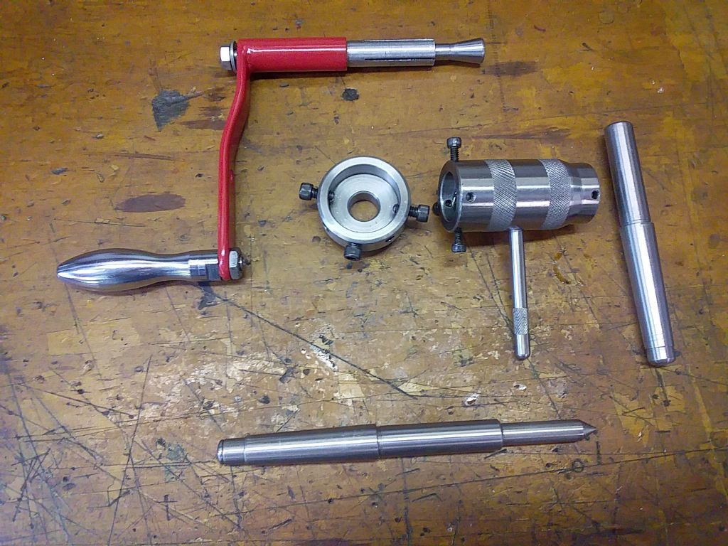

                                  That's a clever little trick and a good way of doing it if you are machining up to a shoulder. Othewise, it is just as easy to wind the tool out a turn and hit the stop switch then reverse switch without disengaging the half nuts.
                                  If you don't have reversing on your lathe motor, a hand crank in the spindle is very good for most hobby screwcutting jobs. They are usually short and you want to go slowly anyhow. Easy enough to make a hand crank that slides inside the far end of the spindle and grips via a tapered plug on the the end of a bolt that expands the split end, like a concrete anchor bolt in principal. Also a fantastic aid when cutting threads with a tap or die. Soooo much easier than wrestling the chuck or the tap handle etc. I love mine. Best thing since sliced bread. Along with the resettable cross and top slide dials it is the best accessory I have made for my lathe. The shown tailstock die and tap holders are gold too.

                                      #626604
                                      Howard Lewis
                                        @howardlewis46836
                                        +1 for Hopper's Mandrel Handle, and Sliding Tailstock Die and tap holders.
                                        The time to make them is well spent
                                        They save a lot of broken tools when taking a thread upto a shoulder or into a blind hole.
