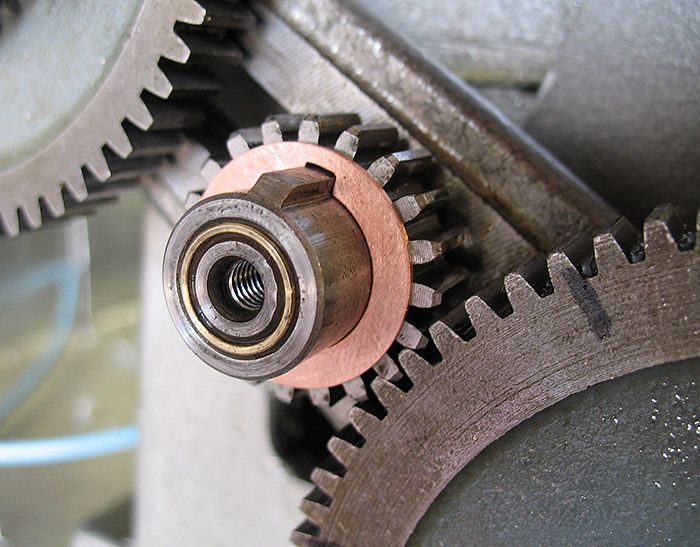

      There is a small amount of gear 'float' on the quadrant of my little Myford ML10. It functions just fine, but the sound of the gear teeth occasionally brushing against one another in operation was something I never liked. So I finally got around to fixing the problem.
      Using a set of feeler gauges I determined that when a pair of gears are mounted on either of the quadrant axles there is something like 0.8 – 1.0 mm of free space between them. I then found some scrap copper and machined up a pair of spacers to take up most of this space and prevent the gears from floating sideways on this axle against one another and thus (sometimes) rubbing against some of the other gears in the cluster when in operation.

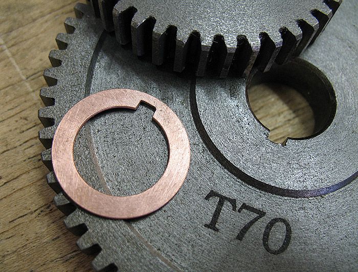

      The spacers are nothing special; just some 0.7 mm thick copper sheet, though they could just as well be made from brass, tin, aluminum or steel since they are not subject to wear. The inner bore is 16 mm and the outer diameter 23 mm.
      Mounted between the gears, these spacers prevent any unwanted side-to-side gear noise. The photos below tell the rest of the story.

                            @ega – Didn't have a punch and die. I produced the spacers as follows:
                            I clamped two oversized squares of 0.7 mm copper sheet between some small off-cuts of hardwood on my tiny mill, then drilled progressively larger diameter holes through the clamped stack – up to a 13mm drill – finally ending up with a 16 mm 4-flute end mill.
                            Following that, I roughly nibbled away the excess copper sheet with a shear so as to convert the squares to something approximating round.
                            Turned up a simple shouldered aluminum mandrel with a 16mm center form onto which the bored out copper sheets were mounted, secured by a hollow aluminum collar piece held in place by pressure from a live center in the tailstock. The spacer blanks thus sandwiched under pressure, I could take very light cuts with a sharp HSS bit to turn that clean exterior diameter.
                            The slot in each spacer was cut using a jewelers frame saw with an ultra fine blade under tension (the kind that snaps if you look at it wrong) after which I used some small pattern maker's files for the final fit up. Nothing perfect here, but fit for purpose.
                            The credit for this technique to bore and pressure turn the spacers goes to Joe Pieczynski . Check out his video on Youtube.
                            Machining ultra thin shaft spacers

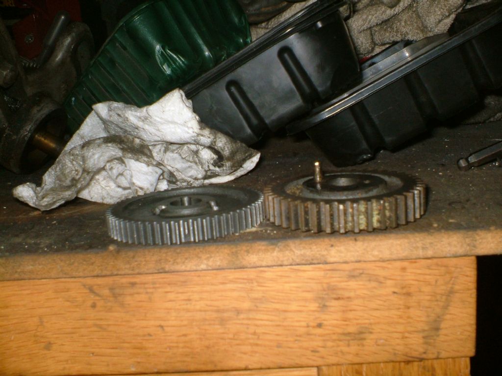

                                    Hi Ignatz, very neat looking spacers. The technique for stacking and boring and subsequent outer turning is by no means a new idea, I've done it at times during my working years, albeit in a less precision way with 1 to 3mm steel, by stacking between thicker plates and all clamped up in a vice and then a couple of welds from one thick plate to the other on two opposite sides, a suitable size hole then drilled through and then mounted on a piece of threaded rod with a piece of shim if needed to keep them central and the outside turned to size. Made some small brass washers a while back in a similar way, although I drilled the holes before cutting the squares out of a piece of 1.7mm brass sheet, the holes and outer diameter not needing to be precise.
