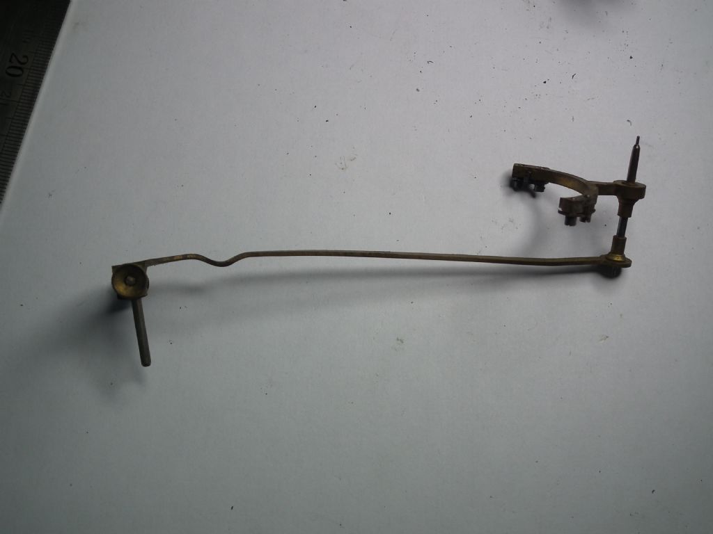

                        EDIT: Your reply appeared just as I posted this ! I wouldn't attempt to disturb the collet.
                        Roy is correct, but if you're not clear on what he means this might help:-
                        The crutch is that piece which those index fingers are pressing !
                        The picture is trying to show what you need to do. That is, bend the vertical rod little by little until with the clock horizontal your pendulum hangs vertically. Hopefully then the clock will still be in beat.
                        If it now refuses to run, you may need to loosen the 2(?) screws on the back plate which support the pendulum spring pillars. The holes through which they fit should be large enough to permit slight rotation of the pendulum supports. Doing so will alter the escapement.
                        Again, and assuming your clock has this facility, you'll have to progress slowly by trial and error until the clock is in beat. If you're still unsure, post a picture of the pendulum support.
                        Although fitting new taper pins is worthwhile you may find the female tapers are far from good in an old clock and new pins may not seat firmly. (That's why I wrote "the taper pins need to go back in their original holes".
                        In the absence of a correct taper pin reamer, (which you couldn't use anyway without removing the backplate) just give the new pins a "more gentle" tap in.
                        Edited By Fowlers Fury on 30/01/2018 22:39:51

                          Brian All respect to Fowlers Fury but I would gently twist the collet on the arbour
                          Roy
                          #339165
                          Russell Eberhardt
                            @russelleberhardt48058
                            If you're going to adjust it by bending the crutch, just make sure it doesn't end up like this !!
                            Russell

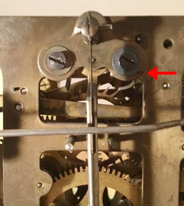

                            Fowlers Fury
                              @fowlersfury
                              Russell ~ your pic reminds me of the mangled crutch on an old English longcase I restored. The badly bent brass was so brittle it fractured face 8 hopefully that wouldn't happen with Brian's clock.
                              Brian ~ looking in your 'album' I now see there's an image of the pendulum support.
                              I've "levelled" the top edge of the backplate with Photoshop and can see the pendulum was not vertical and the pallets seem wrong.
                              Also it appears (with the arrow) that the aforementioned suspension spring support has been previously moved, evidenced perhaps by the screw on the left being ….err…mistreated.
                              Revised thinking is that you first try slackening those 2 screws and adjusting the plate before trying to modify the crutch or disturbing the collet.
                              It may be that easy.
                              Edited By Fowlers Fury on 31/01/2018 11:06:28
                              #339188
                              Bodger Brian
                                @bodgerbrian
                                I hasten to say that the mangled screws are not my doing! There are number of others in the same state which indicate that it has been 'got at' previously.
                                I did wonder about slackening the screws & adjusting that way but I was worried that doing so would upset the relationship between the pallets & the escape wheel (is that the right term?). Although the pendulum is off centre, the clock is running.What appears to be wrong with the pallets? Would the fact that they are wrong be accounted for by a previous adjustment of the support?
                                Brian

                                #339195
                                Fowlers Fury
                                  @fowlersfury
                                  Brian,
                                  "Slackening the screws and adjusting…." is to achieve that relationship between the escape wheel teeth and pallets.
                                  It could be there are parallax errors but looking at your image I reproduced, the split rod holding the suspension spring appears to be canted over to the left i.e. anticlockwise. That is causing the spring to be bent very slightly as it emerges. Instead, the suspension spring should be perfectly straight.
                                  In the rest position the pallets should have one pallet holding back one tooth of the escapement wheel. In your picture there is the appearance of one pallet resting on top of a tooth. Again it might be due to the camera angle but if not, that must be corrected. Accordingly I think that if you slackened the 2 screws and turned the bracket slightly to the right (of the image) you should both correct the spring's slight bend and get the pallets engaging correctly.
                                  Image result for clock escapements
