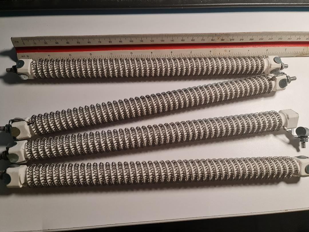

                            I was thinking a lot about what resistors to use. I would like to avoid mounting them in the wall. So ideally must be some self supporting type. I found some MoSi2 Heating Elements.
                            The nice thing is that only two holes are required. The active part the is the smaller diameter. But they came with serious issues. They have very large variation of resistance with temperature. They require low voltage at the beginning. And are expensive. Even on Aliexpress a 2kW one can jump above 200$.
                            Then there are SiC heaters. Again, very easy to mount. And are much cheaper and available locally in many shops. But they have ridiculously low resistance, I’ll need a transformer. And can’t be connected in series because the resistance is changing a lot during lifetime. I think the only advantage of SiC and MoSi2 is the much higher working temperature, up to 1800ºC
                            In the end I think I’ll just buy some 400W Ni80Cr20 ceramic elements. The cost is ridiculous, 1.5euro each!!! I suppose they will die quickly.  I could rewind them with kanthal wire. Or simply buy more 🙂

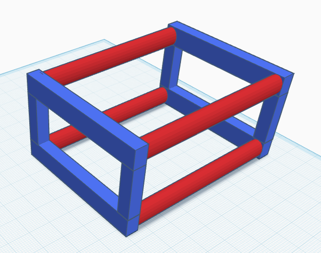

                                How soft is the steel heated at 1000°C ?  I bought 4 x 500W ceramic resistors and I’m thinking to make a steel frame to hold them in place.
                                The blue parts will be made from welded 10x10mm square bars (structural steel). And I’ll add 4 x 5mm threaded rods through each resistor to keep everything together. The high temperature steel creep could be an issue?
                                Also if I’ll connect the wires of the four resistors with screws can I expect any surprises? Maybe some serious oxidation? Should I use some stainless screws?

                                  I think you want the electrical connection outside the furnace 🙁
                                  I guess steel will wilt a bit at that temp but my guess is that oxidisation will be a bigger problem – it will turn to scale over time.
                                  In my large oil drum oven, I made a grill/shelf out of welded rebar. The rebar did wilt a bit and eventually some welds failed. But not really an issue.

                                      #770028
                                        Afraid I don’t like idea of a steel frame inside the furnace supporting the elements!   Five reasons:
                                        1. A metal frame is unnecessary.
                                        2. A heavy steel frame will absorb heat, wasting valuable watts that should be cooking the charge.  The furnace will take longer to get up to temperature and cost more to run than it should.
                                        3. Depending on the alloy, mild-steel melts at between 1200 and 1500°C.   That’s uncomfortably close to the furnace’s top-temperature of 1000°C.   The metal will certainly soften, and although Sonic’s design looks suitably stiff, it’s likely to sag under it’s own weight, or allow the heater fixings to pull out.
                                        4. Cycling the steel from room temperature up to 1000°C will mechanically stress the frame due to thermal expansions and contractions.  I’d expect the frame to distort over time.
                                        5. Steel heated to 1000°C will corrode!   Not dramatically, but…
                                        Supporting the electric elements between insulating firebricks solves all these problems.  A kiln I looked at a few years ago had fluffy fibre insulation inside around which was spiralled a Nichrome wire.   The wire was held in place with short loops of Nichrome anchored in the fluff by bending them.  Very simple, extremely lightweight, and easy to repair.

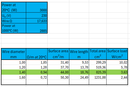

                                          I made some calculations to find out what diameter to use (for Kanthal A1 wire). In my understanding the important criteria is the resistor surface load. So I made a spreadsheet to find out the surface load for different diameters given a desired power.
                                          As you can see bellow (c) the maximum surface load for Kanthal A1 at 1000°C is 4W/cm². So the sweet spot for wire diameter is 1.4mm. Larger diameters are better but also the wire length is increased. Surface load varies also a little with the way the wire is mounted. But I’ll pretend I didn’t knew about this.
                                          Yes, I dropped the idea to add steel inside the furnace to support the resistors. I found a way to support the ceramic rods using only the calcium silicate walls.

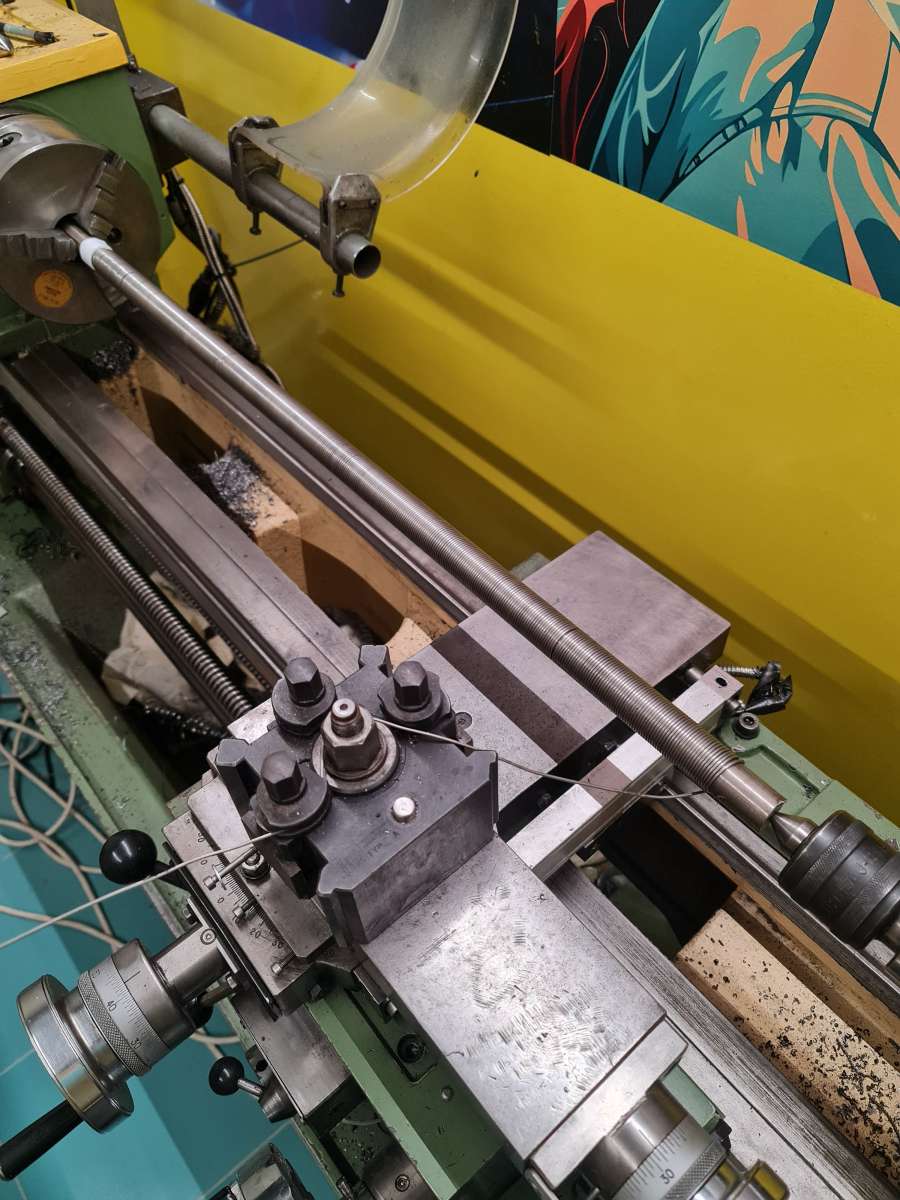

                                            Today I used the lathe to make a coil from the 1.5mm kanthal wire. I don’t know how else to do it. It is very stiff.
                                            I spread the wire across the garrage, living room an kitchen, almost 30m. There were wire loops everywhere. When the last meters of wire reached the lathe they collected some shoes and other stuff 🙂
                                            One strange thing happened. While coiling the wire ar some 40-50rpm the 30mA house RCCB turned off the power! I thought the moving wire coils touched something in the living room. Maybe I have something that is not grounded and has damaged insulation, but I couldn’t find what. The lathe is not grounded (yes, I know) and has it’s own 10mA RCCB. Weird.
