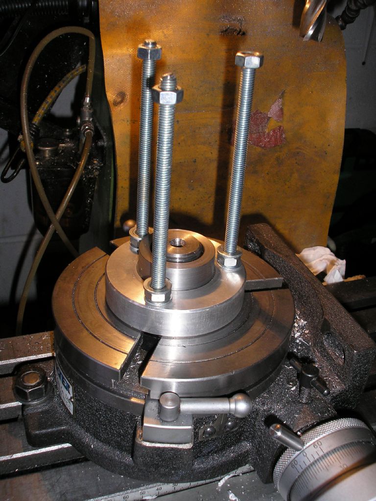

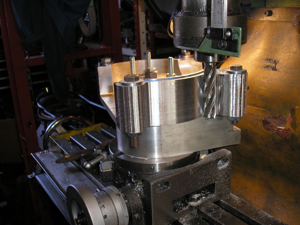

      A bit of my whittling today a lot more to do

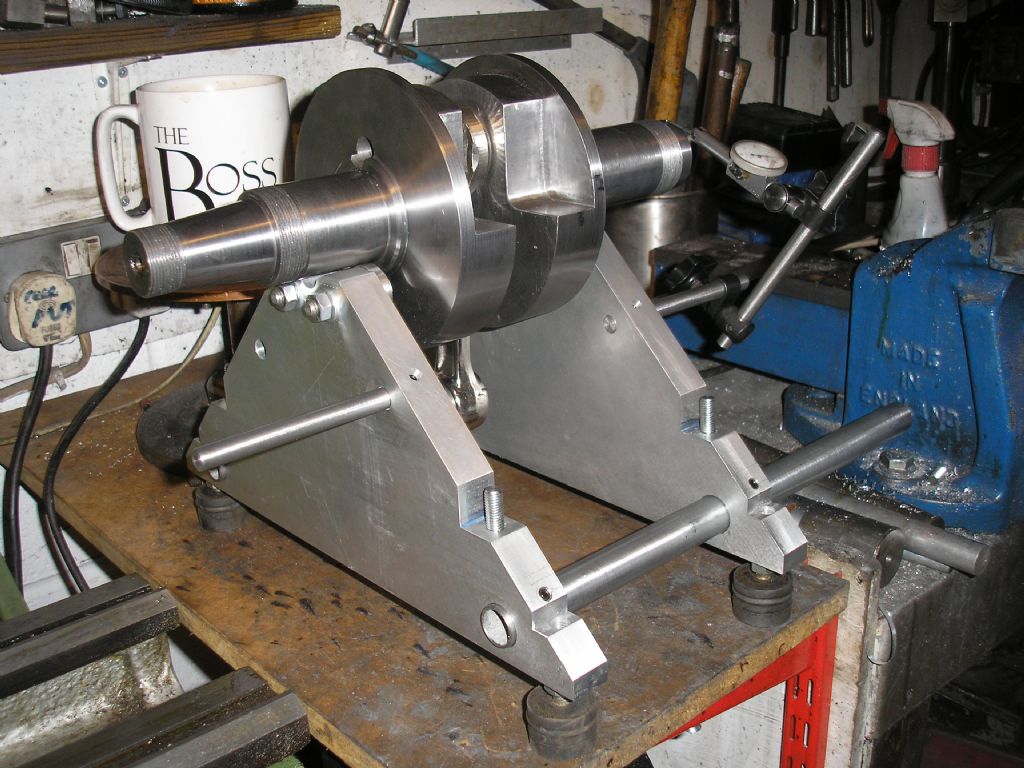

          Myself finished last night my crankshaft aligning with detachable straight edges for balancing jig.
          The base feet and straight edges can be adjusted for levelling.
          Apart for £2 for shims everything else was from my spares box the 20mm ally was donated by another speed enthusiast.
          Crankshaft aligner and  balancing
          Crank aligner

              Lovely work Windy, please show and tell us more about it.

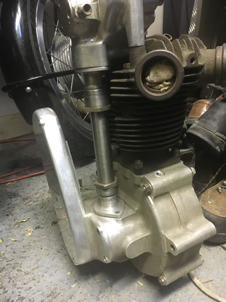

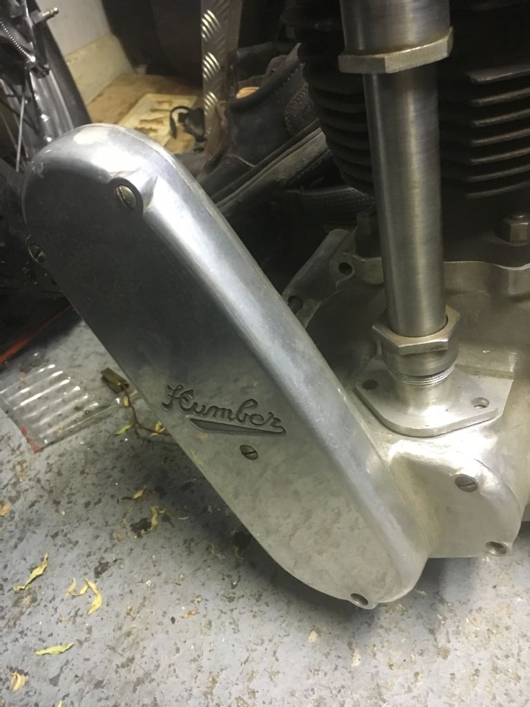

                I made the crank cases, inner and outer ignition timing chain cover for this 350cc OHC engine from solid on a small round column Axminster mill a few years back.

                  Lovely work Bob, for next weeks project, you can whip yourself up a manx norton engine.

                    Amazing what can be done Bob in a home workshop

                      The crankshaft aligner or the crank on it.

                        Hi Windy,
                        within reason I don't think there is much that cannot be made with simple machinery in the home workshop. It takes time and as you will know you have to plan the sequence of operations otherwise you can engineer yourself into a corner you can't get out of.
                        I have got CNC capability now which is fantastic for generating complex shapes. I have just started a restoration of two Humber 350cc Motorcycles, an OHV and an OHC. Hopefully I will get one finished next year.

                          Very nice.
                          I presume alignment is on the top portion with the knife edges, and the balancing done below on the 2 pairs of brgs?
                          Many years ago, we did static balancing on our knife edges too.
                          Bob R – lovely work on the pre unit single.

                            The bearings are mainly for aligning the pressed up crankshaft similar to a Alpha-Tru aligner the straight edges for balancing.
                            alpha tru

                                  So having found that it is out of true what do you do? Just hit it with a lead hammer, or do you scotch one side with a block to prevent it rotating?
                                  This is probably becoming a lost art as Japanese bikes seem to last forever (I will now go and wash my mouth out)

                                      Have seen video of one repairer having a stout upright fixed steel bar with probably a lead block on top just banging the offset flywheel on it a recommended way in some books.

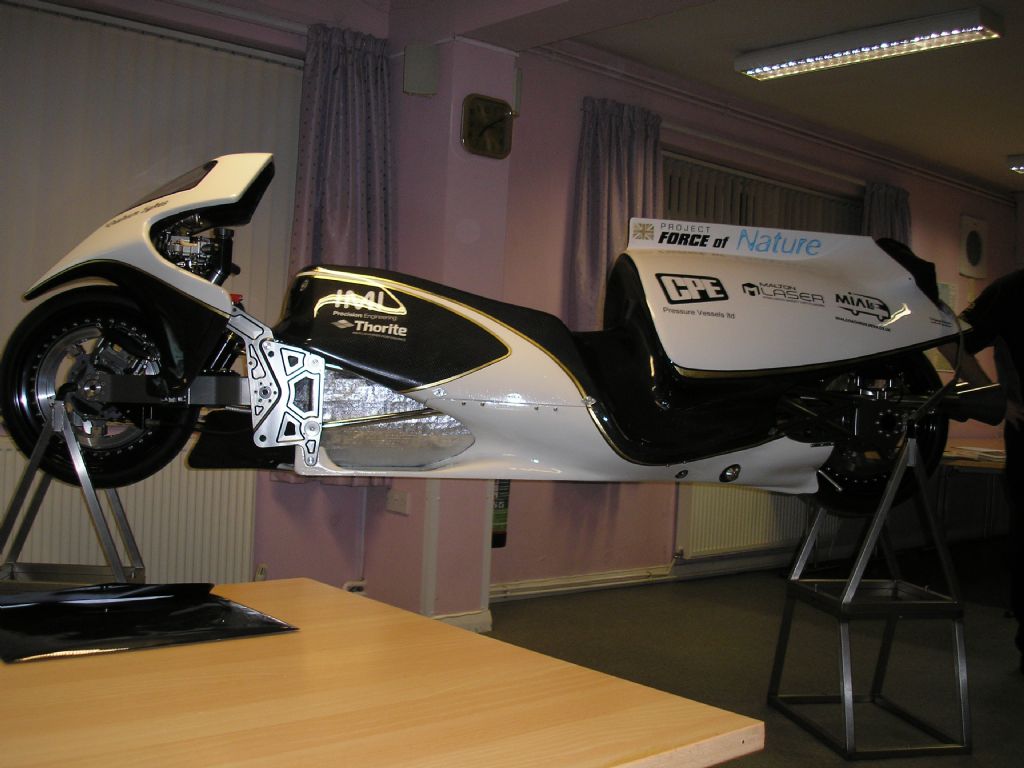

                                                    It was PEEMS first club meeting of 2019 and what a treat for speed enthusiast members.
                                                    This small club was packed with members and guests many from the speed scene for my friend Graham Sykes Steam Rocket Bike talk.
                                                    Grahams Wife has a wealth of knowledge on this creation and was also involved in making the pressure vessel insulation blanket apart from other things.
                                                    Amongst the guest were previous talker Becci Ellis fastest women and others that have done fantastic speeds at Elvington, Pendine and other venues including the TT.
                                                    PEEMS has such a variation of interests that was the main reason why I joined years ago.
                                                    2019_Graham Sykes talk on force of nature rocket bike
