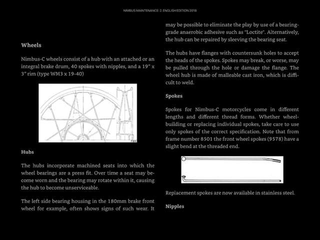

          This is a screen grab from the English translation of the nimbus maintenance manual

            Clearly a post-facto document, produced for the benefit of modern owners.
            It describes the situation well, but doesn’t explain the why.

              The document above posted by Ian Parkin references the ‘bent spokes’ being fitted from Frame No.8501, which would have been produced during 1949.   So, seemingly, only the last 11 years’ production would have ‘bent spokes’, the first 14 tears’ production, the majority of the production, would have had ‘straight spokes’?
              Perhaps the spoke-change is associated in some way with the ‘high fork’ introduced in 1948?
              Ah!  Found this on the Nimbus facebook group in response to an enquiry:
              ‘The plan was to reduce the radial pull on the brake drum, thereby reducing the amount of drum distortion. F&N were full of good and sensible ideas; this was not one of them.‘
              (F&N = Fisker and Nielsen)
              Note: facebook group seems to be ‘public’ so no need to be a facebook member, simply click the ‘cancelling x’ on the first ‘pop-up’ and you are in.

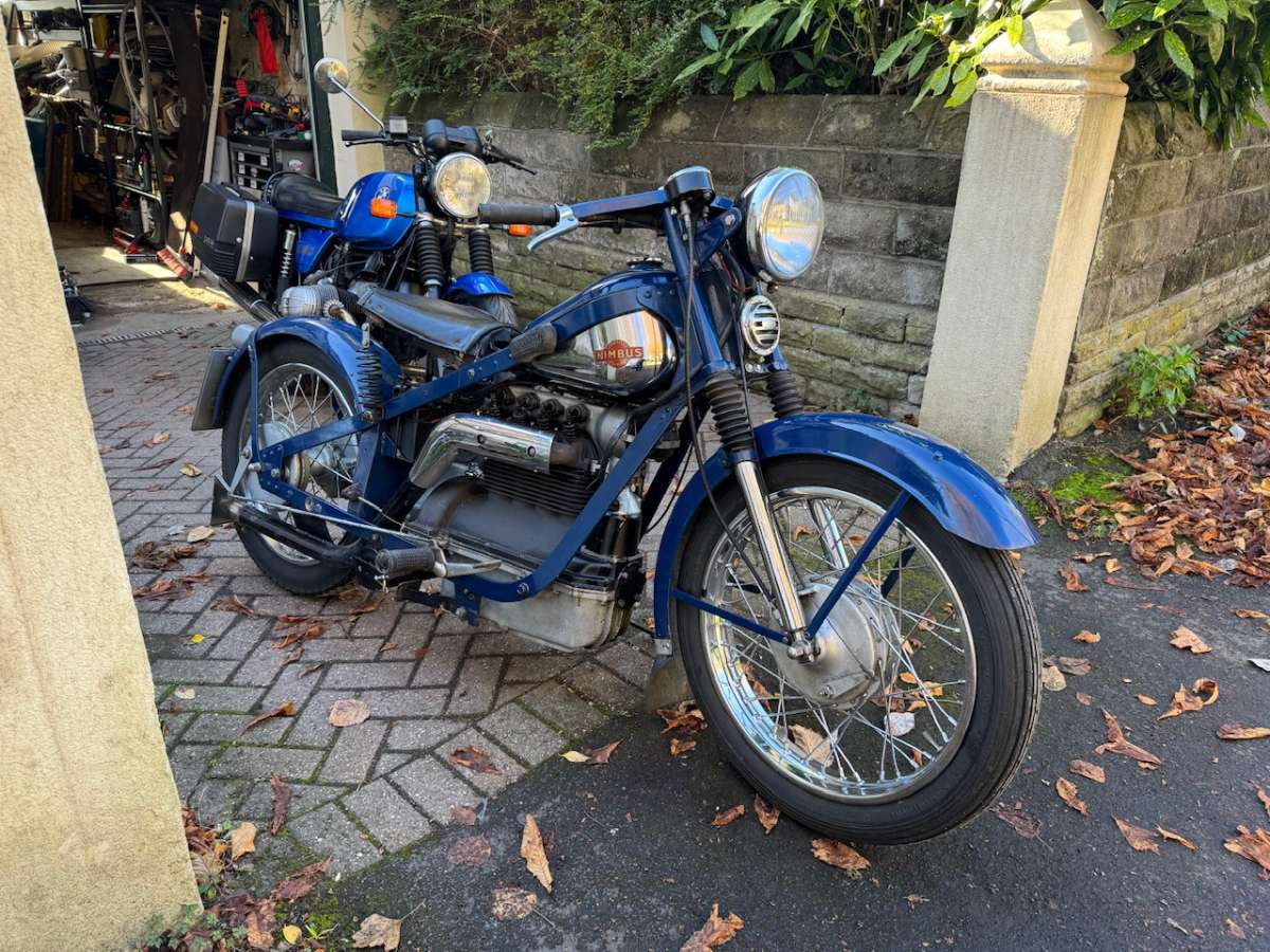

                  As an inline four, do your legs get ‘warm’ and how is cooling affected? Ariels Square four was a nightmare.

                    I have only had it a month or so so riding it at the moment its been cooler weather
                    this is a sport model (22 hp) so higher compression …the carb is tiny throat perhaps 20mm
                    i’ve not noticed the block getting too warm yet

                      The electrical system is quite good for the period
                      the crank has a bevel gear on the front end which drives the dynamo/generator which you can see at the front of the engine at the top of the generator there’s another bevel which drives the cam shaft
                      the ignition is all built into the distributor cap coils points etc
                      the light switch is nowhere to be seen….its on the left hand twist grip. …off ,side lights,dip head and main beam 4 positions in total
                      the ignition switch is built into this complicated switch which is on the dashboard along with charging light
                          That answers the bent spoke question.   I think it compromises the “strength” of the front wheel.   If the spokes are tensioned properly the brake drum can and most likely will be pulled out of round.  A good wheel builder will be able to minimise this but better still, machine the braking surface after building the wheel. (And machine the linings to fit the drum).
                          Going slightly off this topic.   As far as I know, Velocette was the only British factory to machine the braking surface after the wheel was built.  Triumph and BSA didn’t, their wheel builders took care to try and maintain roundness of the drum.  Norton were notorious for out of round drums after wheel building.
