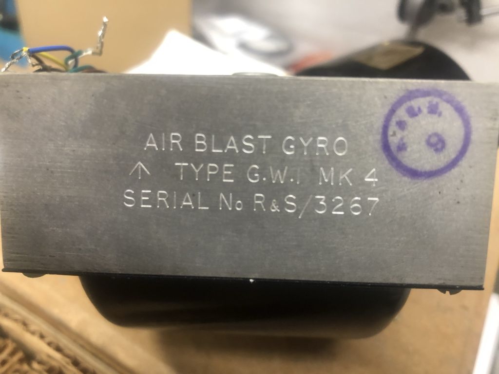

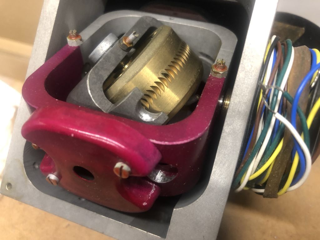

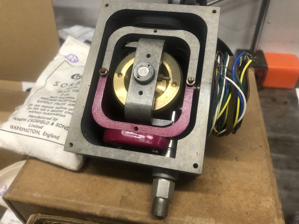

                      Peter Spink
                        @peterspink21088
                        Posted by duncan webster on 28/12/2020 23:42:00:
                        Absolutely not what you asked for, but how about half round teeth in the rotor periphery and an air jet? Turbine guy who writes in this forum should have some good suggestions
                        Like this?
                        I always assumed this was intended for a missile where the gyro would be spun up during the launch period and then the nozzle would retract when up to speed.
                        Goes at quite a rate on the compressor and spins for several minutes after nozzle pulled out.
