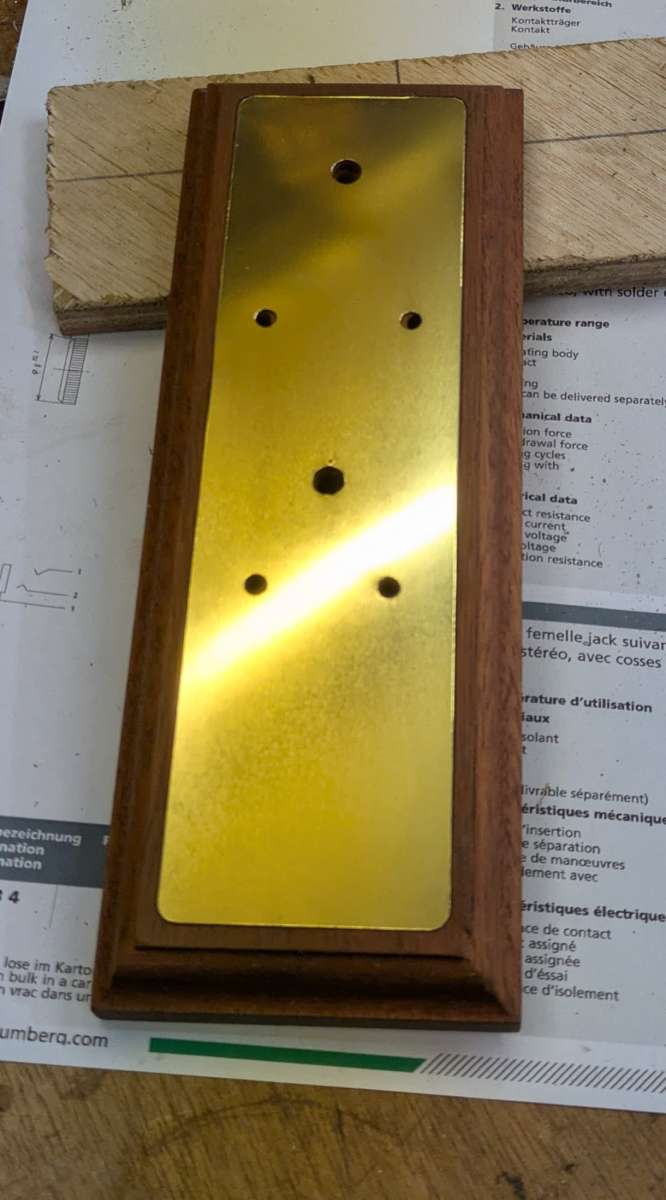

      Something a bit different.   I decided to design and build a morse key.   Just a basic straight key, nothing fancy, but with an objective of making something really good, both to use and to look at on the shelf.
      A lot yet to do, as ever and a few careless mistakes as always…but pretty pleased with progress so far.

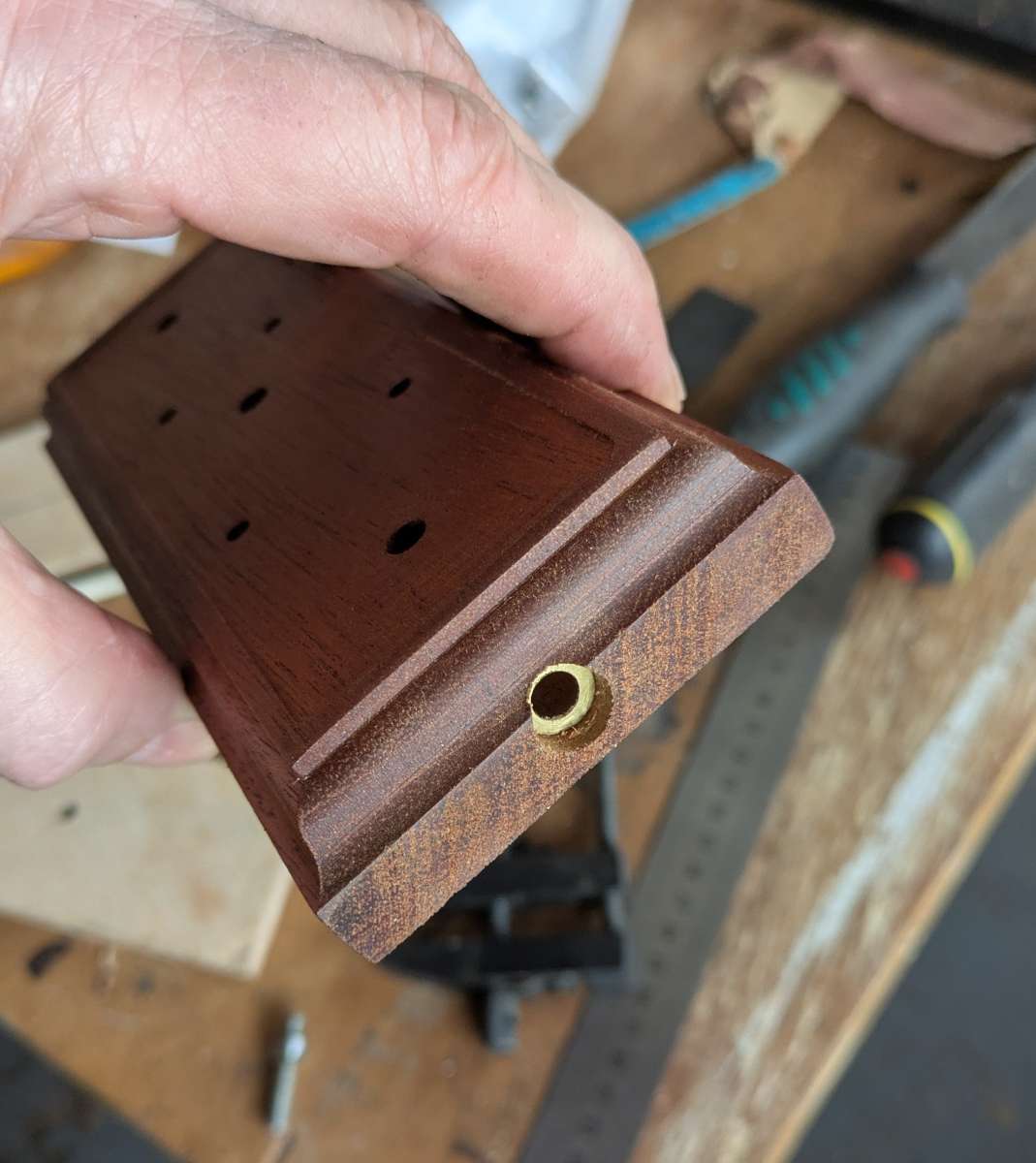

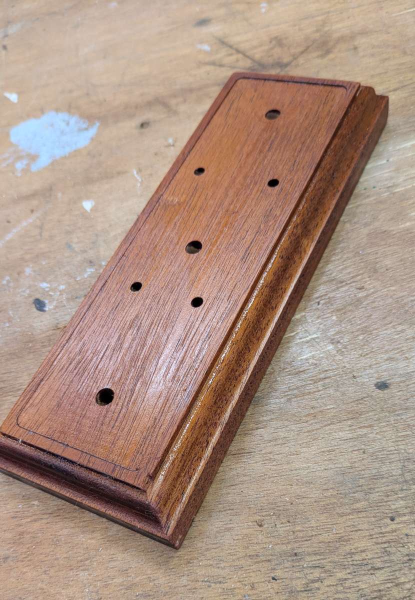

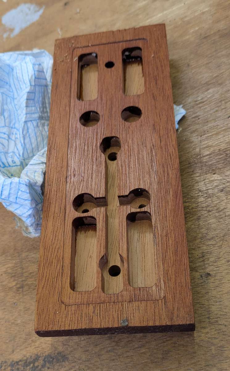

      The base was machined on a KX1 from a piece of African mahogany, which was part of a conservatory purling in an earlier life.

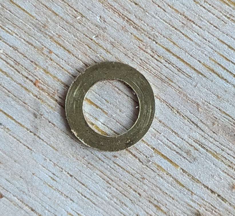

      These old straight keys usually have brass binding posts to connect the contacts back to the transmitter,  but I’m not having any of that, they are never convenient and eventually problematic,  so I’ve incorporated a 3.5mm stereo jack socket.   In order to mount it, I’ve epoxied a custom washer into the base.
      The top brass cover plate has come off quite well, though the CZ121 was a bit gummy to cut,   so the next one needs the feeds and speeds looking at.
      From here on in, it’s all metalwork apart from a couple of insulators, which will be turned out of black Delrin.
      Progress so far…

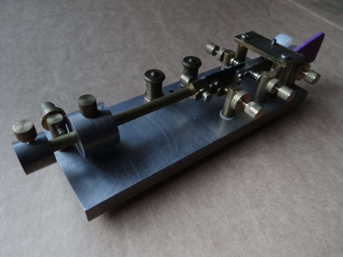

                  First thing I made when I bought a mill was a bug key.   Done as a training exercise, so never beautified, but it works!  The turning was all done on a mini-lathe and most of the drilling could be done with a pillar drill or by hand.  Not a copy of a manufactured one, the design was inspired by various photos in Morsum Magnificat magazine,  Not a difficult project if anyone fancies a go, with plenty of room for improvements.
                  DSC06893
                  Later on I used the bug to develop CAD skills so the plans are available if I can find them.
                  Electronic bugs exist as Arduino projects, I built the K3NG keyer, not difficult or expensive.   Bought a commercial paddle, but a bit of hacksaw blade waggled between two contact pillars works too!  (Not recommending it.)
