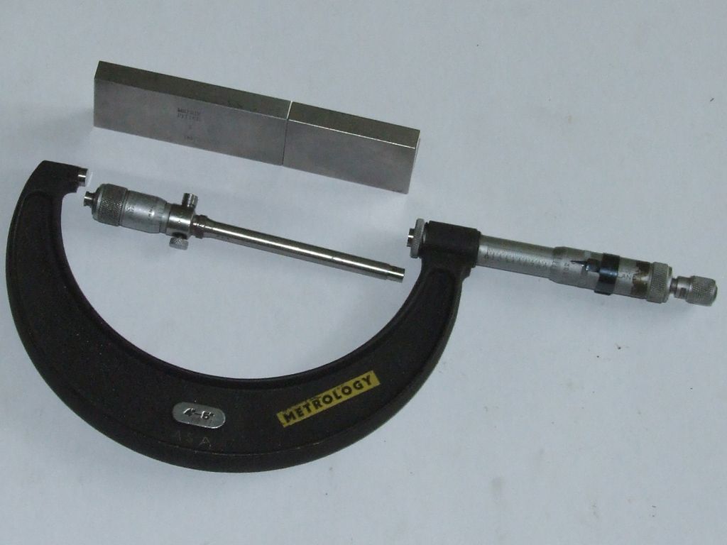

        I recently bought a traditional style 50's 60's Moore and Wright internal micrometer set. I would like to know if the rods adjust individually and how.
        No paperwork/instructions came with the set.
        Mike.

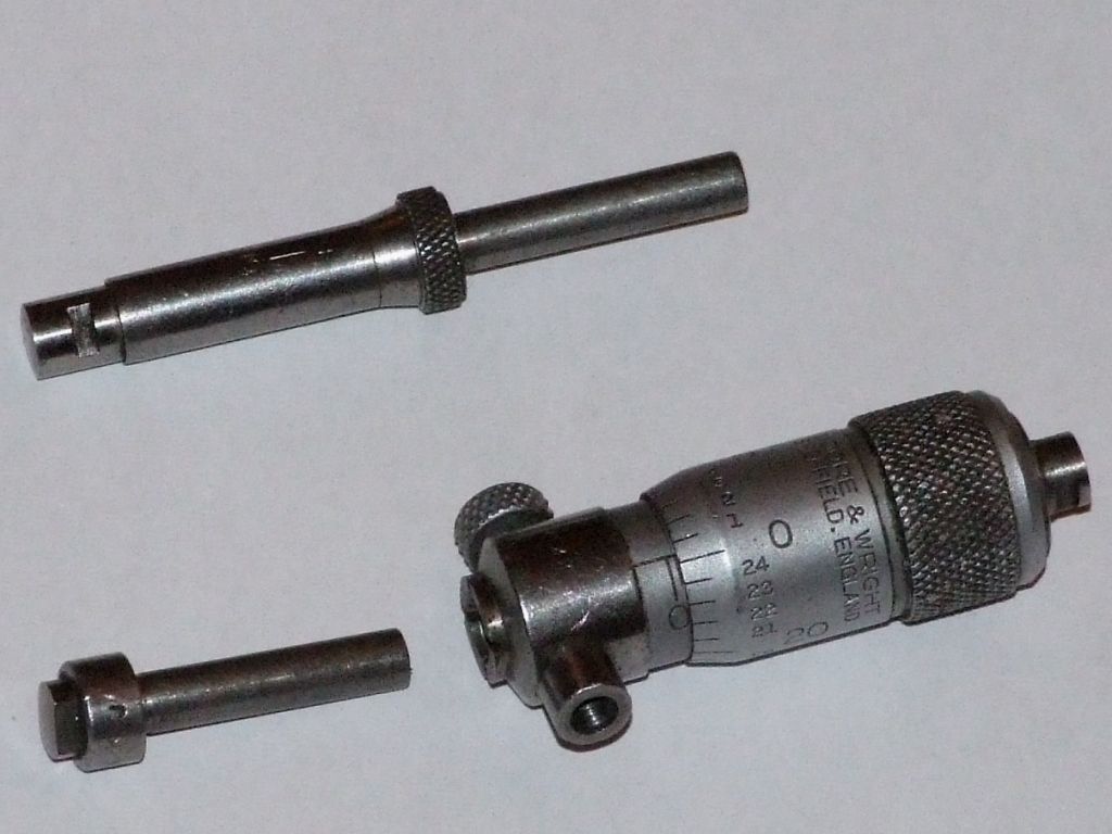

            Anonymous
              On my Moore & Wright 2" to 12" internal micrometer I'm pretty sure the additional rods are adjustable:
              The shortest rod (bottom left) doesn't appear to be adjustable. In that case I assume the micrometer head is adjusted. I think all the other rods are adjustable. Looking at the shortest of the other rods (top left) there are spanner flats on the left hand end and the knurled nut at the right is a separate item, and can therefore be loosened. I don't know what the exact method of adjustment would be, but no doubt it would be clear once the knurled nut is loose.
              Andrew
              Edited By Andrew Johnston on 17/07/2019 22:00:54

                mechman48
                  @mechman48
                  IIRC all the rods are a fixed length; the measurement is taken via the thimble, e.g. a 6" rod is fitted into the thimble & locked in place with the thumb screw, you get the extra 1" of measurement via the thimble as normal hence 6" – 7" internal diameter range.. Any adjustment to accuracy is done on the thimble as in a outside micrometer 'zeroing' . I believe the spanner flats are to aid in seating the rod hard up to the thimble face & in removal of same as the rods can often get tight in the thimble as they tend to be a tight fit. That's my excuse .. devil but open to be corrected.
                  George.

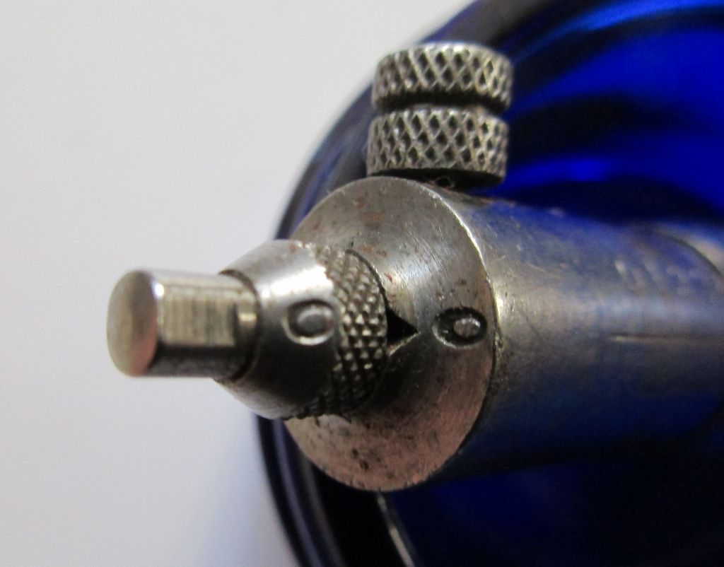

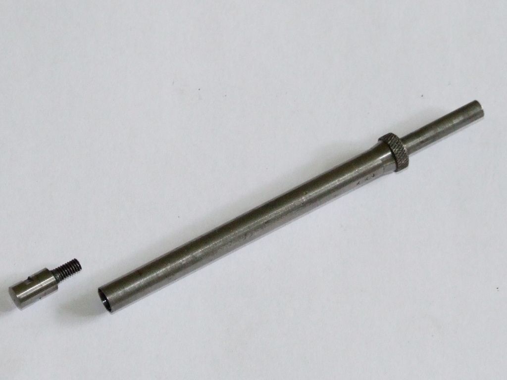

                  Anonymous
                    Further investigation shows that the end with the spanner flats is screwed in, and is a very tight fit:
                    On "calibration" against an external micrometer and gauge blocks the internal micrometer reads about 1 thou under with the end screwed fully home, So it can be adjusted to be exact.
                    However, I do nor believe that to be the correct means of calibration. The knurled ring is definitely screwed onto the plain shaft that fits into the micrometer thimble. I expect that shaft to also be screwed into the extension rod, so the knurled ring can be used to set calibration. However, the knurled ring is very tight, and I don't feel like fudging an extension piece just to prove a point.
                    As new M&W are claiming an accuracy of 0.0001", I find it difficult to believe that they are machining extension rods to that accuracy as a matter of course in production. Much easier, and cheaper, to machine to a looser tolerance and calibrate.
                    Andrew

                          Nicholas Farr
                            @nicholasfarr14254
                            Hi, the rods are adjustable with a spanner on the anvil end as Andrew Johnston has said and according to the data sheet below, is the correct method.
                            These Mics are made in sets and the rods should be kept complete with the body they were originally made for, furthermore when fitting the rods, the "0" digits on the rod and the body should align up with each other.
