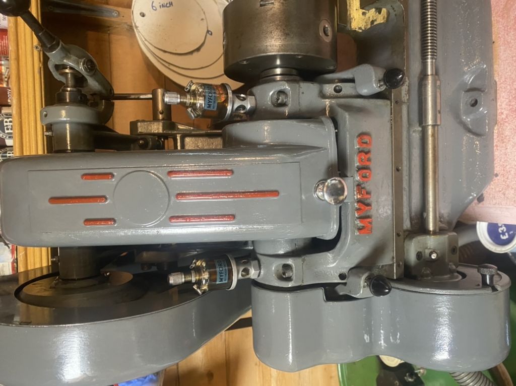

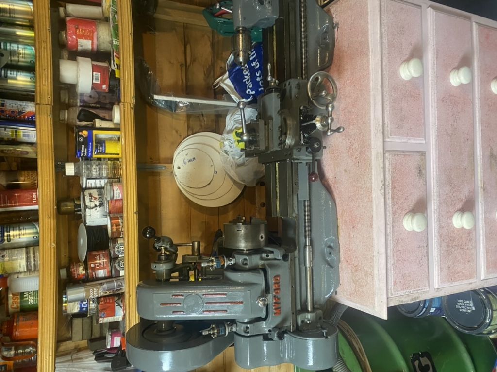

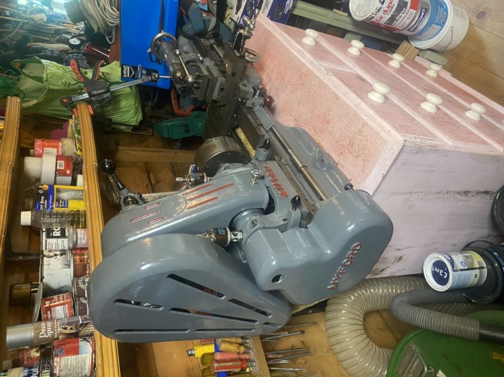

      b399c284-033c-4af7-978d-399e9339fae2.jpeg3a0e6247-9bf7-4549-b9b1-fcd6bd362e8e.jpegHi all,
      well after a week of buying the lathe and trying to adjust everything I could I finally got it to the side of the shed and gave a bit of a paint up and looks pretty good.
      you can see athe bottom of the headstock cover I made a sort of clip to take it away form the pulleys more, as I still couldn’t solve that rubbing problem.
      now I just need to have a go at some turning, I’ve got a set of Hss tools coming and some metal bar I ordered, so we will see how it goes.
      what with the not too stable chest of drawers it’s on I don’t know how good the cutting will be, but I’ll have a go anyway.
      cheers
      chris m…..

          It doesn't appear to be bolted down. I'd be wary of switching it on like that
          Roy

            Normally the belt cover spring clip goes inside the headstock to stop any rattles.
            Dennis

              I'd strongly advise you use a proper bench – it needn't necessarily be a Myford cabinet good, though that would be – and fit the lathe as it should be, to that. Preferably with a chip-tray, too. Not try to use a heavy, high-grade machine-tool standing loose on what looks like furniture designed for a bedroom. That as you have in those pictures is potentially bad for the lathe, inimical to accurate work, and very hazardous for you.
              This rubbing problem…. I thought we'd sorted it between us all! Though I think consensus was really that you need someone actually visit and go over the lathe with you.
              You should not have had to make a clip, unless the one fitted originally was missing. The cover stands directly on the head-stock wall, with a simple spring-clip that goes inside the head-stock. Though it doesn't seem to clip positively into anything. Not on mine, at any rate!
