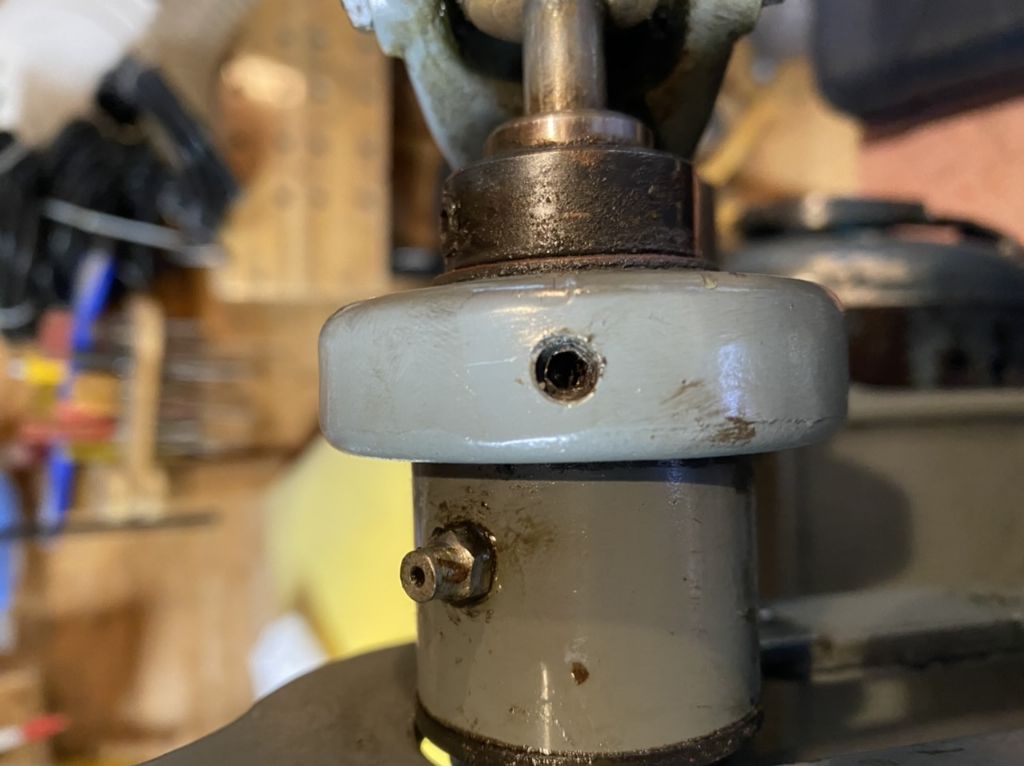

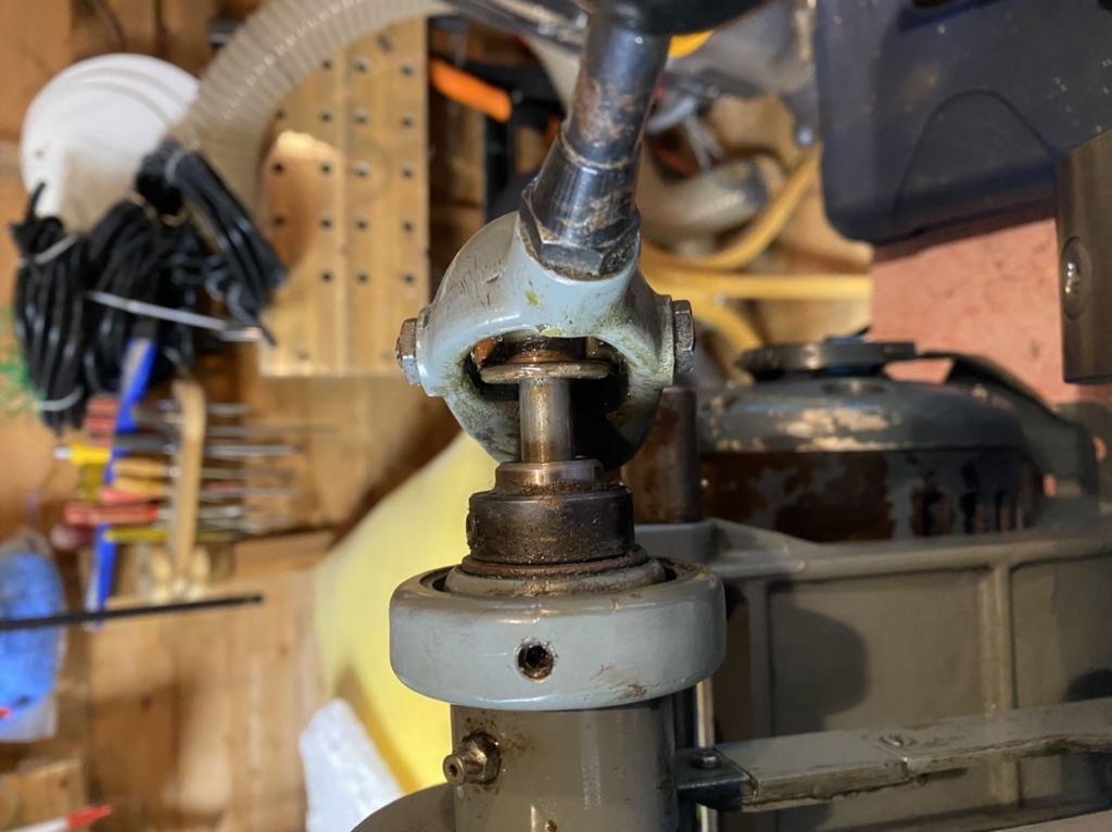

      9cdf8cb8-467c-46a9-a94e-39a394b6ec1a.jpegHi all,
      need help again I’m afraid.
      when I activate the clutch the chuck is still turning although very slow unless I push in and hold the clutch handle.
      I can’t seem to see where I can adjust anything.
      also in one of the pictures it looks like I have a grub screw missing.
      can anyone offer any help, I hope the clutch is not faulty and it we always be like this.
      thanks

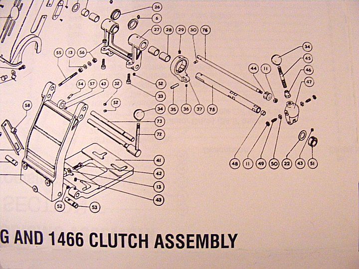

          Good evening, Chris,
          Here's an exploded diagram of the Myford 1466 Countershaft Clutch unit for the ML7:
          I draw your attention to part number 44. On my unit, this is made of brass. Your photo looks different.
          Also, look at part numbers 49 and 50. Part number 50 (2-off) is a rectangular block of red fibre that engages with the groove in part 44. Part 49 (2-off) secures part 50 and permits the parts to be adjusted to engage properly. Thus, operating the lever moves the pair of part 50, pushing the rotating part 44 and the operating rod, part 76, to engage or disengage the clutch.
          Study the diagram, compare with your clutch and then come back and we can discuss some more.

            I've had another look at your photos and maybe you have part 44 OK, it's just concealed by part 47. Please confirm whether you do have parts 44, 49 & 50.
            If your clutch is OK at that end, then there could be a problem at the other end of the operating rod. There is an adjustment at that end. Unfortunately, the picture I posted doesn't show that end of the clutch. There are more clutch pictures in my album but they are a bit 'microdot'!! Maybe, given a bit of time, I can find a better picture of the other end of the device.

              yeah it looks like I do have those parts and like I said the chuck stop spinning if I push the handle in a bit.
              obviously something is not connecting properly.
              I think I’m missing a grub screw as in the picture, would that be the cause.
              thanks

                I can't see any missing grub screw in your photos. Part number 29 seems to be present.

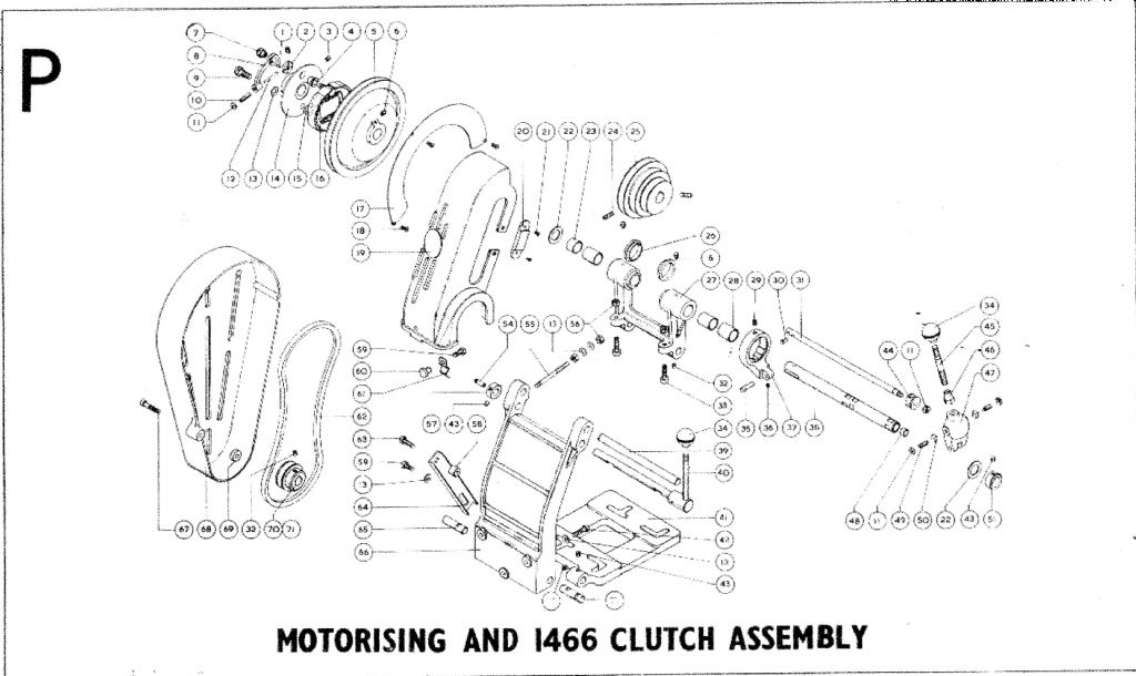

                Here's another version of the exploded diagram:
                I'm afraid it's a bit small but I hope that you can decipher it.
                I think the parts you need to explore now are parts 10 and 12. Part 10 and its locknut are an adjustment point. Part 12 transfers the movement of the operating rod to the clutch lever, part 8, that, in turn, opens or closes the pair of shoes to make or cease contact with the drum. The drum isn't visible in that diagram but it's on the other side of the pulley, part 5 (or 6! ).
                Does this help?

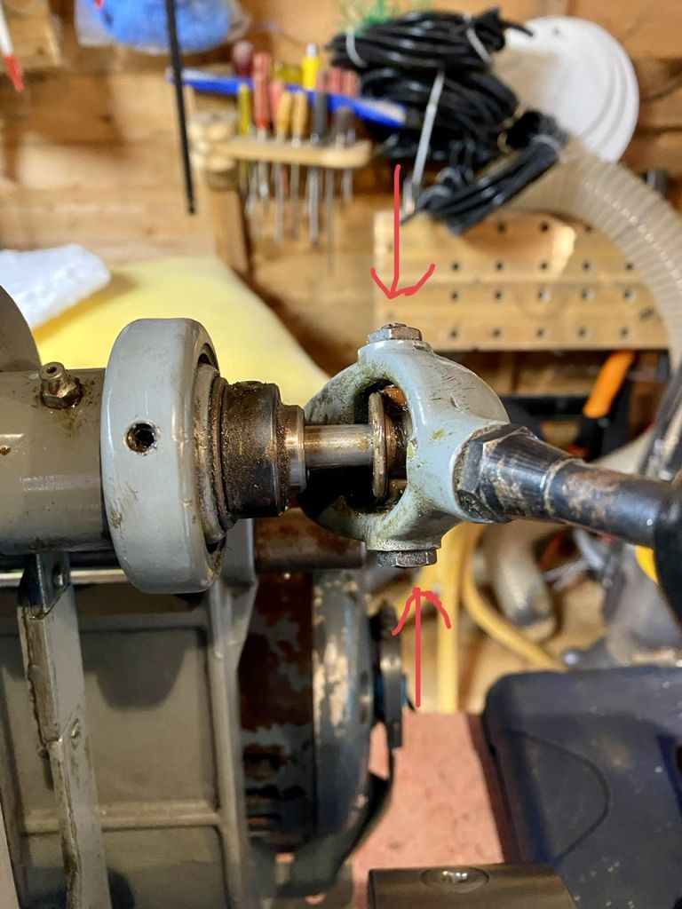

                            looks like I solved it hopefully, I tightened the two nut up nice and tight that you see in the picture on the clutch arm and now the chuck stops how it should.
                            so fingers crossed all is good so far.
