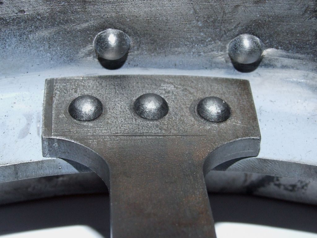

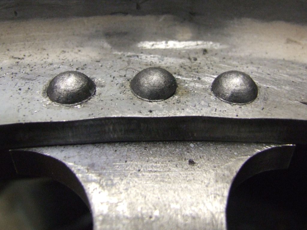

                                  Do a lot of practice rivets:
                                  Shorten each rivet by a known amount per step until it looks right. Then shorten all rivets accurately to the same length. That way one achieves consistency:
                                  I chose to make my own fixtures and rivet snaps:
                                  Finished rear wheels:

                                    Thanks all – as I mentioned, I'm thumbing through the book, reading the bits that get my attention rather than in full detail.
                                    Andrew – the wheels look great. How did you make the concave die? Perhaps hammering a ball bearing into some hot bar or something like that?
                                    Do the rivets need to be heated before installing?
                                    Do you use Loctite on the rivets to take up any radial gaps?

                                      Unless making one of the large scale models the rivits are not heated as they would loose the heat by the time you had got them into the hole and the snap will also act as a heatsink. As supplied they are annealed so should be soft enough to set cold.
                                      No Loctite. As the head is formed the shank of the rivit will also expand outwards to take up any difference between it's diameter and that of the hole, hence my comment earlier that you may need a little more length if the fit is slack.

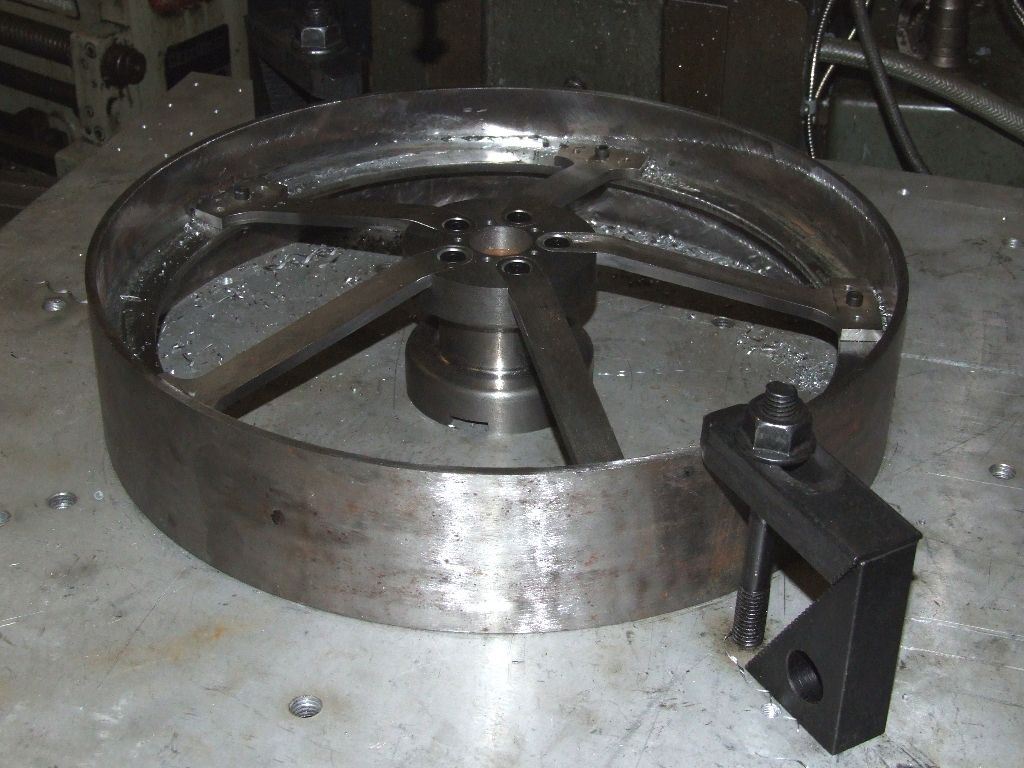

                                          I CNC milled and drilled my own spokes. The rivet patterns are copied from full size rather than the drawings. For the front wheels the 3 holes are on an arc, not a straight line. On the rear wheels the 4 rivets are zig-zag, not in a line. The rivets are 3/16" which is conveniently close to 2BA. The holes in the T-rings were marked out by hand. I scribed a circumference around the T-ring with oddleg calipers at the distance in determined by my 3D CAD model. I also knew the theoretical distance from spoke to spoke from the CAD model. I set that distance on dividers and stepped round the previously scribed line until I go back to the start. If everything didn't quite line up I adjusted the dividers and had another go. Once marked out I spot punched and drilled free hand using the vertical mill. I used a fixture to fit the spokes on each side in turn:
                                          The hub is sitting on a spigot screwed to the plate. The rim is centred on the hub as best as possible with a rule. Note the 2BA screws. Once a set of spokes are fitted it is simple to drill through the other holes on the spokes. I drilled the spokes and T-rings 4.7mm, ie, a tad undersize. When riveting was underway I ran a 3/16" drill through each hole in the spoke/rim before fitting each rivet. Generally after drilling the rivets needed a slight tap with a brass rod to get them inserted.
                                          Fitting the spokes on the rear wheels was similar except that the rims needed blocking up different amounts on each side, and on each wheel. Since the rear spokes are on the inside of the T-rings one can't spot through for the additional holes. I used a fixture based on a spare spoke and a block that straddled the fitted spoke. A 2BA bolt held everything together for drilling each spoke:
                                          Generally the wheels won't fit on my 12" rotary table, but I did fudge it to drill one row of holes in the rim as a starter for the rear wheel strakes:
                                          It isn't obvious if the spokes are a 1/16" or so out, but a 1/16" offset on the strakes would be glaring.
                                          When setting the rivets the expansive force generated by the shank can be enough to distort the T-ring:
                                          My methods are pretty crude, but probably better than the original builders used.
