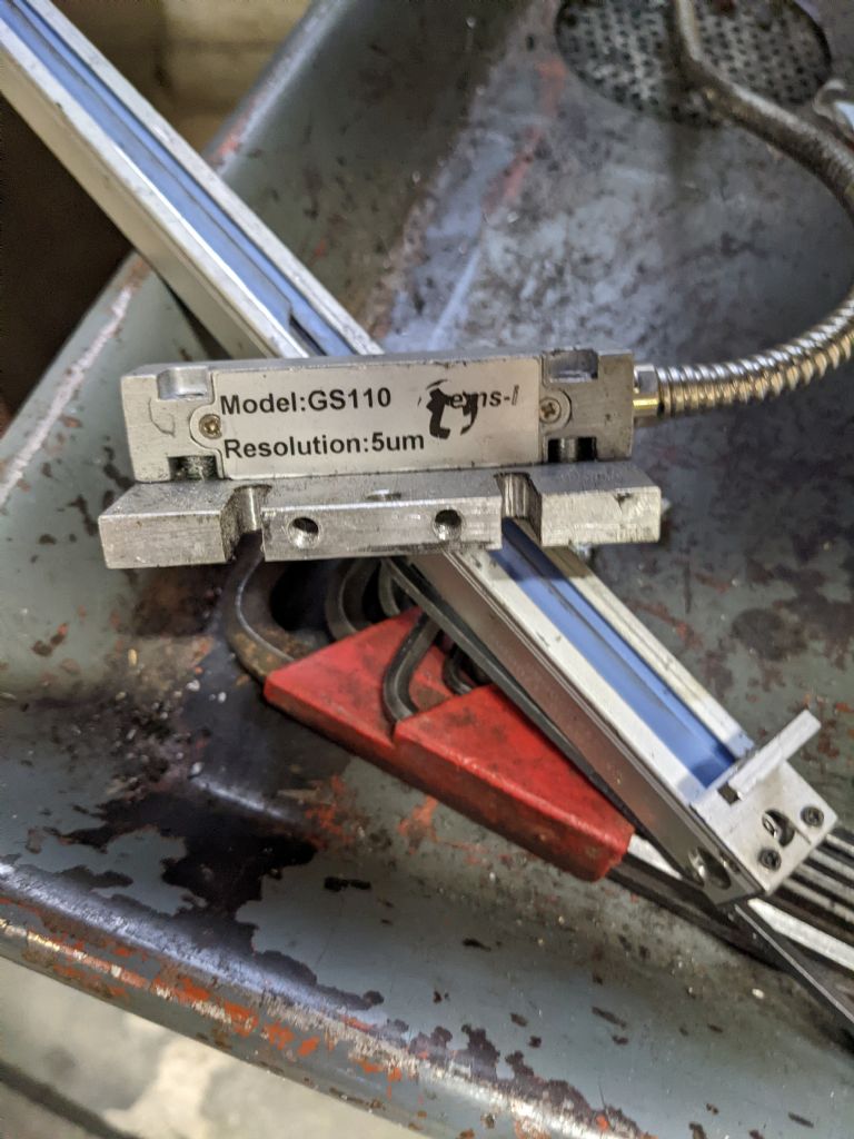

      I have a ems-i DRO pickup that came with my first milling machine, one of the dro pickups was unfortunately damaged in transit.
      The DRO is an ems-i
      I know there was a thread on ems DRO's a few years ago so I searched and only found a bit of a Facebook page that has had nothing posted for years.
      Could I buy a new scale and pickup from another supplier/ manufacturer and integrate it into the existing dro unit?
      Does any one have any info on where I could get a like for like replacement?

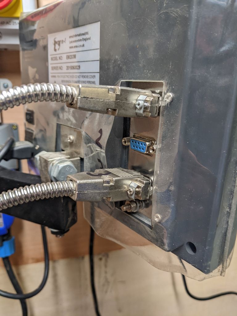

            Tommy Smith
              @tommysmith28025
              Thanks, good idea, here's pictures of the screen, connectors and the pickup part that broke inside the housing…

                  The EMS-i manual for your console should have the pin out / socket in connection details for the scale.
                  Looking briefly at one of the manuals I hoovered up when considering buying an EMS-i system the scales appear to be standard TTL level quadrature output types. Unfortunately the D type connector pin assignments aren't completely standard between makes so you will need to verify that any scale of a different make has either the same pin-outs as the original or, if its different, that you can get an adapter cable.
                  M-DRO list the connector pin assignments for the scales they sell and have a range of adapter cables so it should be possible to sort out a suitable replacement. As far as I'm aware the scales M-DRO supply have the most common connector pin layout.
