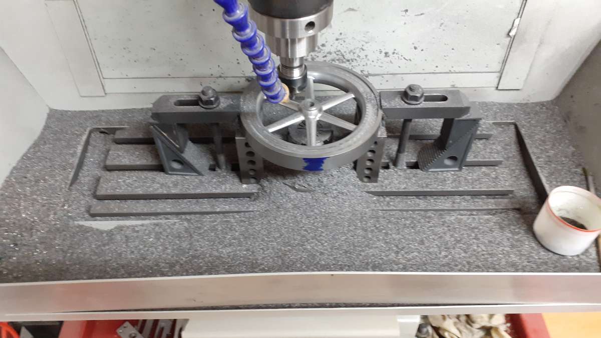

                                Air used to clear swarf will not send it everywhere. Take a look at this flywheel cut at the weekend from solid CI, just about all the chips are in the fairly minimal tray and only a tiny bit on the bench at the side. All cut with air on to clear swarf plush a couple of blowing downs when changing tools and work position.
                                20231211_083144
                                20231211_083153
                                It really depends on what the OP wants the fluid to do – Cool, Clear swarf or improve finish? As I said I’m doing more cutting dry even HSS gives a decent finish dry. Neat oil would tend to clog the cutter and you then run the risk of recutting the swarf which effects finish and tool life so may as well go dry and let the swarf clear itself.
