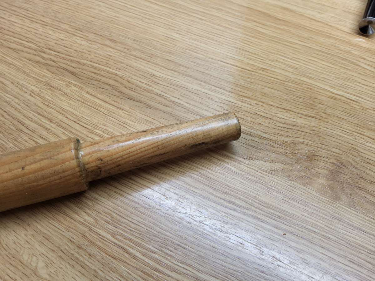

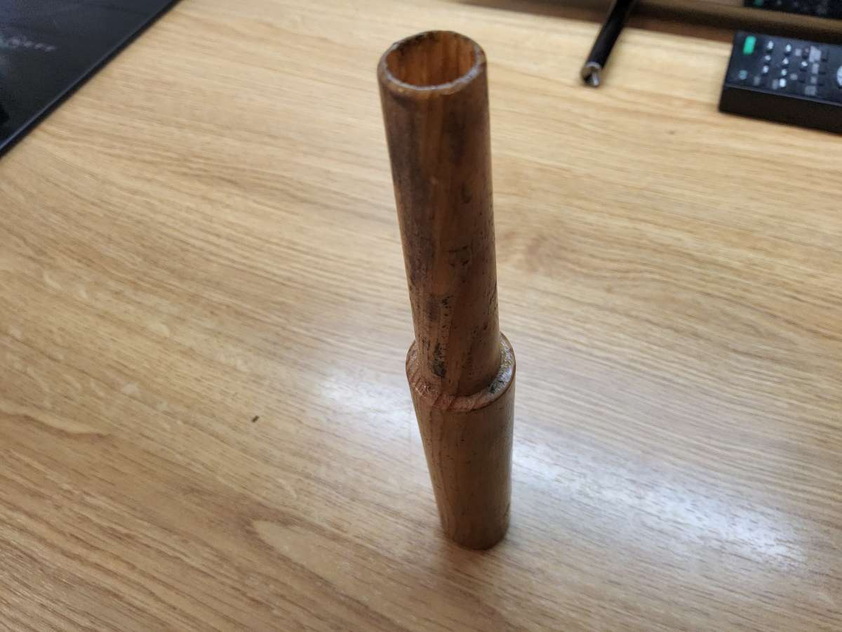

                I also have a Chester Champion 16 mill. I have no problems with run out on the collets and as my lathe has a MT2 spindle taper the collet set also runns true in there as well. I did have problems once and found that small pieces of swarf had contaminated the spindle taper bore by using some engineers blue on the taper of the collet set. Because the draw bar is retained I found it difficult to clean and check the bore I made a wooden tapered piece which has a hole in the end to allow the screw to go down the middle and have used it to clean out the morse taper to remove any swarfe or bits up there. It is only ocasionaly I have a problem but when I have the foreign body sticks to the wood stick and can be removed easily.
                20250729_063951
                20250729_063534
                It only takes a moment to clean the bore with the tapered wood piece.

                    plus one for that David i do that but its surprising the number of people who do not have one!

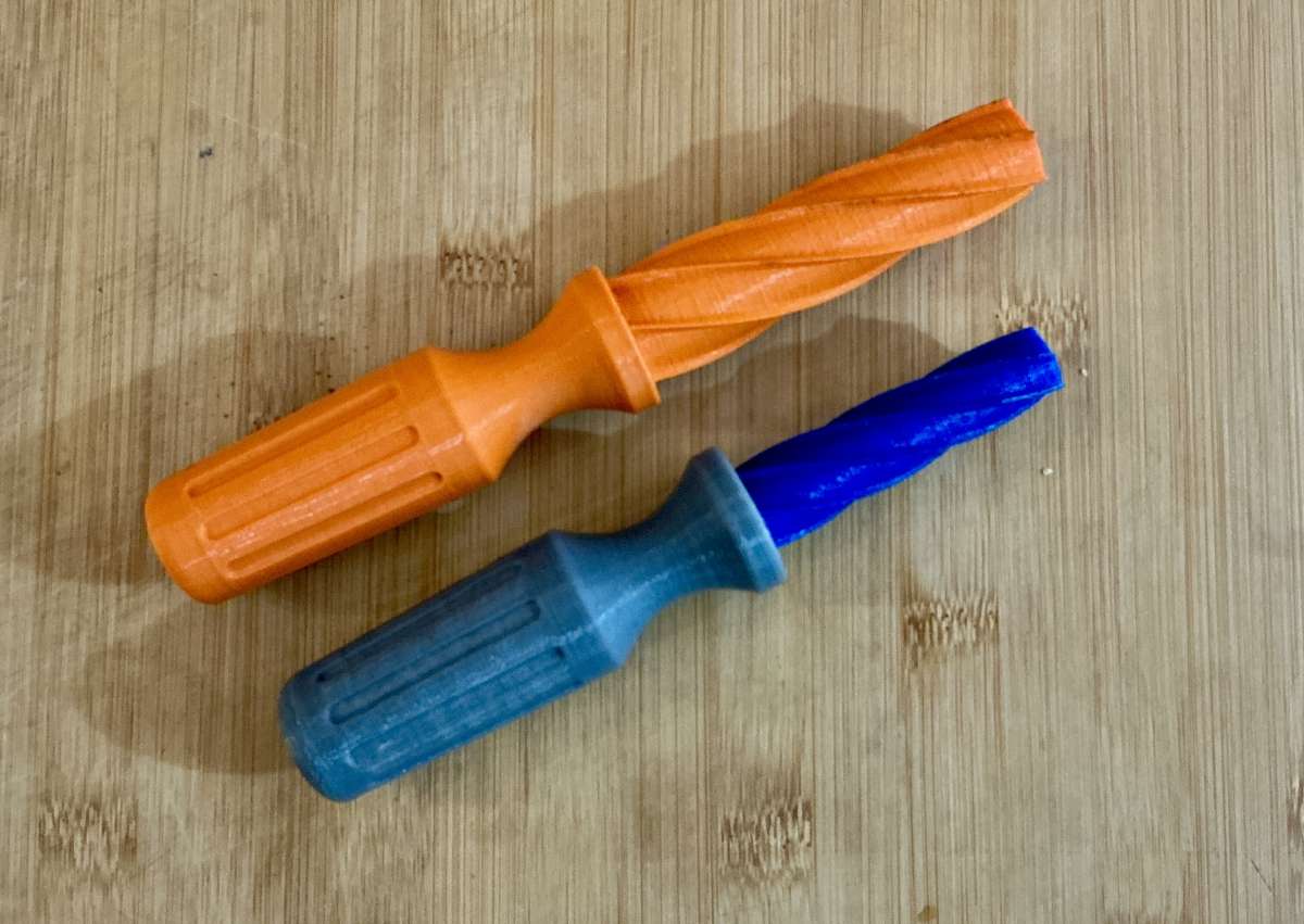

                        If you know anyone with a 3D printer, these work very well. A guy at one of my clubs sells them for a pound each I think.

                            Thanks for the info chaps on cleaning, I do have a 3D printer and will be printing a few of those. What a good idea, as is the wood alternative.
