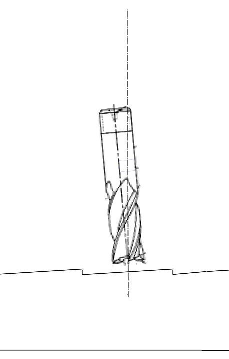

        Could anyone offer some advice on how to improve the finish, it isn't too rough, you couldn't peel tatties with it but I would have hoped for a better finish (i still thing it will polish up ok with some wet and dry)
        speed 2000 rpm, 10mm 4 flute, used cutting oil.

          You ill get the up/down lines you have, that is the nature of a mill.
          I note that you have an island in the middle. If you did not have that island you could skim the top with a fly cutter or if you have a face mill wider than the part use that.
          Are there ridges between the lines? If so your mill might not be trammed, if it isn't I did a video of tramming my Naerok mill.

            Also, lock the quill. If you don't it will move under load.
            #660695
              Check the tran and nod as the ridges are often due to the cutter leaning sideways. Lock evey way that is not moving but I suspect it is about a sgood as you will get with that combi machine.
              Also half the speed if that was with a HSS cutter you may not blunt it as fast then. You want a speed of no more that 30m/min, at 2000rpm you were doing 62m/min (200ft/min)

                    If it is just visual than the mill is OK but often if tram is out eg the spindle is not vertical above the work you can get a saw tooth effect, even if very small you can usually feel it with a finger nail, this is an exaggerated sketch.
                    Just noticed you have the work screwed to a block of wood. This will likely be allowing the work to be pushed away from the cutter as the setup is not totally rigid and that won't be doing anything to help the finish.

                        0.2mm is a bit shallow and will tend to just wear the very corners of the cutter, What was the total depth you wanted to remove?

                          As for ridges, this is normally as a result of the cutting face not being absolutely level and every pass on the Y axis creates a sort of slightly angled path with each adjacent cut creating a minute step. See diagram below (Obviously VERY exaggerated ) of a work section to try and show the principle. This is normally a result of the head to table alignment. Hope that clarifies things a bit.

                              Jason and Mike, you have forgotten the other issue you can get with inadequate tram, where the tool cuts at 90 degrees to the one implied in your diagrams where you get a dip in the middle.
                              In any case, here is a link of me checking and adjusting the tram on my Naerok mill:
                              Naerok Round Column Mill Drill Initial setup and first cut
