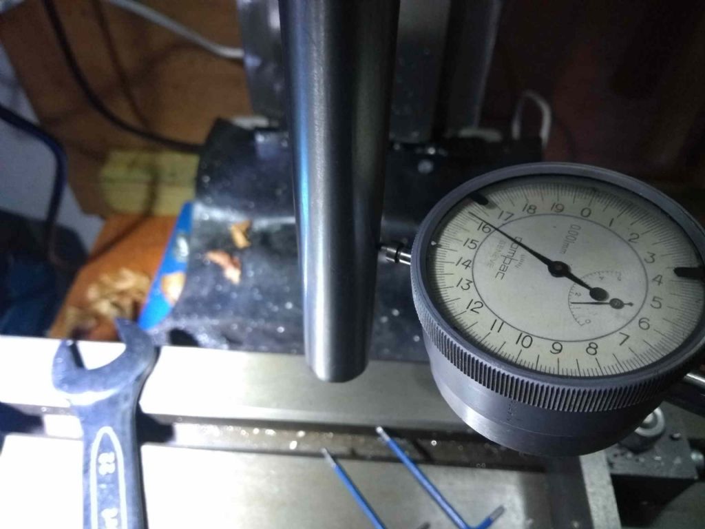

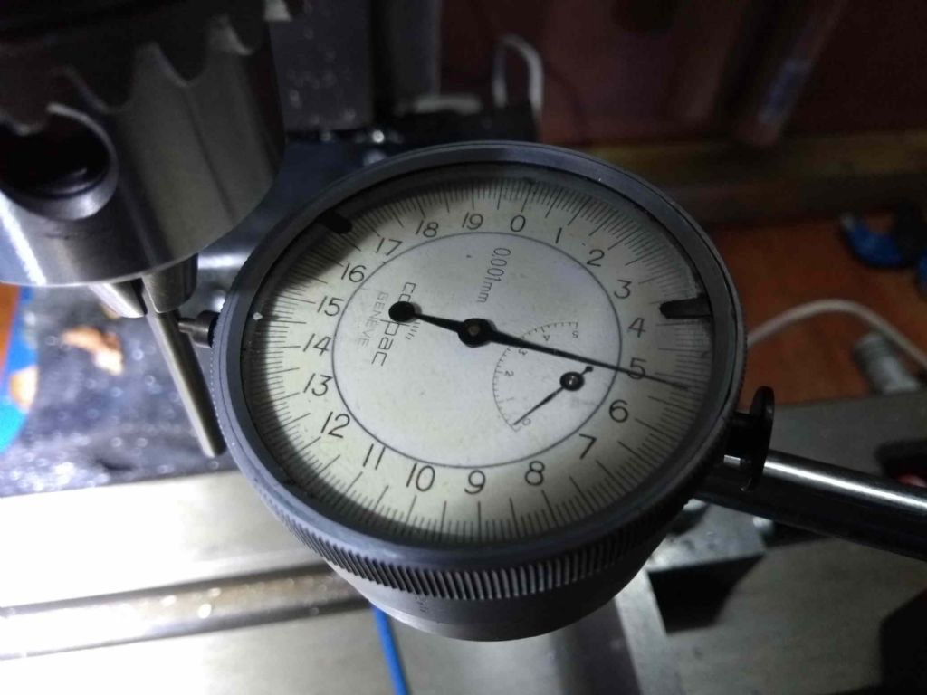

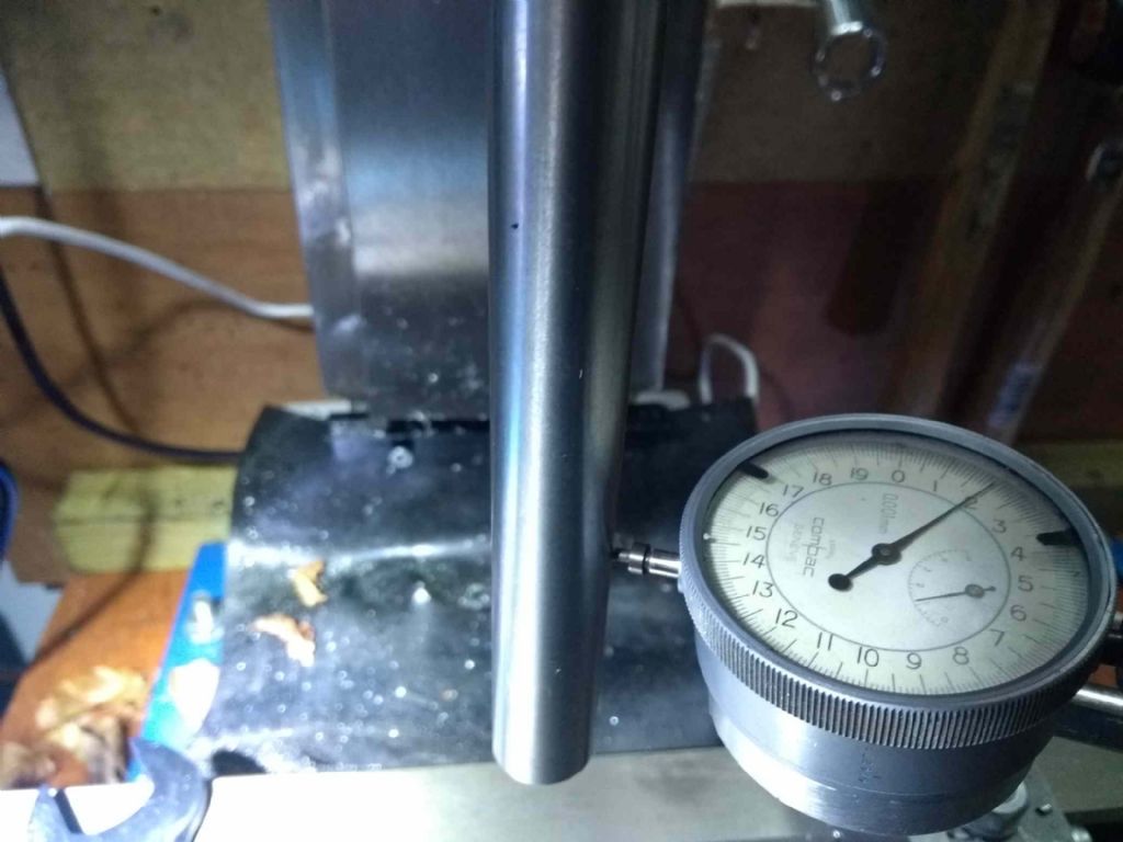

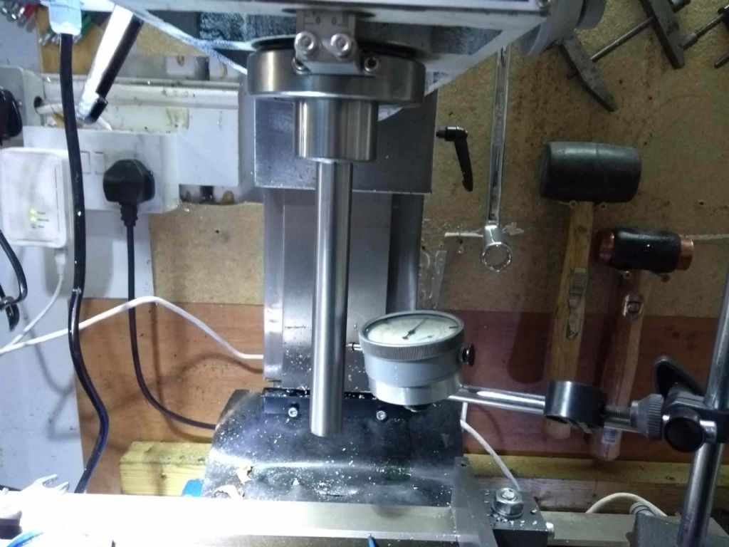

                  Thanks for all the input. After tea, I went out to the shed .. and got more confused.
                  Firstly, The Spindle is R8 and it's the only R8 machine I've got so I can't easily do comparisons.
                  I have checked the runout inside the throat of the spindle – this with a standard 0.1mm indicator and it looks to be of the order of 4 microns. No photo for this, I'm afraid.
                  By finger feel there is some faint scratch or scuff in the throat, but impossible to actually see it.
                  I tried to get a good look inside with an endoscope attached to a laptop. I could really see anything – the wrong tool for the job, I think, however the top of the spindle looked like it had rust spots. On the sides as well as the top. Not sure if that would have an effect.
                  I then took a series of measurements at 100 mm down from the throat of the spindle.

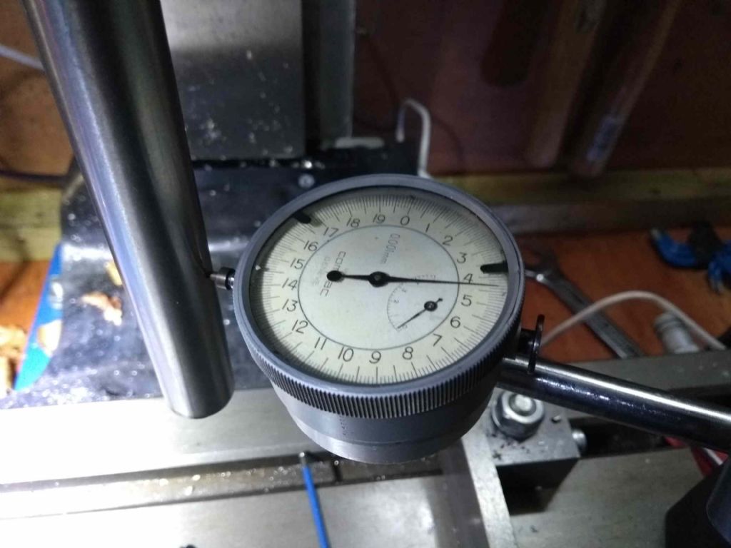

                  The first was with a 20mm silver steel bar which I hope is straight in a 20mm collet. This shows the general arrangement
                  I rotated the spindle by hand, mainly but also under power a couple of times. The results were much the same.
                  The results here were encouraging. Apparently around 50 microns.
                  Min
                  Max
                  I was greatly encouraged!
                  Next I tried a piece of 6mm rod from a scanner – which is supposed to be generally accurate. This was terrible, about 0.3mm of wobble (as I call it).

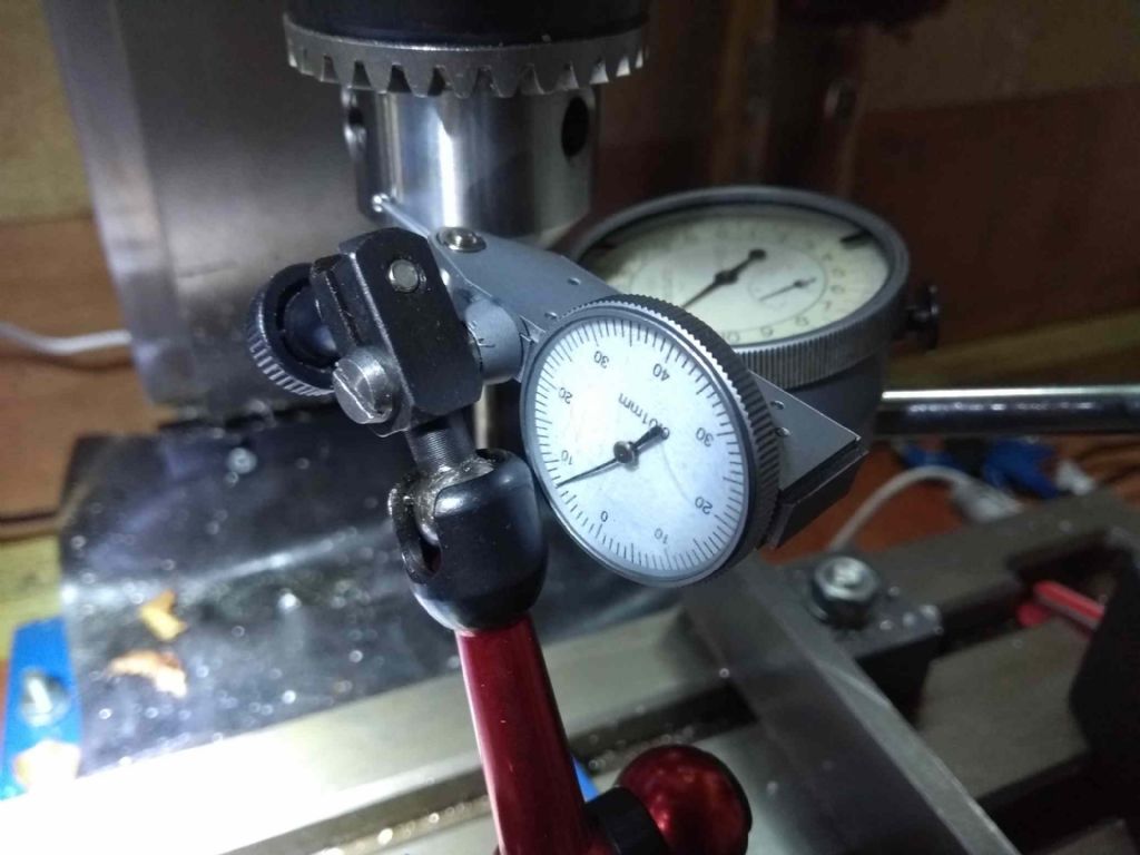

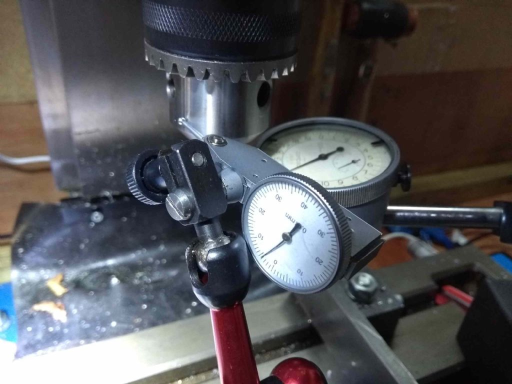

                  Let's try the drill chuck again. I have two pieces of tool steel bar, one 4mm and one 6mm. The 4mm went in and i set up to measure
                  Min 25 microns
                  That's half a millimeter
                  I also measured the run out on the drill chuck mill spindle drill chuck chuck min.jpg
                  To
                  That's about 0.03 mm which is a far cry from what's going on just under the chuck!
                  I then noticed that you could rattle the bar in the chuck. Not a lot, but definitely a movement. It clicked when it moved.
                  I tried the same with my 6mm tool steel bit and the results were about the same.
                  In the interests of repeatability, I then put the 20mm bar back in with the same 20mm collet.
                  This give quite different results.
                  and
                  about 300 microns (0.3mm) wobble.
                  I also noticed at this point that if I turned the spindle backwards it didn't run smoothly, instead it seemed to twitch every 10 degrees. This did not seem to be good. Nice forward, nasty back.
                  Finally, I took another 20mm collet (I happen to have a small selection of these) and put the bar in for that with similar results to the last one (that is, bad).
                  So the first take away is that the drill chuck is bad. It's not holding the drill straight. WIth a 0.03 run out on the chuck body and 0.3 on the drill rod, there's a problem with the chuck. Not sure if I should dissasemble and clean (there's no obvious swarf in there) or try and grind it smooth again. Or buy another chuck.
                  ON the bars and collets, I'm lost. There's something wrong going on here, but I can't work out what. There seems to be some problem – getting such different results in the same session with the same hardware is weird.
                  One think of note. I initially had trouble with collets not fitting in which turned out to be fixed by setting back the set screw which locates the collet, However even now some tools (collets) are harder to tighten up – in the last centimetre or so the drawbar gets stiff – but only at some angles. I don't quite see how this could related, but thought it worth mentioning.
                  I don't know what to try next, so any help – as always -will be much appreciated.
                  Iain

                      It's hard to know whether you're giving us good news or bad overall, Iain.
                      4 microns of runout up your spindle taper sounds excellent to me, as does a keyed chuck that only has 0.03mm. Haas, in one of their videos, tell you to expect "four to five thou" for a keyed chuck. Incidentally, I'm not sure it's diagnostically sound to measure for runout on the exterior of the chuck, as you have done; locking a test bar in its jaws and measuring the bar as close as possible to where it protrudes from the jaw tips seems like a fairer test of concentricity to me.
                      How far down the test bar(s) are you measuring in the photos you've posted? 100mm down on all of them?
                      Edited By Bill Phinn on 21/04/2020 21:55:01

                                                  Loosen again, runout stays 70 microns
                                                  Remove and retighten firmly, runout 90 microns.
                                                  I realised I had another 20mm ground bar, so I replaced the original with this.
                                                  clamped lightly, 70 microns runout
                                                  clamped tightly, 90 microns.
                                                  Then I lowered the quill. which showed a deviation of around 90 microns. However, what I saw was that it was not regular. As I moved the quill down first the deviation went up by 10 microns or so then started to fall back. to 90 microns less. I'd also tried it on the other bar and had similar results. I don't believe I've got two bent 20mm silver steel bars!
                                                  The next thing I did was to lock the quill. this resulted in a movement of 155 microns (0.15mm!)
                                                  The min and max are not quite in line with the set screw, they are around 20 degrees out. I haven't got any pictures but I've blued the spindle and set up some tools. The blue is uneven, with some sopts, but most of the blue is near the mouth of the spindle (on the tool) and is weighted towards one side.

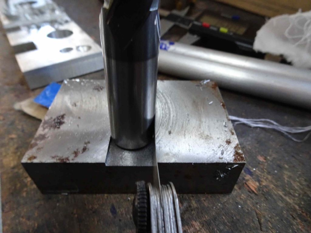

                                                  Finally, I thought to actually cut some metal and see if it was behaving. Here is some steel with a roughly 16mm carbide cutter (refurbished and may be a bit undesized. I measured the stock at 16mm but the blades seemed to be nearer 15.90.

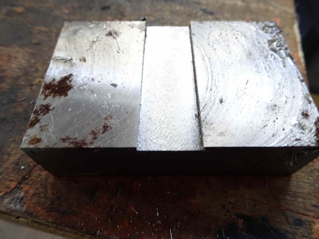

                                                  The channel cut by this mill was between 0.15 and 0.2 mm bigger than the tool. More importantly I heard a nasty squeaking noise as it cut and the surface was poor.

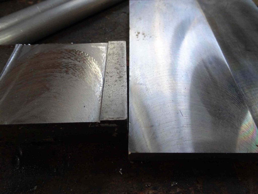

                                                  As I check I turned the piece over and mounted my ARC 50mm face mill . As with the smaller mill, I had a horrid squeaking sound. The photo below compares this cut with 'one I did earlier'
                                                  I think the one on the right was done with the bigger face mill, but I've done work with the smaller one of the same quality. There;s clearly a vibration of some sort happening here which wasn't happening before.
                                                  I'm wondering if this is more about teh bearings than the spindle. I noted earlier that when I turned the spindle backwards by hand it was not smooth. Also, and this may be just how it is, when I slowed the spindle down to around 60rpm, it would tick round rather than runing smoothly. upping the speed by 10 rpm seemed to fix this.
                                                  sad face
                                                  Iain
