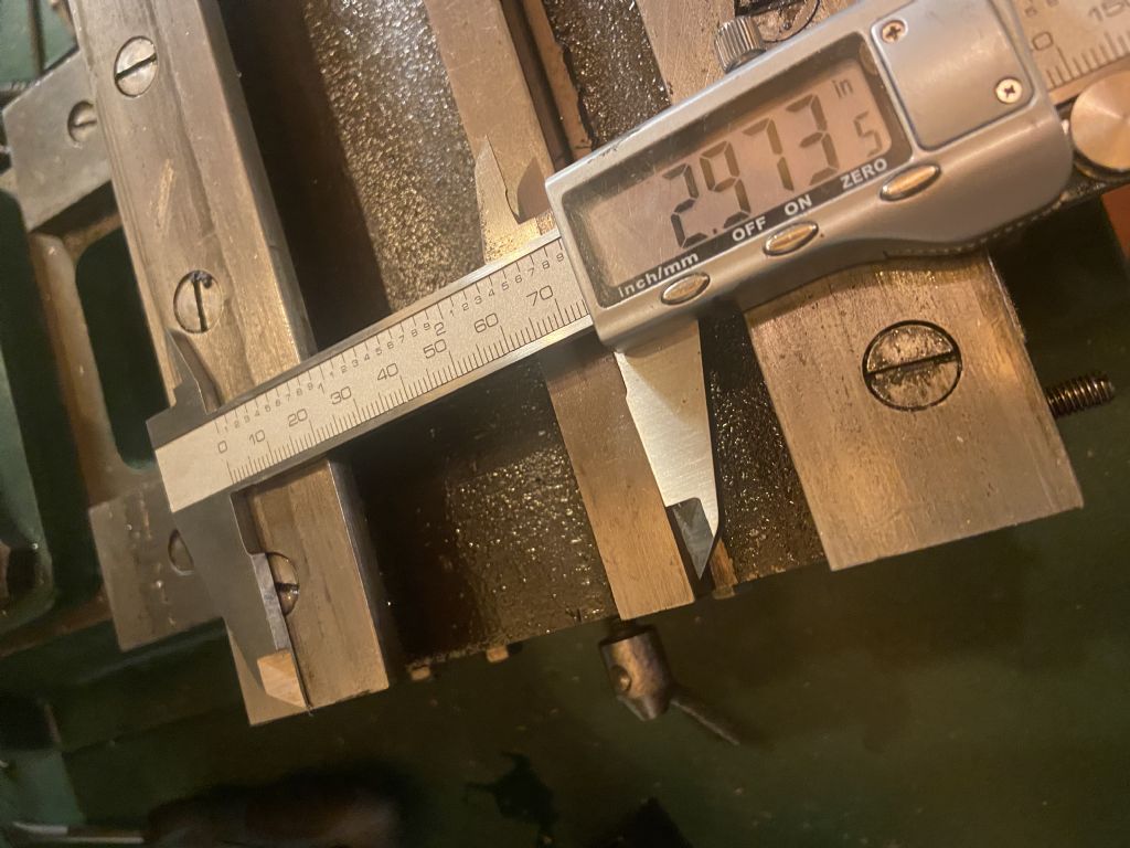

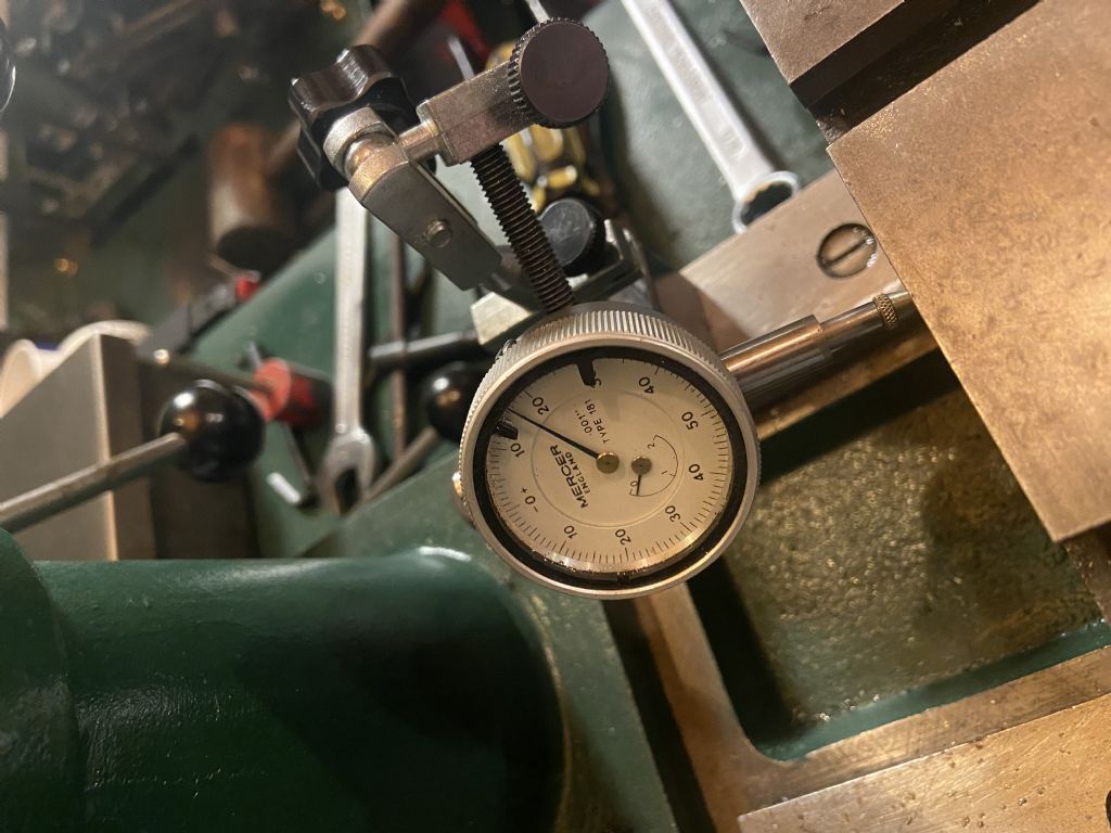

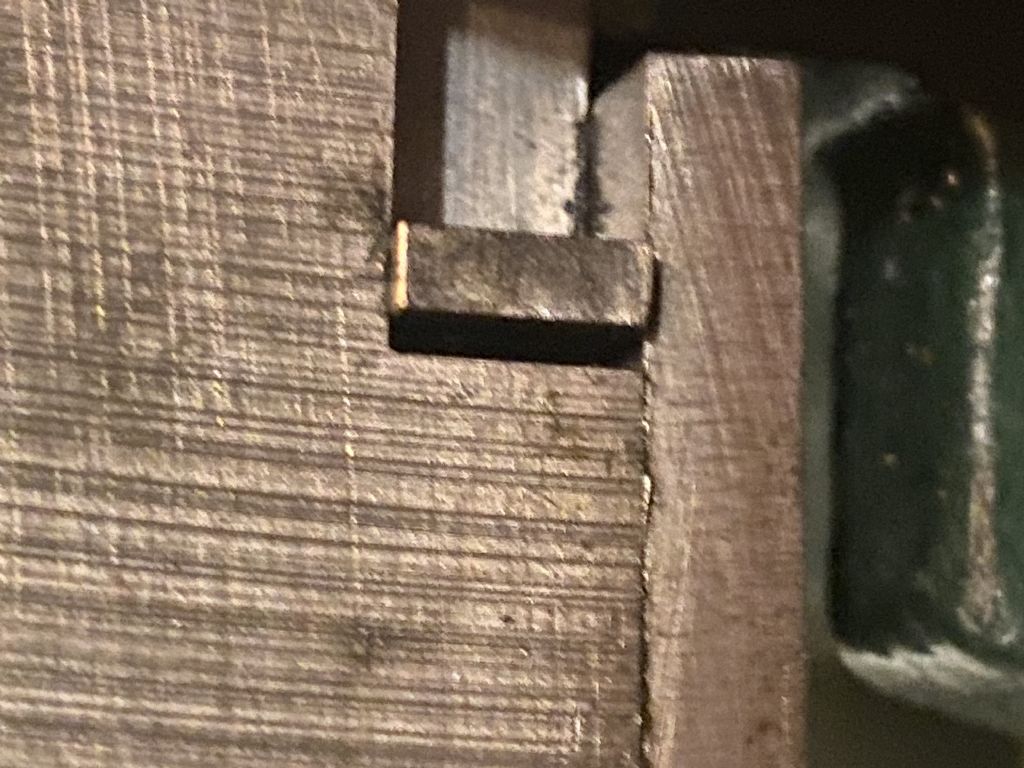

      I know it must seem like I’m always asking questions on here, but I’ve solved loads of other problems on my own, honest!
      While trying to work out why my mill table was wobbling (which I think is fixed now) I noticed that the vise didn’t seem square, so I put an indicator on the mill table. Lo and behold, it didn’t seem square to the base – about .015 movement across about 2/3 of the width.
      So I took it to bits again, and it turns out the the ways are not parallel. 3.0” at one and and 2.973 at the other. In fact, you can actually see this difference from the outside. I’ve put this all in pics below. Only thing is, I’m not 100% sure that the indicator movement is in the same direction as the slideway parallel difference, it something is definitely wrong.
      I guess, Dore Westburys being originally a user built kit, it was an error in the original build.
      Before I start messing around trying to re-bore the countersunk screw holes in the slideway to put them in the right place, I would ask here for opinions on what to do (if anything). And ideas on how to do it, that doesn’t involve using a milling machine, cos it is in bits again.
      Thanks
      Steve

          If the edge of the table is not parallel to the direction of travel which seems to be what you are saying here, it is not anything to do with the slide way strip that you have shown in the photo with the caliper reading of 2.973" .The guide strip that is screwed to the underside of the table the one the gib strip runs on controls the position of the table ,you would need to check that the guiding edges of this strip are in line with table edge.
          In any event apart from from a nuisance does not affect the operation of the machine in any way ,for what it is worth you would probably need to replace the strip rather than try to reposition the countersunk holes any distortion to the existing strip is likely to lead to more problems.

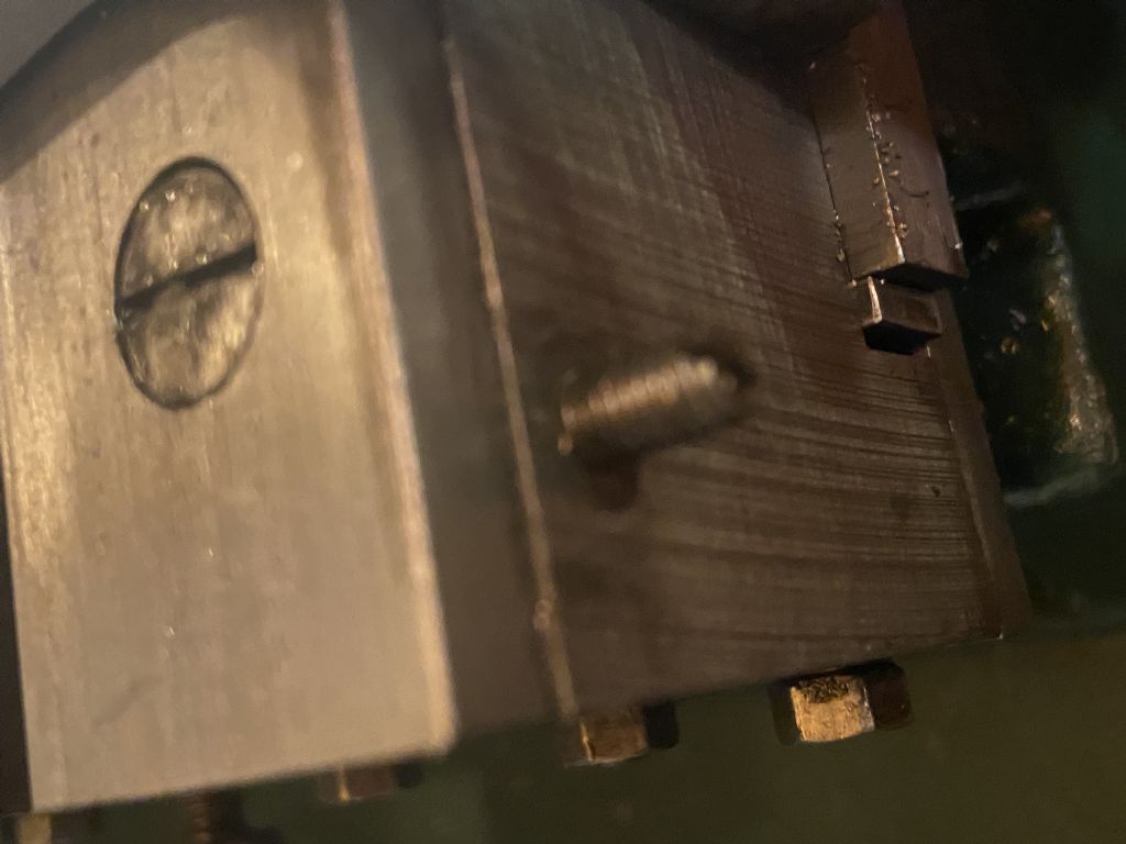

            If the strips on the underside of the table are out (Both? Maybe only one )
            Could you make a new strip?
            Clamp to the table, clock so that the edge is parallel to the table movement, and then drill and countersink the holes
            Alternatively could you remove all but one of the screws and adjust the position until the edges of the strips are parallel. Hopefully one edge IS parallel to to to where it should be, and can be used as a datum.
            You need to find which one, or you may remove the wobble but have a table which runs out by several thou relative to cutter when traversed.
            I would feel inclined to start by clocking the T slots on the table when it is pulled /pushed against one of the locating strips, so that the slots are running true. In this way, you ahould be able to decide which of the strips need to be remade / adjusted..
            Once the strip has been adjusted parallel to the datum strip, it can be located with dowels or rollpins, before drilling and tapping new holes and countersinks
            The strip is located by the dowel, rather than the countersink, which is then only to provide clearance for the screwhead.
            Where are you located?
            Maybe someone on here could give some face to face help Seeing things rather than just looking at pictures might give a better understanding of the problem area and how to overcome it.
            Howard

                You are absolutely right, the gib strip (located under the display of the calliper) pushes the table against the guide rail, which is located under the right arm of the calliper in the pic. I need to look into this more.

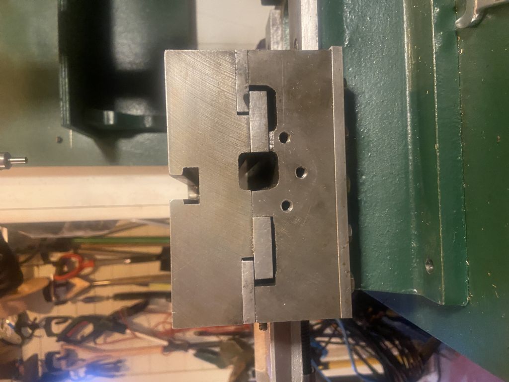

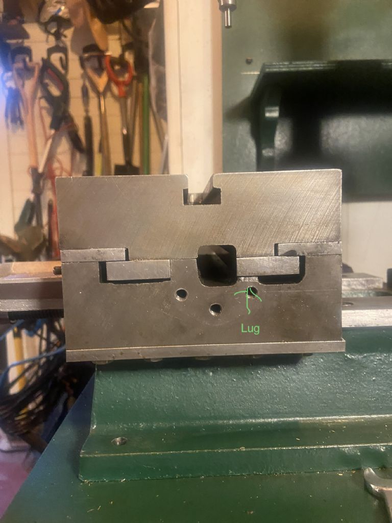

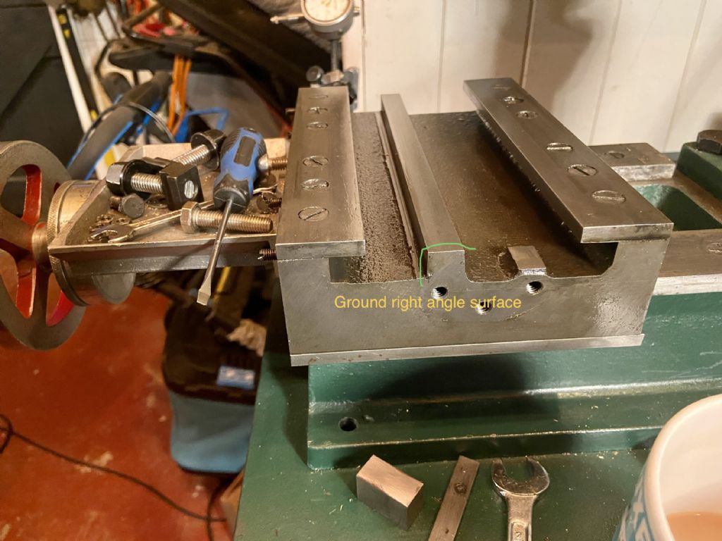

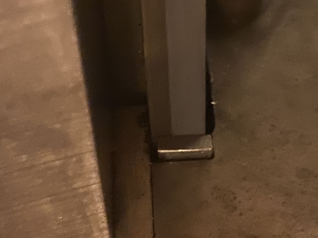

                    Right, I spent some time on this before work today.
                    This all started on Sunday night, when I wanted to start to make some vise jaws (missing from vise I bought on eBay). I decided to mill a test piece to check for square before I started squaring the ends of the stock for the jaws. It wasn’t square.
                    I think to some extent I am chasing ghosts. I’ve been measuring with reference to the base. I’m not sure this is relevant.
                    Is this statement true? :- It doesn’t matter if the milling table is not square to the base of the mill (within reason). The milling cutter is round. What matters is that the X, Y and Z axes run perpendicular. Tramming ensures the Z axis is perpendicular. The X and Y axis should be perpendicular by manufacture of the table.

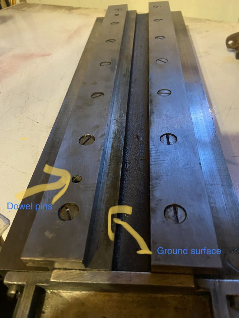

                    Looking closely at the Dore Westbury table, one of the slideways is precision located with dowel pins on a ground surface. It looks to me that this is supposed to be a perpendicular reference surface. The other slideway isn’t so important.
                    TABLE
                    BASE
                    Looking at the base it sits on below, there is a perpendicular ground surface. That looks like it should mate with the precision perpendicular surfaces on the table. This would guarantee that the table and the base run parallel.
                    However, they don’t. See below how it is…. The non-precision located slideway is against the ground guide.
                    And clearly, this is how it should be….
                    So basically, it looks like the table was installed the wrong way round. In fairness to the bloke who built it, he does seem to have followed the drawing.
                    This would explain why the table is wonky, and why I’m not getting square parts.
                    I’d appreciate any views on this. Am I right?
                    Cheers
                    Steve
                    #568461
                    Howard Lewis
                      @howardlewis46836

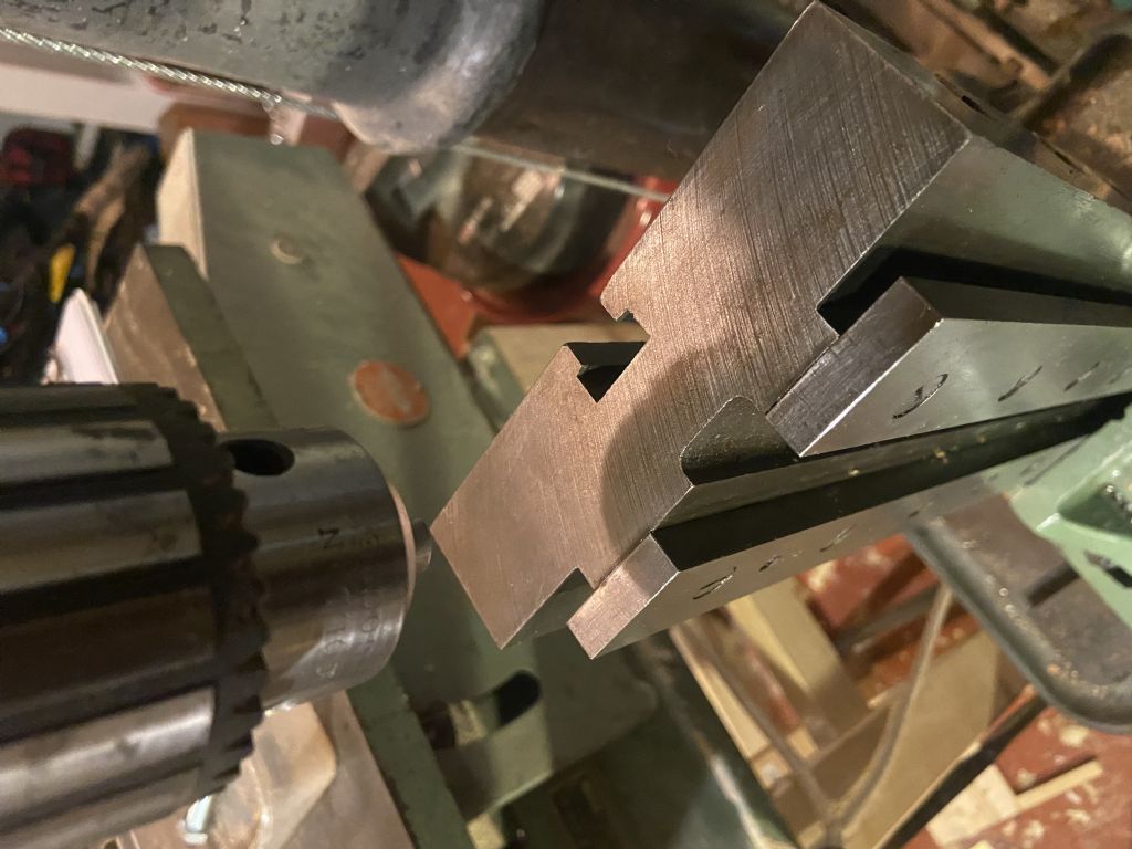

                      The two ground surfaces should be running against each other.
                      But, the Ground face fixed to the table should ensure that the table moves in a plane, X axis, left to right, perpendicular to the Y axis, to and from the operator.
                      It seems that you are likely to to be in a situation which is the reverse of the way that things are normally done,, by needing to align the ground face of the strip so that it is parallel to the Tee slots
                      I would suggest removing both strips and fitting to ground strip,(but not yet dowelling it ) so that it rides against the ground face on the bed of the machine. Adjust the table relative to the strip, until the T slots clock true. A copper/hide mallet is going to be useful for this.
                      When the strip is aligned drill and dowel / rollpin to maintain that alignment.. This may mean that new holes have to be drilled, countersunk, and tapped at new points along the strip.
                      Once you have achieved that condition, the problem of the 0.027" variation can be addressed and correcte on the other strip, in similar manner.
                      (You need the Tee slots to be in the same plane as the motion of the table, or will always have to clock the vice to set the jaws parallel to the line of the cut. Once the T slots and line of travel are the same, the vice can be aligned to the table with keys, or an alignment fixture ).
                      Howard

                          Yes it is true , except for the last part after i had built my Dore westbury
                          the squareness of the X and Y was off by few thousanth's of an inch,
                          it is possible to re-machine the Dore westbury XY cross slide on a Myford 7
                          lathe cross slide because this is how i corrected mine.
                          There is little point to having the tee slots in line with the travel of the table
                          because of, 1 the longitudinal slots at each end are too short in all probability
                          to be able to mount any additional accessories (vice) without using some of the
                          other slots in either side of the table ,2 the tee slots in a Dore westbury are cast
                          in and not machined and are useless as a reference unless reworked
                          for that purpose.
                          As it is the 1st photo that you have posted showing the underside of the
                          table the dowels are in the correct slideway/ guide ,as you have surmised the table
                          has been fitted the wrong way round, however fitting the table as in the last photo
                          which is the correct way round also puts the guiding slide with the dowels on the
                          correct side, it is worth noting that if you remove either of the 2 guide strips from the
                          underside of the table they may be shimmed as this is the normal method on these
                          machines to control the table lift /clearance.
                          Edited By John P on 27/10/2021 13:35:41

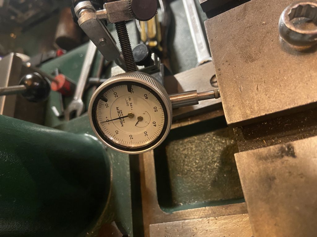

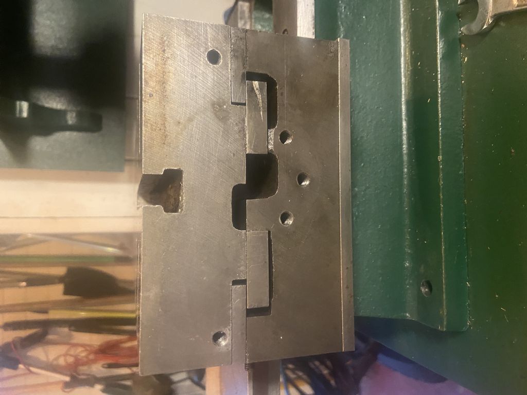

                            Thanks John, it’s really helpful to know I’m not just going mad. I’m very new to all of this and it’s particularly difficult with a machine that wasn’t professionally built in the first place, to know what’s right and what isn’t.
                            I just turned the table around and threw an indicator on it, moving it manually. Even without the gibs or hand wheel installed, I can see that it is way better than before.
                            I also may have found the source of the “wobble” and hand wheel stiffness. If you look at the pic above of the table the wrong way around, you can see that the screw holes that attach the handwheel tray are poorly placed. This would place stress on the lead screw – causing the same effect as it being bent, I would expect. So I can sort that out too.
                            Now I’ve just got to work out how to drill accurate holes in the end of that table. Luckily I have a big pillar drill!

                              Try attaching the bearing for the leadscrew with one or two setscrews, Hopefully after a number of combinations the tapping that is out of position will be obvious.
                              You then have a choice.of solutions, depending on how far out the hole is.
                              1. Open up the hole to clearance around the odd man out.
                              2 Using the bearing block as a jig, drill a jig, but with the rogue hole only drilled to thread size (Probably 1/4 BSF )
                              Open up the hole to tapping size for 3/8 BSF, 8,25 mm&nbsp
                              Using the jig to drill the rogue hole out to 8.25 mm and tap 3/8 BSF.
                              Turn up a bush with a 3/8 BSF external thread, and an internal thread (Presumed to be 1/4 BSF)
                              Screw the bush into the hole, ensuring that it not above flush. Use thread locker if you wish.
                              When the anaerobic has cured, reassemble, and hopefully table movement should be as wanted.

                                  The easiest way to do this is to remove the XY slide from the machine,
                                  lay the table upside down on a bench fit the X leadscrew nut in position
                                  on the XY slide fit the XY slide on the table fit and adjust the gib in place ,
                                  screw in the leadscrew and end bracket as far in towards the nut as it
                                  will go ,if you view down alongside the table the leadscrew should be
                                  visable and it will be easy to see if the leadscrew is parallel with the
                                  slideways then looking down from the top likewise the leadscrew
                                  will be in line with the slide bars.
                                  Probably easiest to just fix the end bracket to the table with a dab of epoxy
                                  glue let it set ,make up a long centre punch that fits in the holes of
                                  the end bracket ,if the glue will hold you can carefully traverse the
                                  XY slide along the table before marking the 2 hole positions to test
                                  the position.
                                  When satisfied with the positioning use the punch to mark the
                                  hole positions drill and tap for the 1/4 bsw fixing screws if they are
                                  still this size they are on mine.

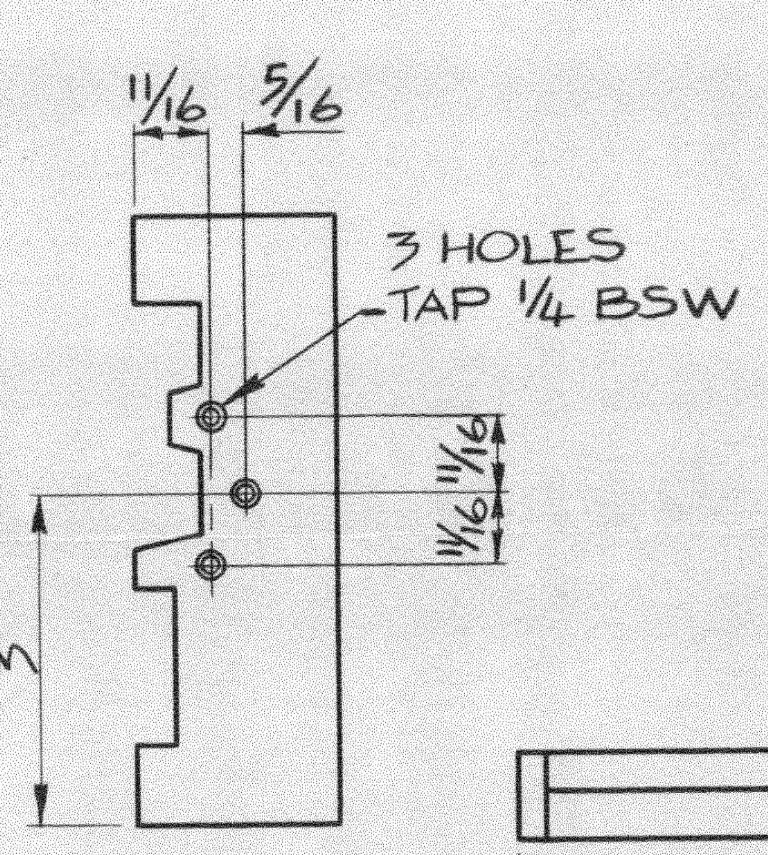

                                  #568554
                                  John P
                                    @johnp77052
                                    #568557
                                    Steve355
                                      @steve355
                                      John, do you mean this bit?
                                      #568563
                                      John P
                                        @johnp77052
                                        Hi Steve,
                                        Yes those three holes , it would be as well to assemble the parts as suggested earlier just to check the positioning before drilling the holes in the end of the table as if any of the the existing positioning is off it will lead to an error.
                                        (because the ****** person who built the mill) as you had written earlier had obviously got some things wrong like having the table the wrong way round.
                                        #568565
                                        Steve355

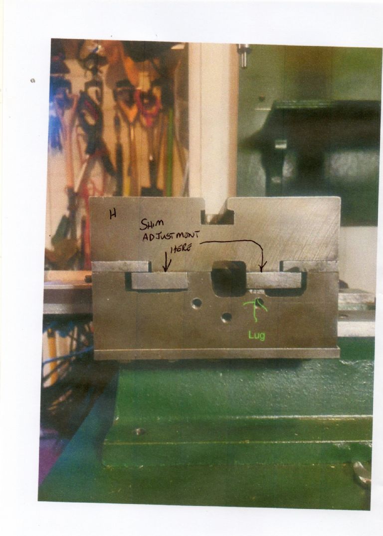

                                            I dont know if you are around but I’m still having significant problems with the table wobbling by a couple of thou, The good news is that turning the table the right way round has ensured squareness and there is very very little play in the horizontal plane, once the gibs are tightened.
                                            But there is play in the vertical plane. With the table central, I can quite easily lift it by a couple of thou using my fingers under one end. And if I turn the handwheel it has the same effect.
                                            Most slideways are dovetail, so secure a table in the horizontal and vertical plane at the same time. But the Dore Westbury is not, the only securing force from the gibs is in the horizontal plane. I find it difficult to believe that this isn’t accounted for in the design somehow. I am wondering if I am missing shims somewhere or something?
                                            if you have any thoughts I’d be glad of them (or indeed anybody else!)
                                            Cheers
                                            Steve

                                                The adjustment should be by shimming under the two flat strips fitted to the underside of the table,it may well be that when you remove them the edges that engage under the slideway strips may have worn ,likewise the underside of those two strips may also be worn .It is fortunate that the design of the Dore westbury these parts can be renewed just by replacing the strips in the same way as when the machine was made providing the sliding surfaces of the table are in good order this should be a straightforward procedure although the shimming may be a tedious operation ,as far as i can remember the strips are imperial sizes.
                                                Seeing as you have turned around the table it may have been adjusted for when it was the other way round and just needs some adjustment.

                                                  Not knowing the DW, but looking at your photographs, it may be that there is excess clearance between the steel strips on the bed and the steel strip on the underside of the table.

                                                    Posted by Dave Halford on 05/11/2021 20:55:21:
                                                    Under one end or both?
                                                    There is a cast iron lug under the handwheel end that would control vertical movement in one direction however, it is only at one end, and I can get a slim feeler gauge between it and the table.
                                                    I also wonder about the gibs. Lower gib is full height:
                                                    upper gib is about 2mm short:
                                                    e0e60336-7f74-49ed-a1af-142de852d1a5.jpegThis might have given rigidity in the vertical plane. But it does seem to correspond with the plans for the mill.
                                                    at the non-handwheel end there is nothing except for the friction from the gib to stop the table moving in the vertical plane.
                                                    Strange. It can’t work. Unless I’m missing something.
                                                    crying 2
                                                    #570041
                                                    John P
                                                      @johnp77052
                                                      The lug shown in the photo ,the only function of this is to provide enough
                                                      material for one of the tapped holes that hold the lead screw nut,
                                                      the two places marked on your photo here are the only adjustment
                                                      for the vertical clearance of the table if you remove those strips
                                                      there will most probably be some shim material between the
                                                      strips and the table ,there should be some reference to this in the build notes
                                                      that i believe that you have.
