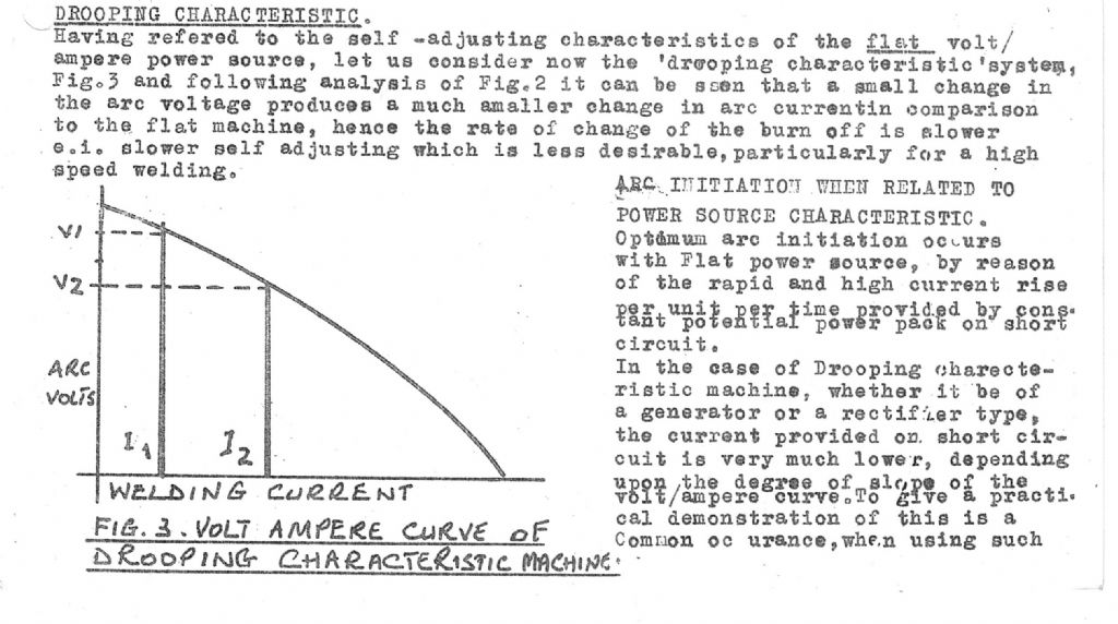

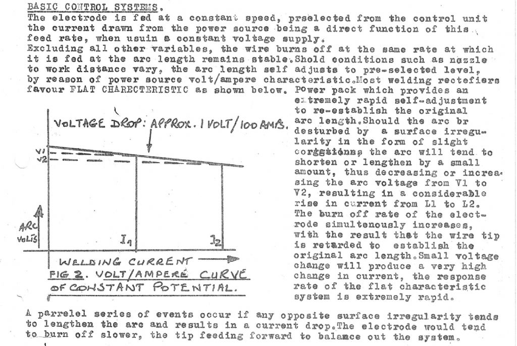

                Hi Robin, this scan may help you understand what happens to your arc.
                The characteristics of your stick welder are like this scan.
                Regards Nick.

                      Thanks for replies – especially for Joseph's and Nicholas' detailed explanations of what's going on. I think I now understand things better.

                      The main thing I was after was confirmation that the machine is meant to work in short circuit mode. I had incorrectly assumed that MIG machines were designed to maintain a constant arc length.
