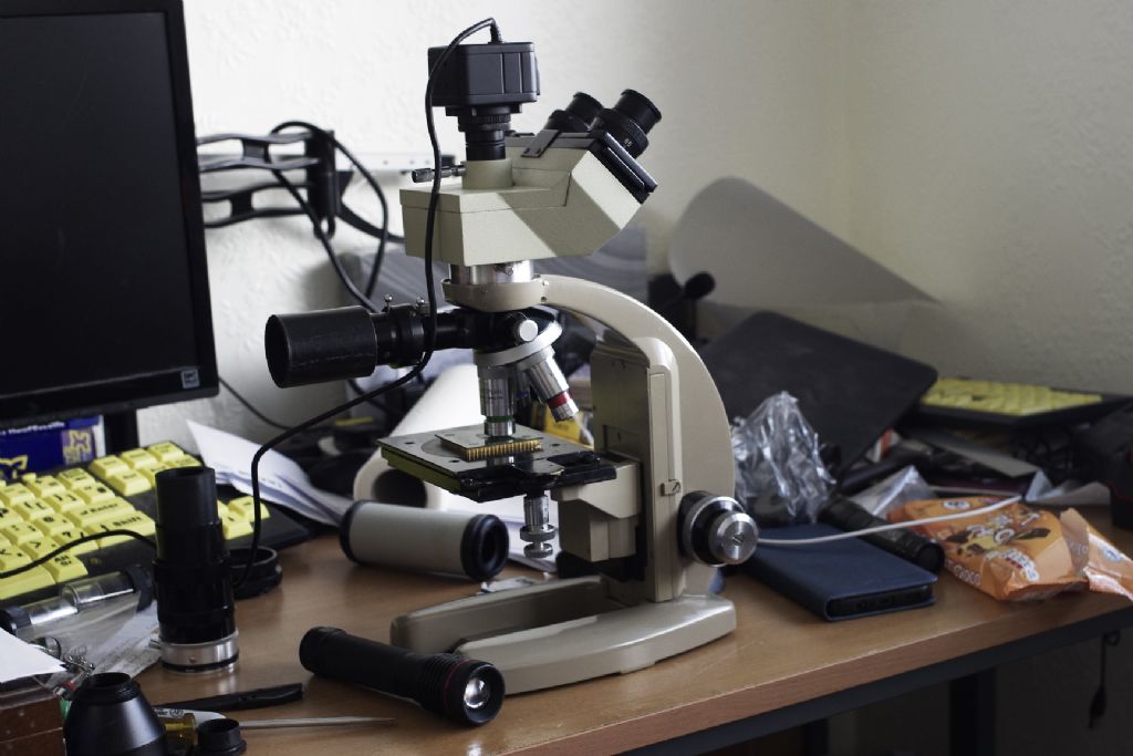

            Here's a pic of the microscope, with four NOS objectives, the total cost has come to £80. I had to get an adaptor made to fit the Lomo heads, monocular, binocular and the trinocular, shown, and the plastic adaptor for the 1W LED torch for the epi. The cheapo Chinese 5 Mp CCD would be better if I hadn't misplaced the driver disc. I believe that the iris diaphragms are adjustable, but hesitate to move them without some advice. The 20,40 and 100 have very little clearance when in use which makes the sprung noses very important. I would like to get an 80 dry LWD, but one of the Chinese ones on the market would cost twice my outlay so far. I have tried a Lomo 40 0.85 APO_igp3181.jpg biological objective and it is nothing like as good as the Vickers on this type of microscope.

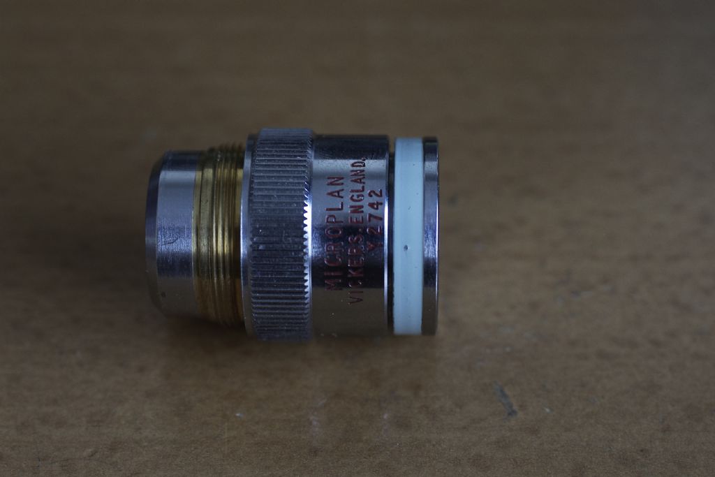

              Here is the Microplan 6 0.1 MET infinity objective, it is obvious why it needs extending from the turret.

                Thanks for the photos … Vickers ‘scopes of that vintage are very fine instruments yes
                Let me know what the camera is, and I may know of a driver to suit.
                I will be interested to know how that ‘infinity’ objective performs in an unfamiliar environment.
                P.S. __ it was actually detail pictures of the illuminator I wanted [in the hope of better-answering your question] … but I’m pleased to see the others.

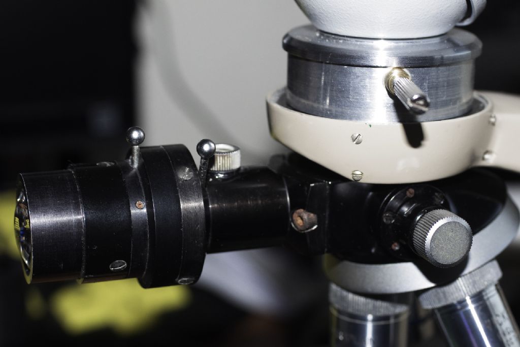

                  Here it is, the four position nose turret is integral. The two chrome levers are at the left end, the straight knurled knob next to the right lever slides about 5/16" axially moving a lens in the tube and the beam splitting mirror control is by the nosepiece. This is probably an early example as most I have seen are L shaped to save room. My test of the infinity 6X on this microscope had excellent results, and I was unable to fault it, maybe low power makes shortcomings harder to detect.

                    Still slightly confused about the illuminator and irises
                    … are you saying that they are are just misaligned, or is one [or both] sticky ?

                       I suspect that the irises are missaligned, free moving, but I don't know how they are intended to work.
