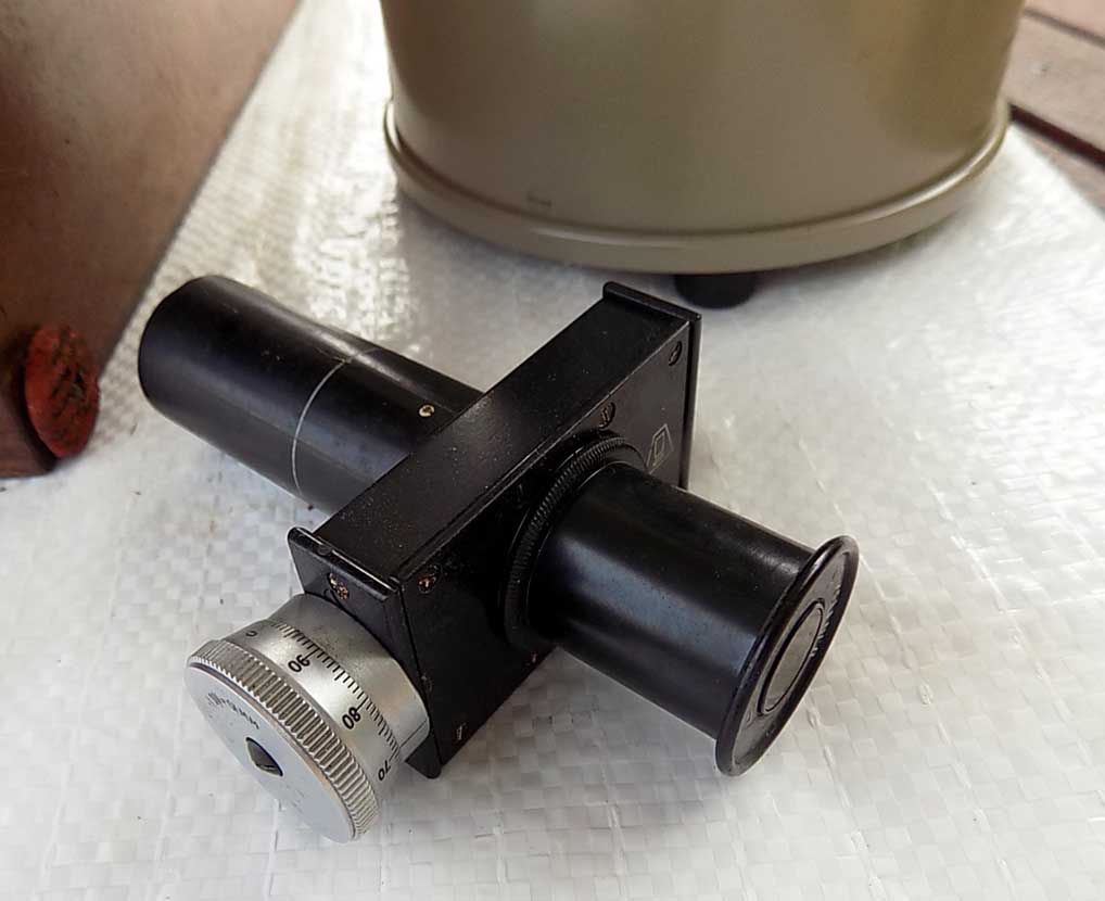

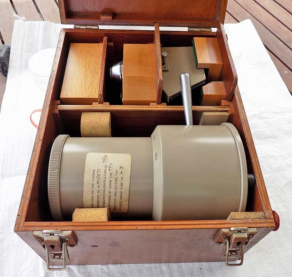

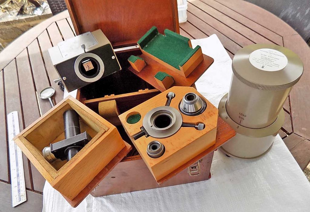

        Hi All,
        Todays delivery from my friendly local house clearance guy included this nice cased item.
        Something to do with a Vickers microscope, I would appreciate any info on how to describe this thing please.

          Hi there, Martin,
          I wonder if I shall beat Michael to the draw?!?
          Your kit is a hardness testing set. The cylindrical gizmo is a hydraulic (I think) indenter. The Vernier eyepiece is fitted to the (a? ) microscope and used to measure the diameter of the indentation. This is looked-up in Tables to translate to hardness.
          I guess it has to be hardness on the Vickers scale.

              I think its a micro hardness tester, for testing the hardness of specimens that will not take the higher indentation loads from the usual Vickers hardness tester. Thin strip and the like. From memory the loads were in grams for micro hardness and kilograms for macro tester.

                As John says it's is for micro-hardness. The diamond indenter is small enough to be able to select different phases in a metallographic specimen. The indenter is powered by air pressure via a press on plastic tube from the cylinder. I used to use one, bought new in the 1980s.

                      Incidentally; I think the very boxy looking binocular head in your first image belongs to an M55
                      Correction: The binocular head probably belonged to 'your'  M41
