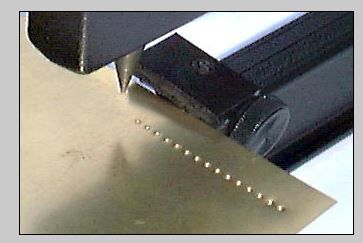

      Hi all
      Im in need of some tiny rivets, not for any structural use but for detail.
      Struggling to find any Any suggestions please ?

            If they not structural pins work. Just use retaining compound instead of peening the back ends.
            #590860
              What do you call "tiny"
              If pins are too large then a syringe and small blobs of glue are often use don scale R/C aircraft, or a punch and die set will cut small discs out of plasticard that can be stuck on

                      I am sure I have seen convincing tiddly rivets produced by using a blunt centre-punch at the back of the item, and on the other side, a sharp-edged hole. Best arranged, I guess in eg an old* bench drill with a mallet to knock on the top of the spindle.

                        It depends how small and in what material. For example 1/32" brass snaphead rivets are usually available from the usual ME suppliers.
                        Also, at a model engineering exhibition, I saw a 'system' for producing a riveted appearance for the smaller scale model locomotives (probably gauge 1). A thin brass plate would be 'pressed' on its rear side and a snap head rivet appearance would show on the front. Forgive me but I don't have a suggested supplier but it might remind somebody who does know or has also seen the system.

                          You two are probably thinking of a rivit embossing tool which work well on thin stock
                          I've done similar just making a punch and die, head on these is about 1/2" dia

                            I would imagine the method is not dissimilar but no – my memory was a 'system' for forming the rivet appearance on say a locomotive tender or a running board. Features that have say 30 or 40 rivets in a straight line and it was meant for the smaller gauge model locomotives. So you can probably imagine that the dimples really would be tiny.
                            I am struggling to remember how it worked in detail but I remember the strips of thin brass would be guided along a straight edge whilst the punch/ press produced the tiny dimples. You can imagine that it also had a means of moving the sheet along by a specified amount so the dimples would be evenly spaced. They had bits of sample brass on the bench with the dimples already formed. I am sure it would have been the Midlands or Alexanders Palace in London in about 2012.

                              you are possibly recalling the GW Models rivet press. It includes a table moved by a metric screw for regular straight-line embossed rivet patterns.

                                Phil that one I linked to goes down to 0.4mm rivit heads, said to be suitable for 00/HO scale which would suggest a shank of 0.2mm dia if they were real rivits which I would class as quite small.
                                It does say there is an adjustment for spacing so assume you can set that to get regular placement of the dummy rivit. Photo shows a row of 20 or so rivits in thin brass sheet.
                                There is also the tool that Gerald Wingrove used which has the punch and die as rollers
