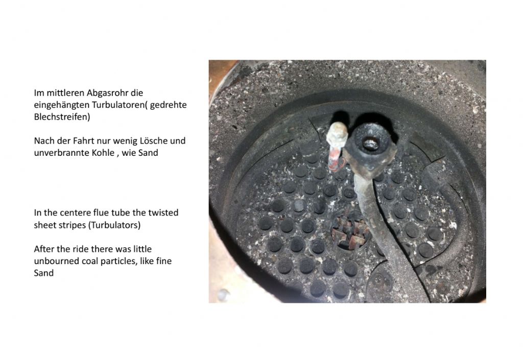

                  Hello , there is an update of my activities.
                  In a german steam forum there was an advice to use  a turbulator ,if you do not have installed a overheater pipe in the boiler. The turbulator give some friction for the heated air stream and a better heat transfer to the boiler pipe.
                  And a basic effect is to equal the heat over all available pipes. So the boiler effiency is better. That is the theory behind. In the first step i made one 20 mm wide steel stripe and twisted it as possible. That was not very good makeable. So I cut some fins out and twist them.
                  With this setup I drove with my friends in September at our Club track at the DBC Rhine Main.
                  There was a subjective impression that there is a slight improvement in steaming. The tests were made in the range of 18°C .
                  Please look from start or from 7.20 for road steam

                  This four metal stripes are hanging in the overheater pipe. They work as spark arrestors and the function is as described in the beginning.
                  On our last steaming day in this year, I made a test with this setup. It was cold 6 to 7 degrees and very windy. It takes a long time to get steam , but then I was surprised. During driving I had a lot of steam .In many cases the safety valve was constant blowing and only by water pumping the pressure came down. All drivers had the feeling with the cold temperatures the need a lot more water. The performance was better then in conditions over 20°C. I was able to hold the pressure during full speed and water pumping. The only thing the pressure came down , I was not able to put coal in during fast driving.
                  To give you an impression please look the video.

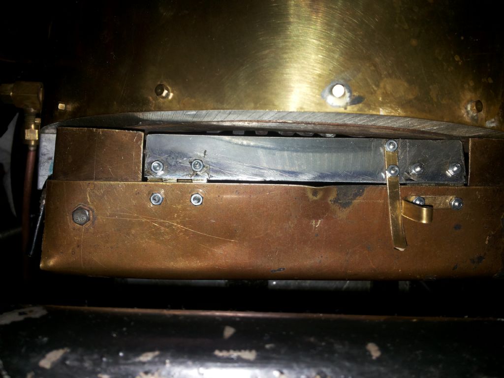

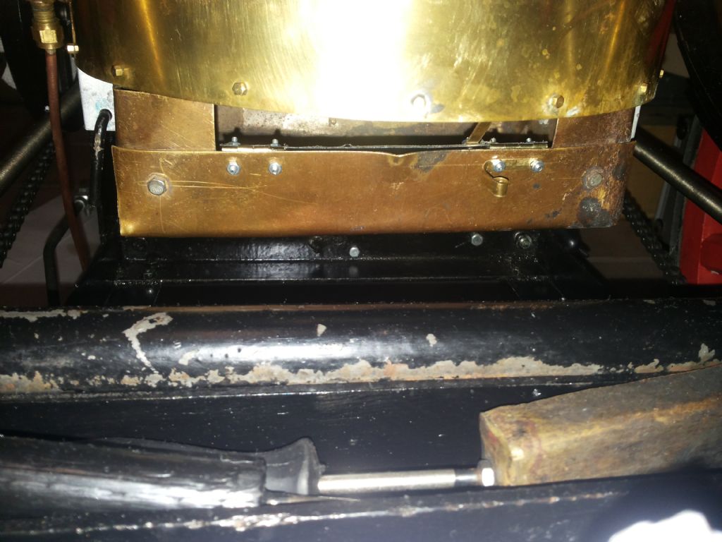

                  For next year I have to add air doors at my ashpan and grate area.
                  If there is someone who have experience please share some thoughts.

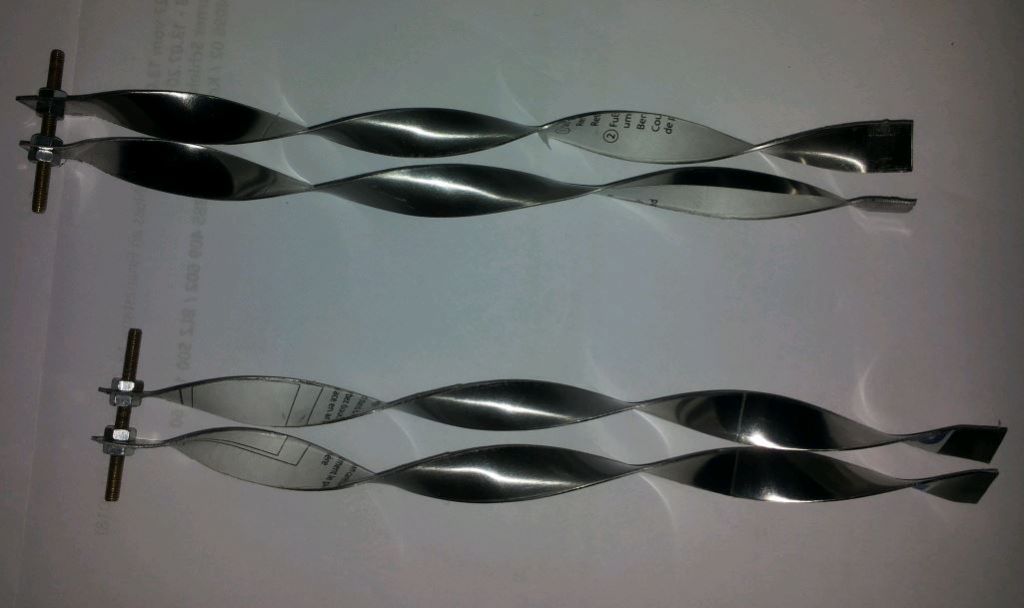

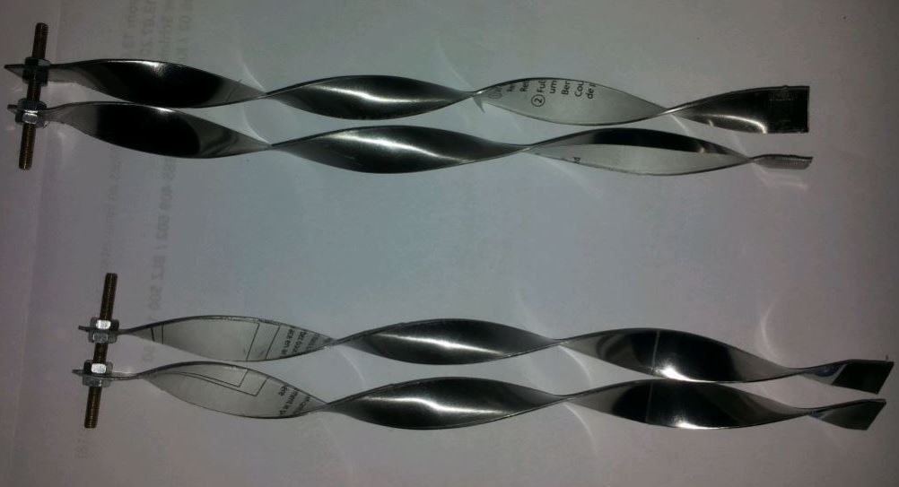

                        During winter time I made some cleaning activities and I had to rework and improve the joint to my crankshaft.
                        The forces from the cylinder to the crankshaft I had underated. The oscillating force lead to a weak conection.
                        The fireking was running in two years 80 km .
                        On the last ride last year I had such a good fire after installing the turbulator device I decided to test fire damper doors for better controlling the fire with less blow off from the safety valves.
                        Here are picture s open and closed . I hope that work as it is intended.
                        I will try to measure the difference with a thermo probe and I hope the effect is as I wanted it.

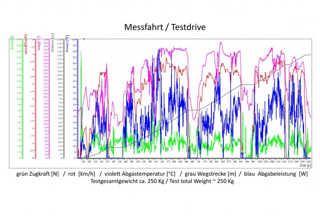

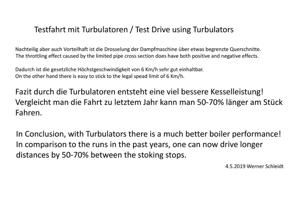

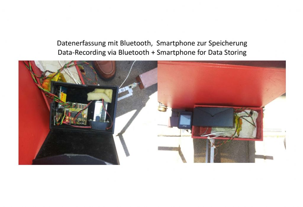

                                  on a nice easter sunday I made a test ride with my fire king to see how the turbulator work.
                                  Last year in october I saw the performance and made the subjectiv rating that it is a remarkable improvement.
                                  The added turbulator in the center flue tube.

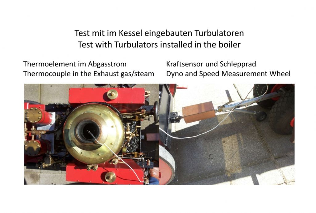

                                  This time I added measurement equipment to see the exhaust temperature, the pulling force and the speed.
                                  I recorded this by my own software via bluetooth with a smartphone.

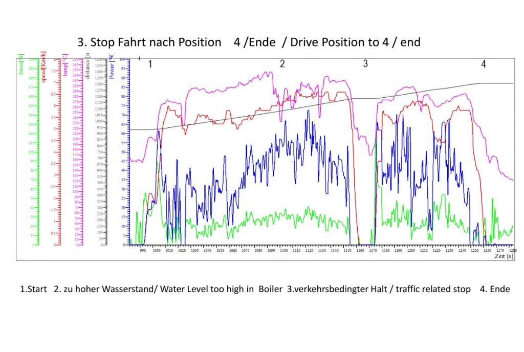

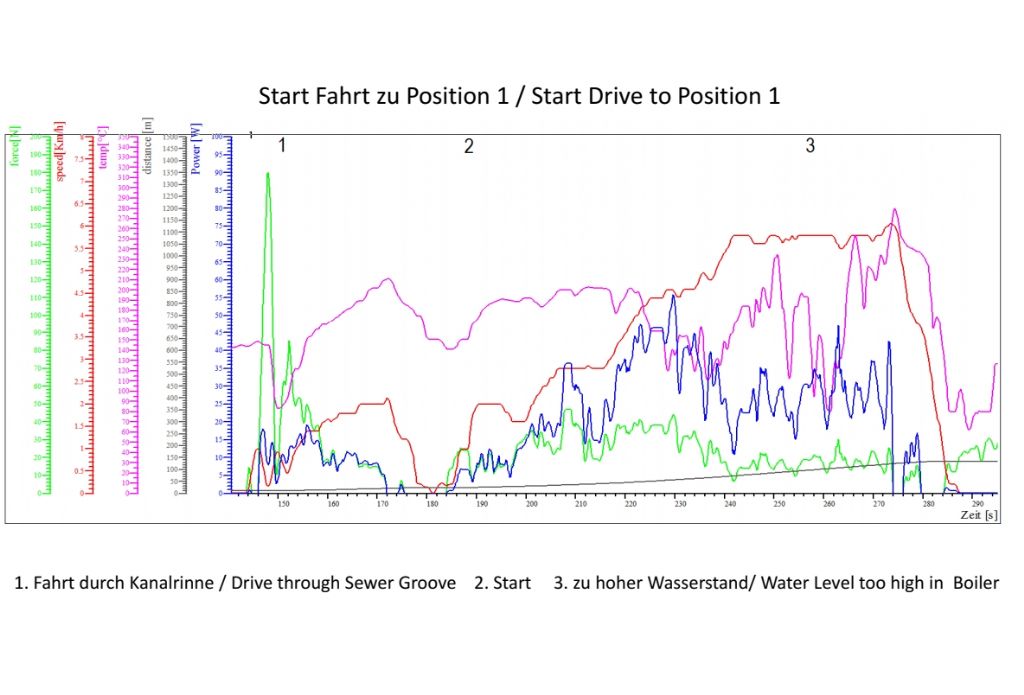

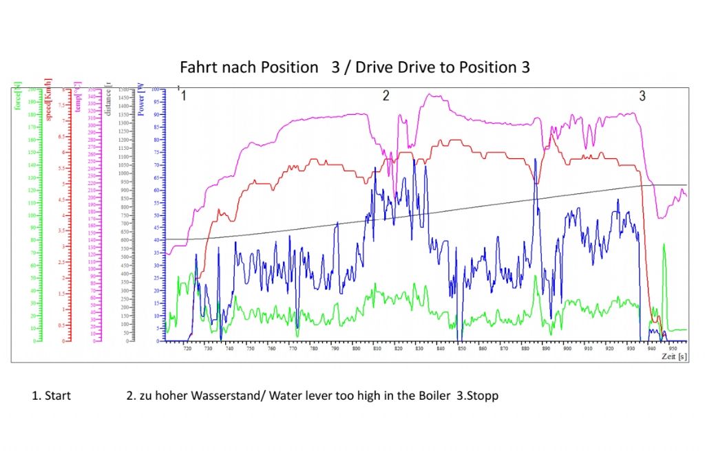

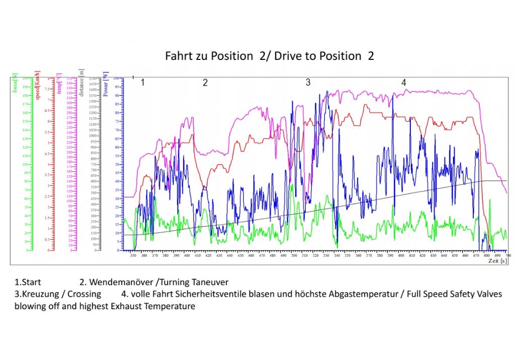

                                  The colours are green the pulling force max 200 N, red the sppeed max 8 Km/h, violet the exhaust emperaturemax 350 °C, the calculatet distance in grey max 1500 m and blue the calculated power max 100 W
                                  To show the measurement more in detail I devided it in parts. And marked the parts in a road map.
                                  The fllowing diagrams are related to the parts marked in the map.
                                  The ride over the pedestrian way into the street there was a peak force of 180 N . In 2 the journey starts.
                                  The violet down peaks are related to the cold steam engine and a high waterlevel.
                                  At Position 2 I filled the grate with coal nearly to the fire door. And then I start driving. In 3 I had to look to traffic and slow down a little. And then I was in full motion the boiler had lots of power an nearly constant 330 °C exhaust temperature and I was able to hold the speed legal speed of 6 km/h.
                                  The same I made at position 2 I filled the boiler grate with coal and looked to the oil pump.
                                  In 3 on my way back home I had to wait and made a traffic related stop. On my way the safety valve blew very often and I tried to pump water to come down with the pressure. I drove the round as fast as possible to see what happens.

                                  With this fast driving there is not much unbourned coal int the smokebox. With a vaccum cleaner it was an easy job to clean.
                                  For me it was a great success to see how the fire king performs now. There were some little drawbacks . I forgot to weight the coal ,it was about 3 Kg and 14 liter water. The powersupply of my measurement equipment was only good for one round. The wiring of the sensors to the recorder have to be improved.

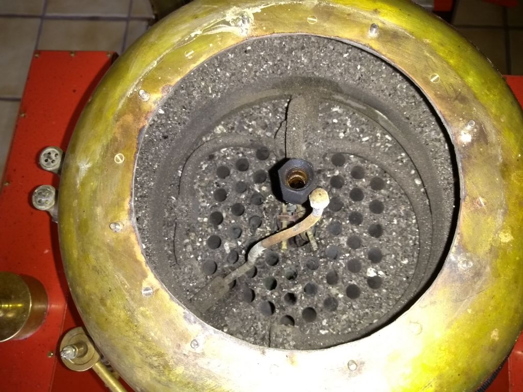

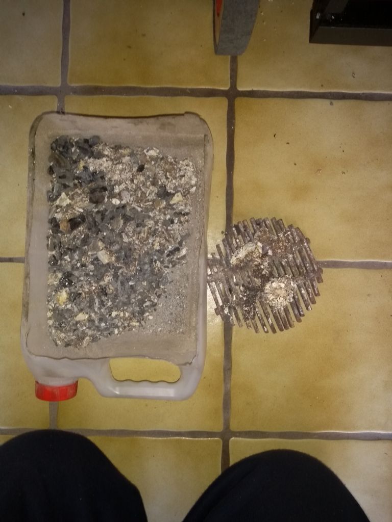

                                                      I made a picture of the smoke box area. There was very less material after this long run. It was like grey and black sand.
                                                      The widen up of the nozzle as it was  identifyed in my measurements last year, was the right decision!
                                                      the grate
                                                      The grate had some clinker as rocks and some other loose material.
                                                      My questions is , if I was able to fire more constant , was it possible to avoid this?
                                                      Or is it normal after such a run of that lenght of driving ?
