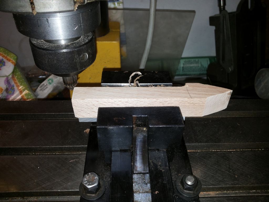

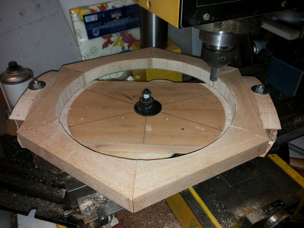

              Hello ,

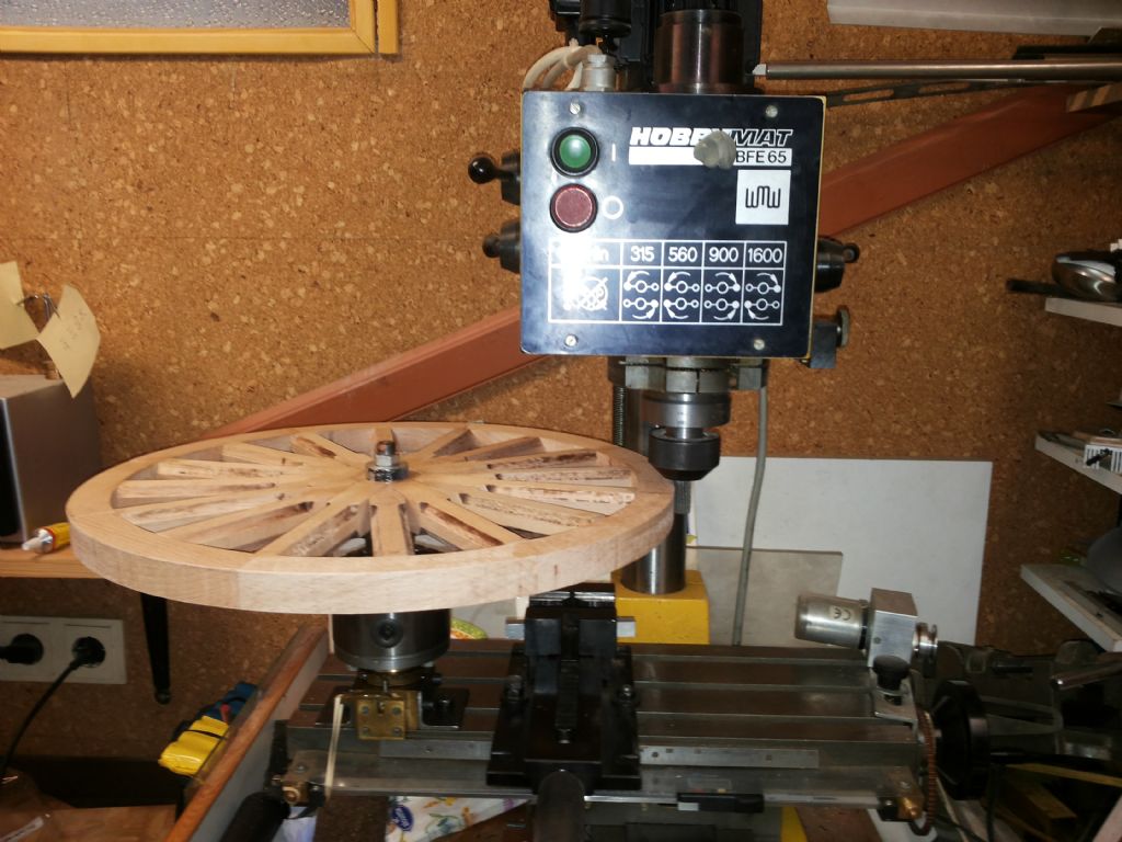

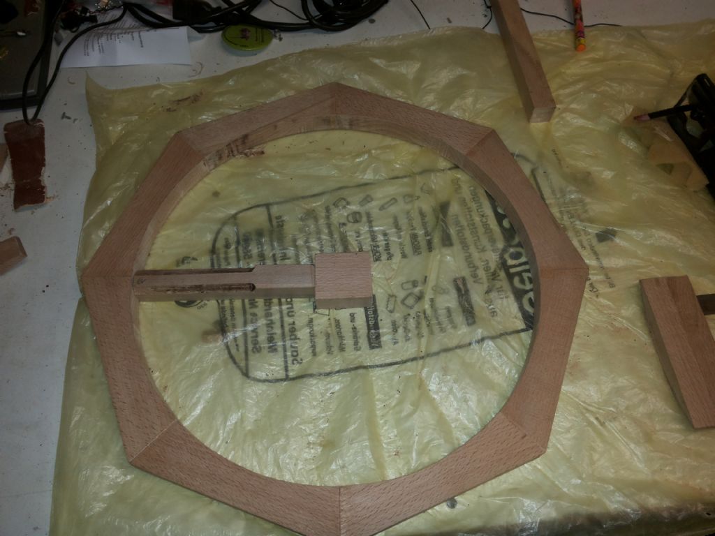

              I continue with the wheel construction.
              the spokes are milled on the edges
              The ring was turned on a mill, the beech wood was very hard
              The ring was turned by hand
              Now one wheel is ready clued together with with white wood glue and get his outside trim. It was not easy to get the same diameter for two wheels under this primitve circumstance.

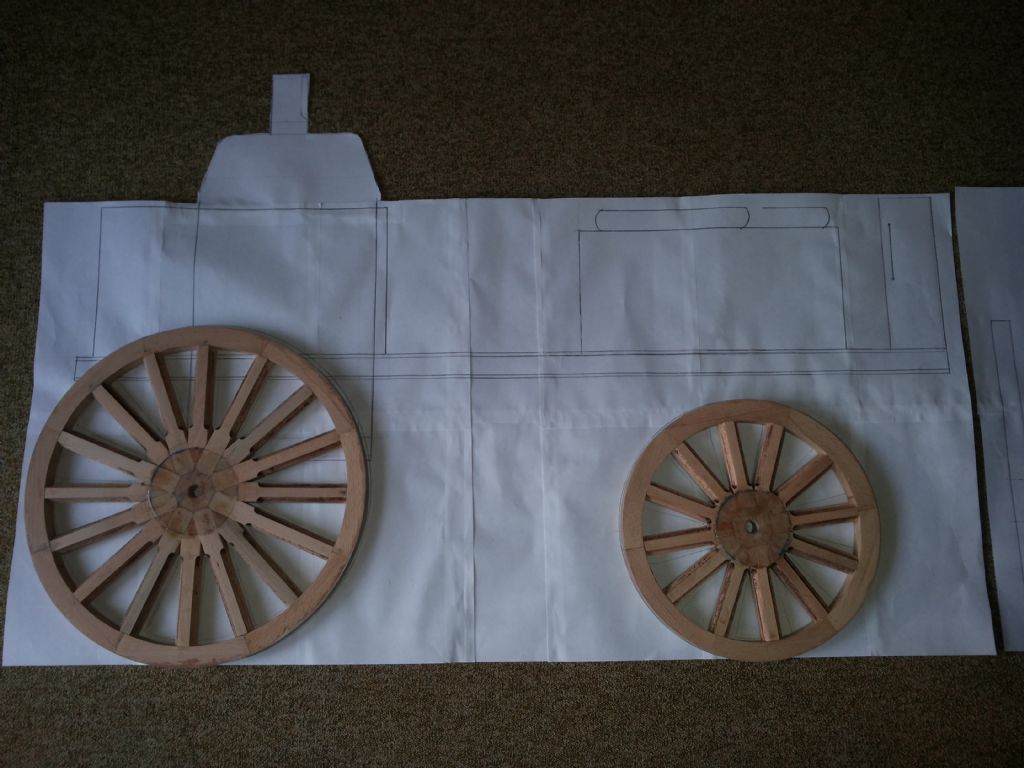

              After the wheels were ready, a drawing was made to the best fit of the old picture of the fire king and the size
              of the boiler . And I had a look to my transport capabilities.

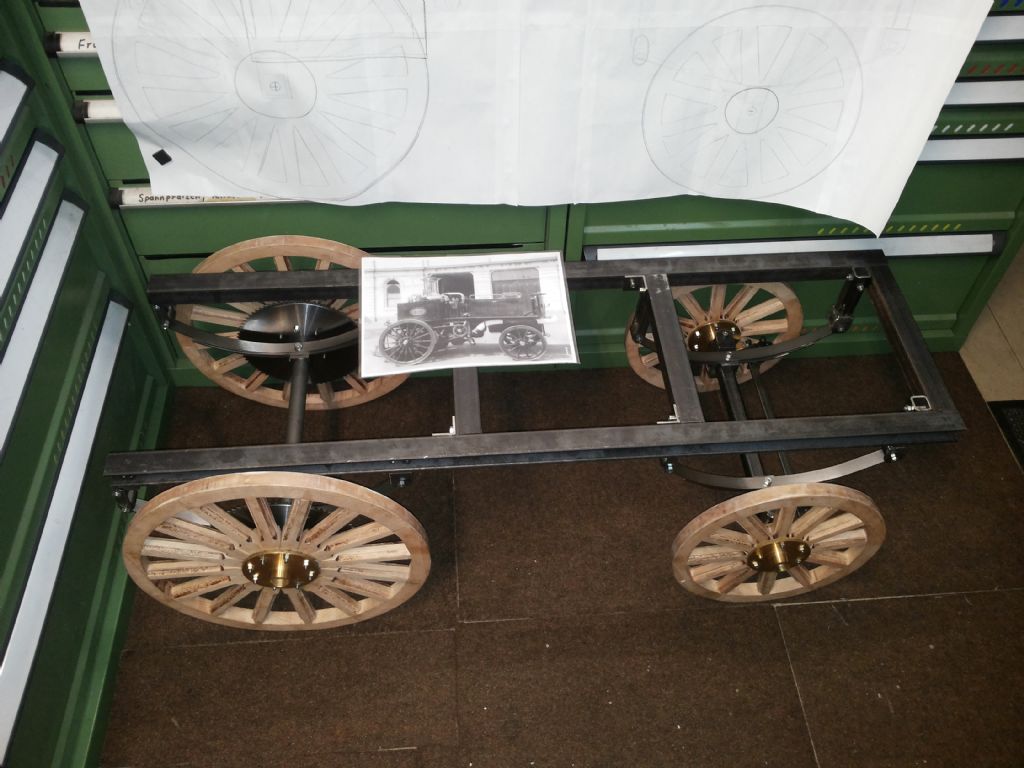

                  After the overall drawing I start with ordering of material for the wheel attachments and for the frame and spring attachments .
                  After some months it look like this

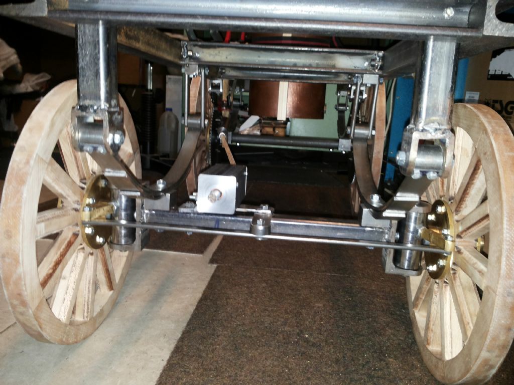

                  Next step was building the steering gear.
                  It is on the left side on the front axle. It is made from trapezoid spindle with a gunmetal nut. On the nut there is
                  attached a pin with a screw in the middle of the nut and this is sliding in a slot in the housing.
                  The whole is than connected to a L lever with connection to the track bar and the tie rods. The setup is like
                  Lankensberger (munich coach builder) or better known as Ackermann setup.

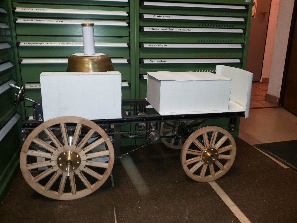

                  with some cardboard I was dreaming how it can look if it is ready that was in summer 2015
                  For my opinion such cardboard prototypes are extrem helpful to get the right dimensions.Please keep in mind I have only old photos and no sketch of it.

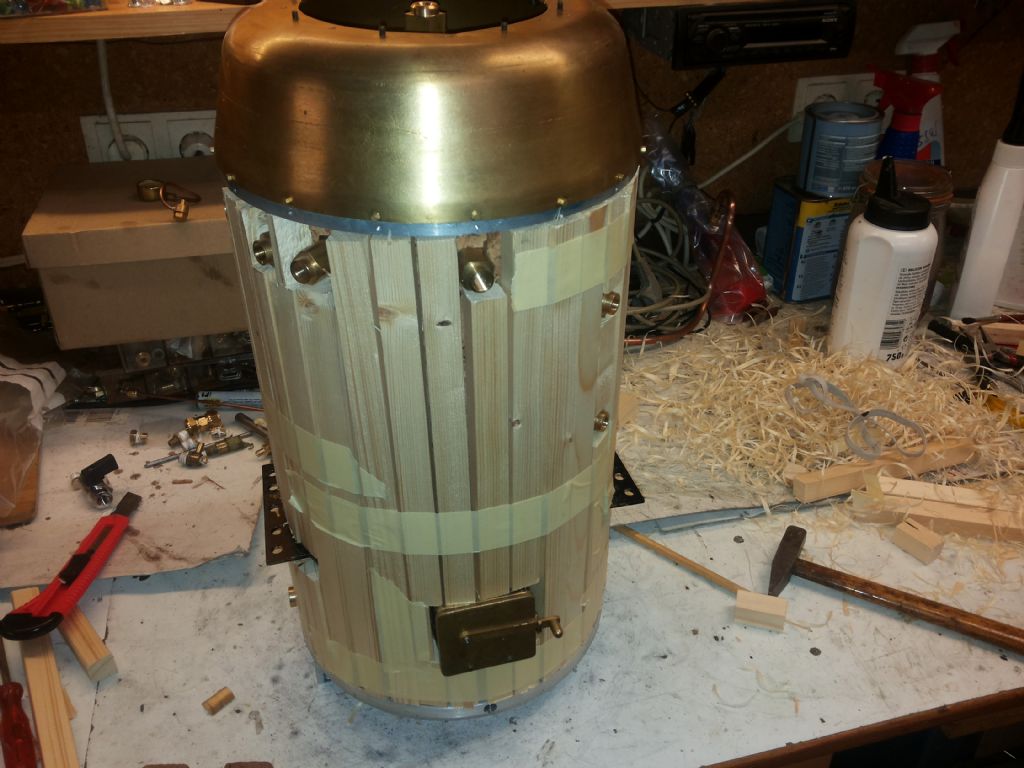

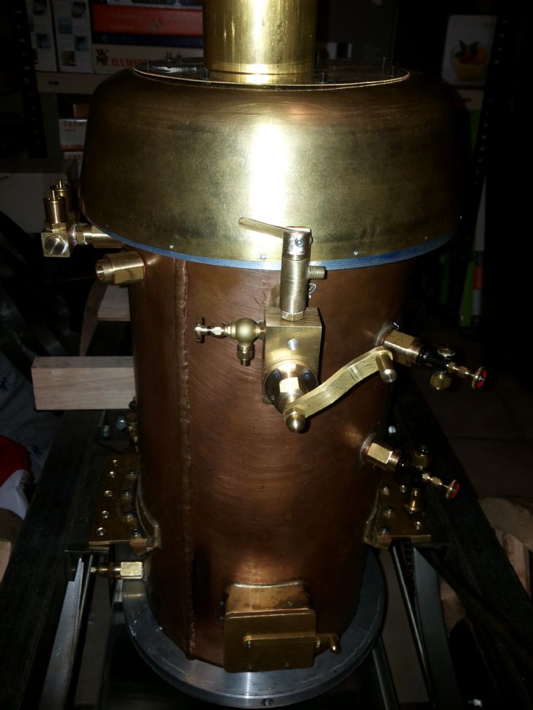

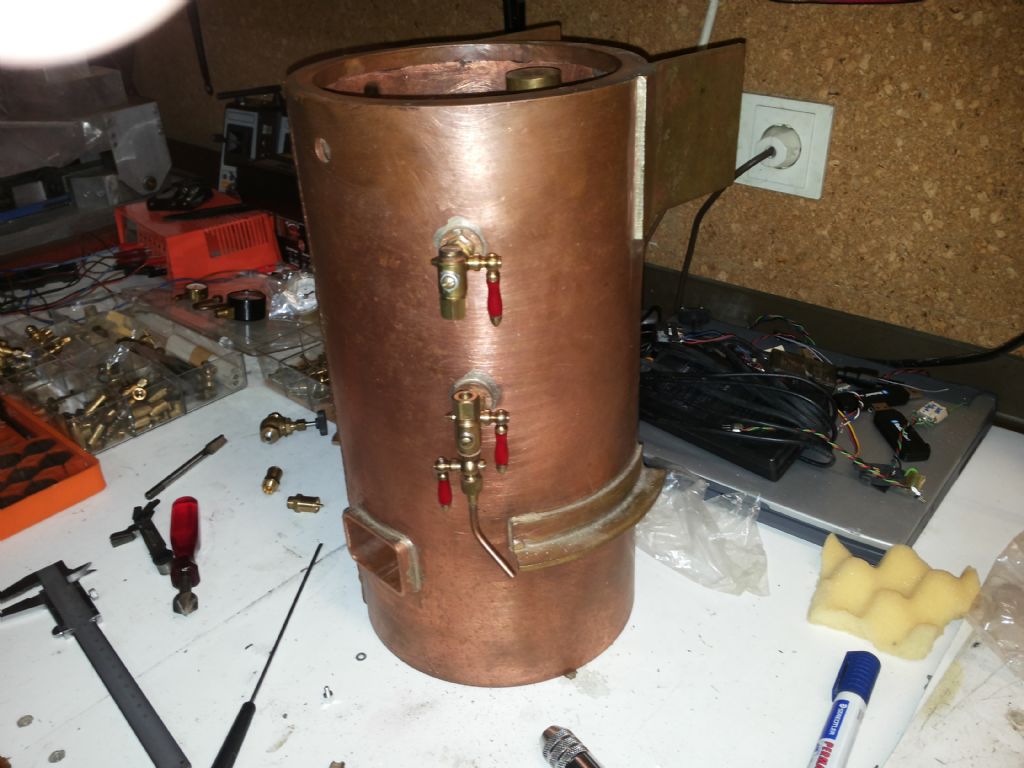

                  Next step the tea pot locomotive boiler lost the heat transfer sheet metal. It was not easy cutting and milling it away with my small mill.
                  some steps are worked in parallel the discription is one after the other.
                  The brass top of the boiler was not easy to get. Such pots are today only in stainless steel to get ,but by chance I saw in.bay a brass flower pot very cheap and with the stones  in the house wall I had an idea how big it is.
                  In former times it was a pot from a sugar baker and then degradated to a flower pot. I cut the handles away and cut the upper side for the chimney. And I tried to buckling and finishing the old stuff. It looked not so bad but it was still in a conical shape. With three rolls ,all conical , two on the bed of the mill and one upside down in the bore head ,I tried to bend 10 milimeters from the downside to a cylindrical shape. That went good after some hours of work. And some hammering with a plastic hammer.
                  the working parts for the bolier and the adapter to come out of the insulation was made.
                  The fire door attachment was very difficult and made in several hours .It opens to floor direction ,because I think it is better to operate like this during driving.

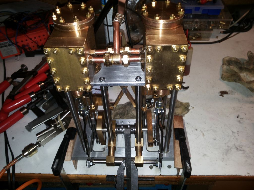

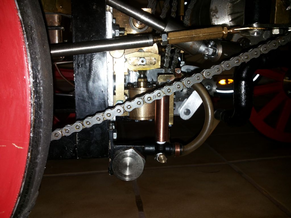

                    the next big step was the steam engine. I had no experience how big it have to be and what traction effort is needed by road driving.
                    So my son and I made a test with grandmother s walking frame. I take seat and my son pulled with a luggage scale. The pulling force was in minimum 100 N. From traction engine coleage I know that he pulled on first gear a small car. So I ball park 500 N.
                    Then I calculated the gear ratio of my chain drives and added a two speed gear to the setup. In second gear the steam engine should run 500 rpm .With all these calculations and some rule of thumb I came to 42 mm bore and 60 to 70 mm stroke on the engine and a overall gear of 8 to 1. So I hoped with this setup I am in the 6 Km/h rule in germany and enough power to drive with two adults.
                    By chance I saw in the second hand area of Maxitrak Cylinder with piston bore ready but all other stuff I made by my self. In eastern 2016 the engine runs.
                    In summer I saw some rust on the steel parts, so it was clear I have to paint.
                    Before I tried to get all ready for the paint job.
                    The next picture is befor painting.
                    That was lot of work to do.

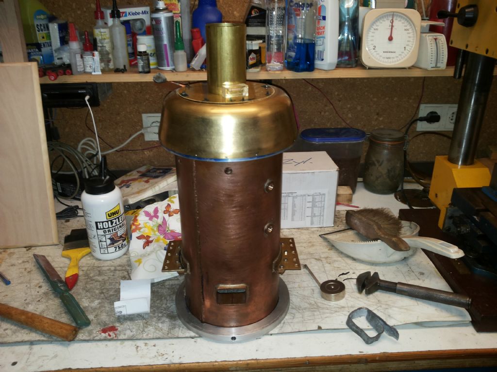

                          The boiler insulating is a time intensive job ,but this was nothing in the comparison of boring and making the M2 threads in aluminum. I had the feeling it was hundreds to bore and making the threads.
                          The boiler cover in brass was very difficult to made . The bending and rolling of the sheet was made by hand..
                          A template was made from cardboard the bores for the inputs and outputs were very difficult to transfer. And I learned that a round bore is eliptic on a bended metal cover. After that work with bending and rolling the sheet metal by hand I had pain in my hands.

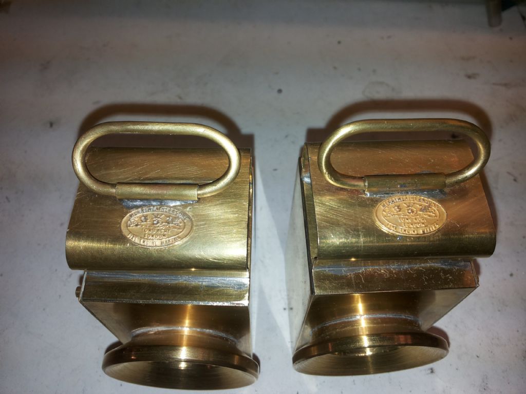

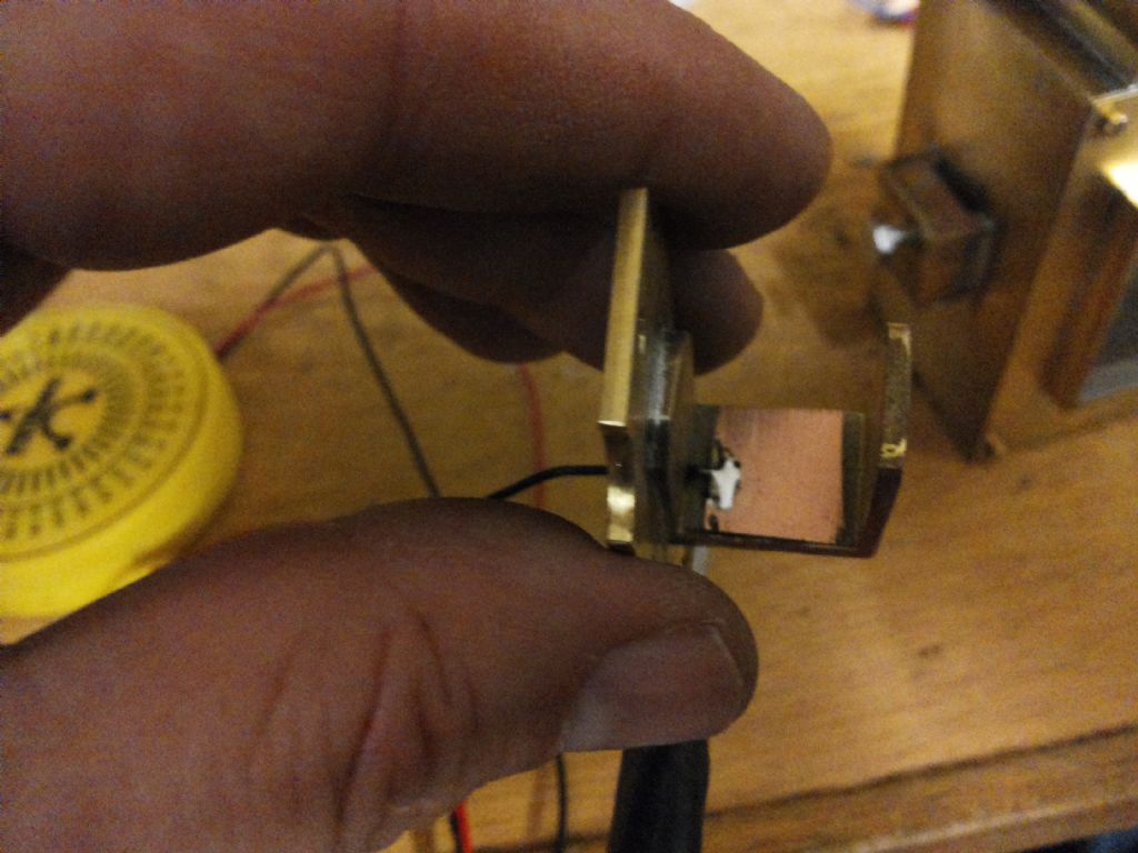

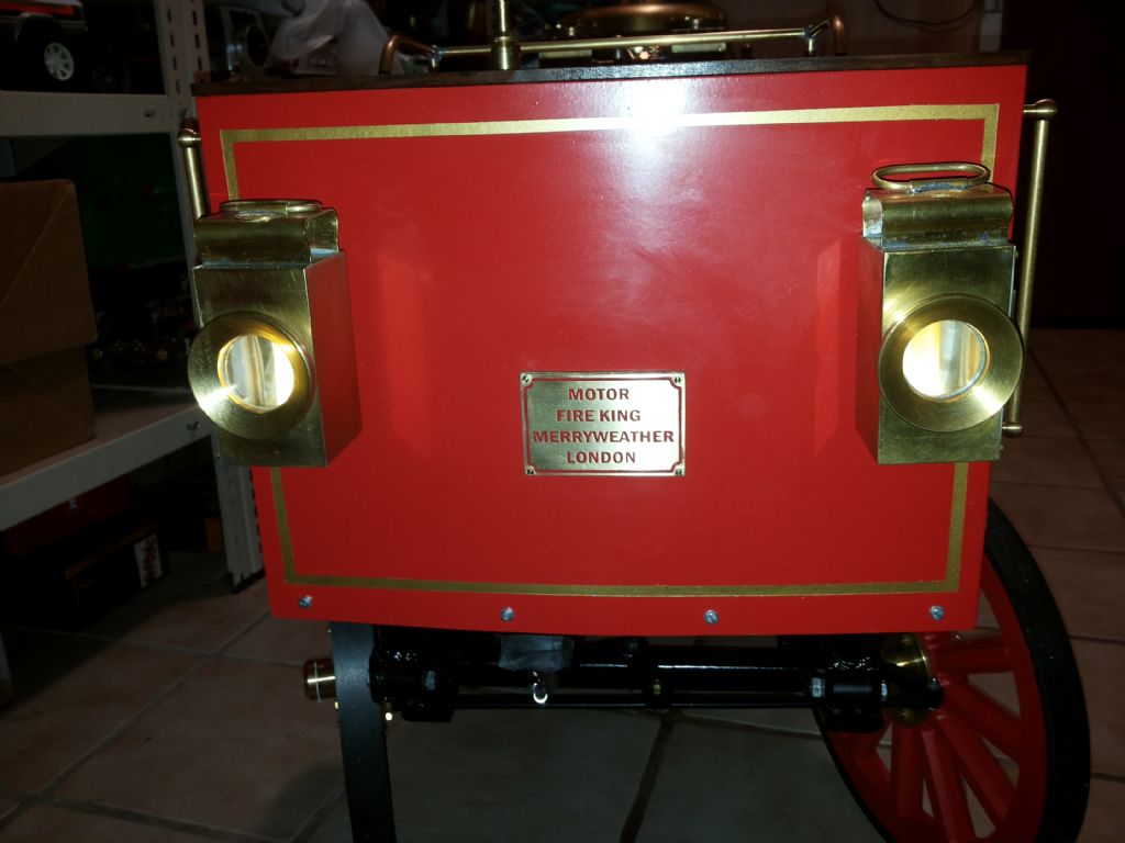

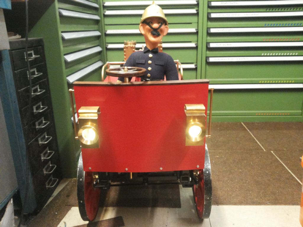

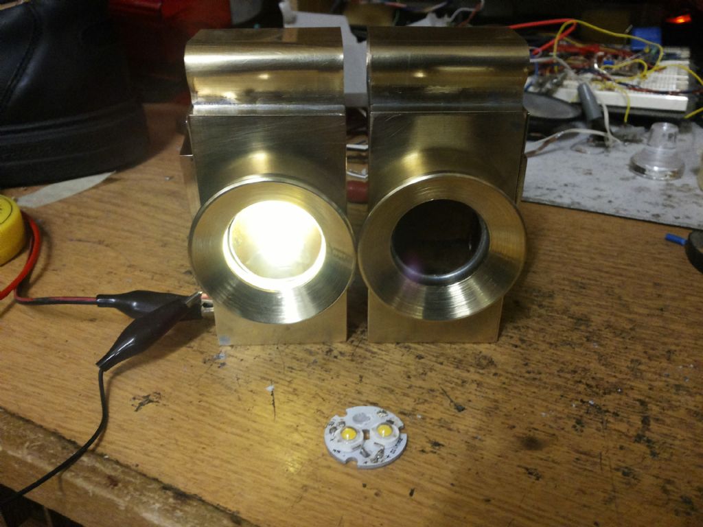

                            Some time in between i build some parts like the front lamps. It was hard to decide which form I have to build ,because the original I had in my pictures are adapted several times with different lamps.
                            The technical change from oil to gas lamps forced other look of the lamps.
                            At first I made quick and dirty a cardboard lamp and found it is to big, then I made a sketch for the right lamp.
                            It was decided that the lamps in the model are iluminated by LED.

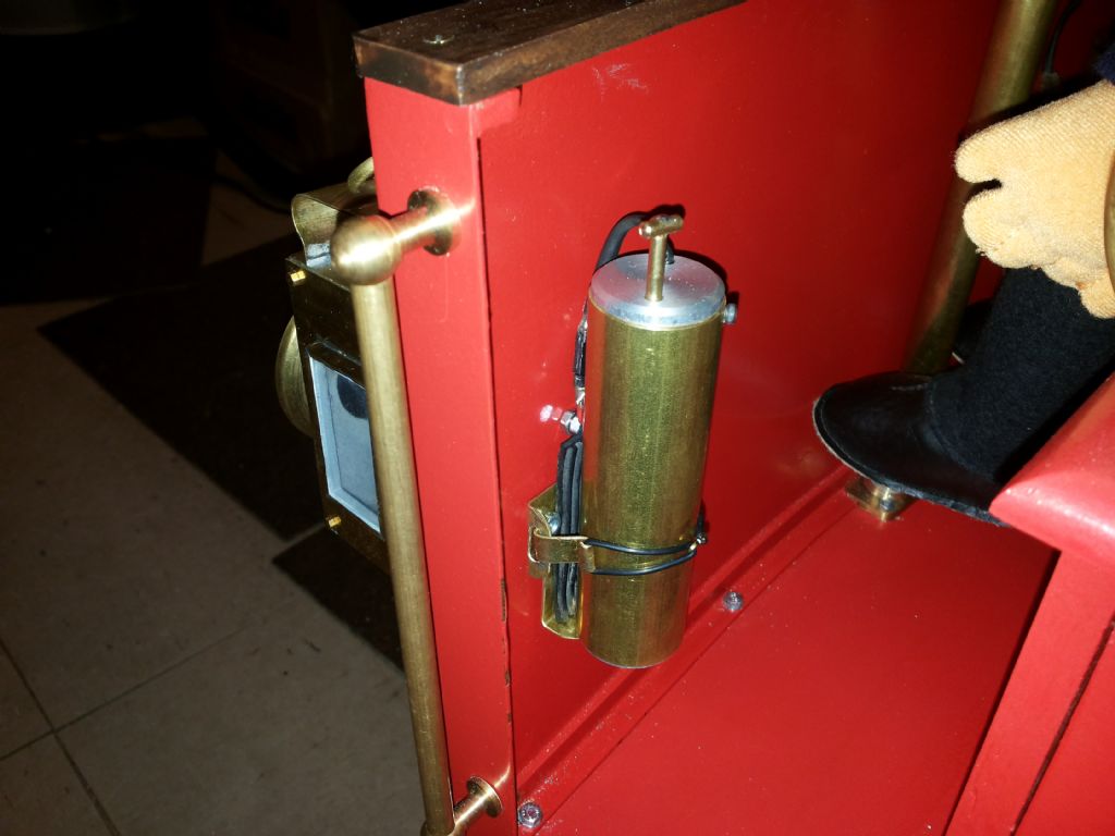

                            From a colleage I got a defect LED lamp after stripping I found that the voltage and current control chip was defective. The LED s were very well. I made than several tries to find a solution that they look similar to a petrol powered one.
                            After I found a solution for "the burner" I decided to make a battery holder like a fireextinguisher for 3 AA cells.On the top the handle is the power switch. And I have to found a solution for easy connection of the power lines.
                            The picture shows the holder and power connector.
                            Here is the battery holder and the handle is the switch.
                            And here are the lamps installed.
                            The firefighter was a special addition for the company Ziegler a german fire truck builder and is made by Steiff dolls.

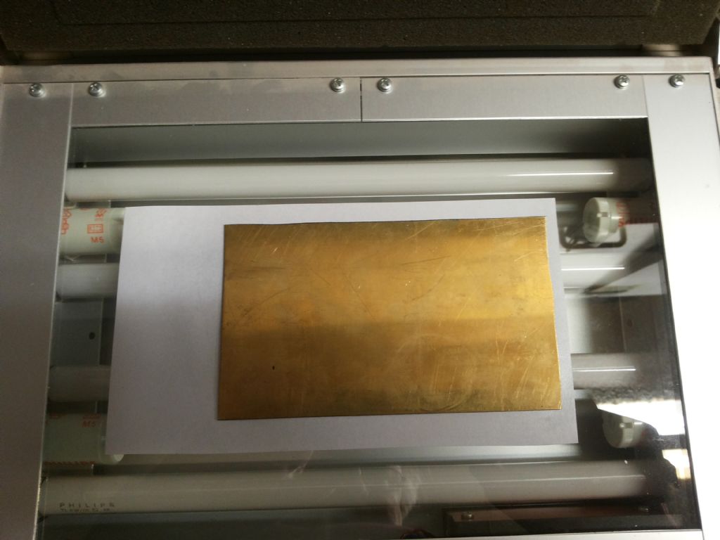

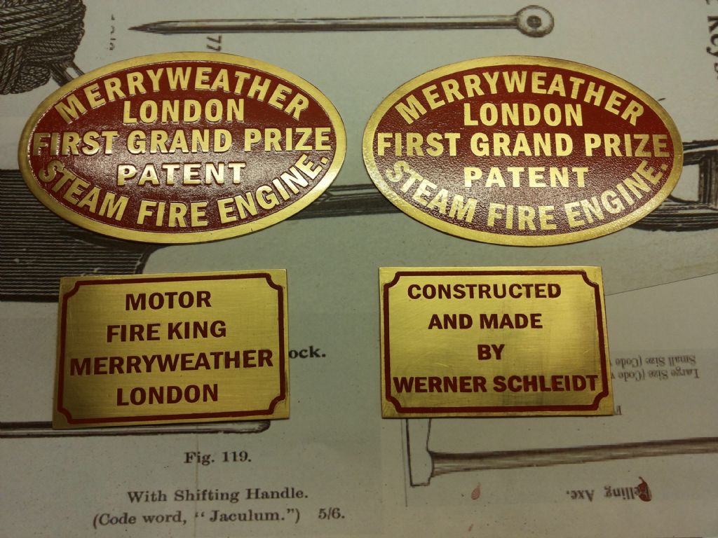

                            The next work intensiv step was doing the plate work.

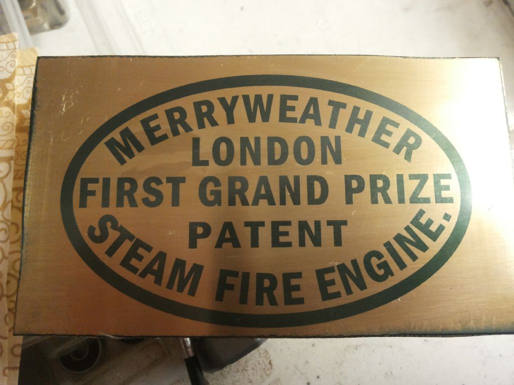

                            I was looking for Merryweather plate which are in the same time on the originals.
                            With the free program inscape it was possible to make and overlay from the original and the new sketch.After a good fit it allowed to separate again sketch and picture.
                            The used technic is the same as etching printed circuit boards , but you need much more time and new acid to get 0,25 mm deepness for the letters.
                            The brass is covered with a photoresistant paint. It is not easy to clean the brass and make a clean job.
                            After one day of driying it was 5 minute developed with ultra violet light by special light tubes.
                            Here is the developed plate with photoresitant.
                            In this improvised etching box with heating and air bubbles it was made.
                            After some days of work I got this result. The left plate is very good the right Mw. plate is not deep enough etched. My acid was not good anymore. I have to have a new one.
                            The lamps get their small plates as big as thumb nail
                            and the fire extinguisher

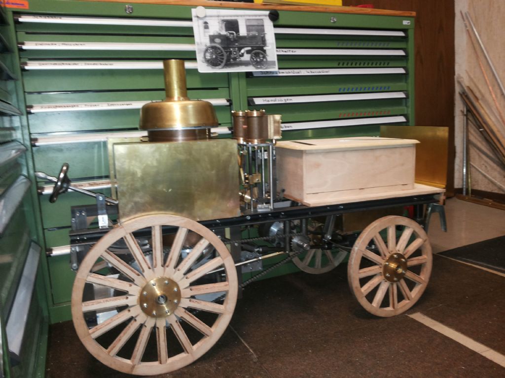

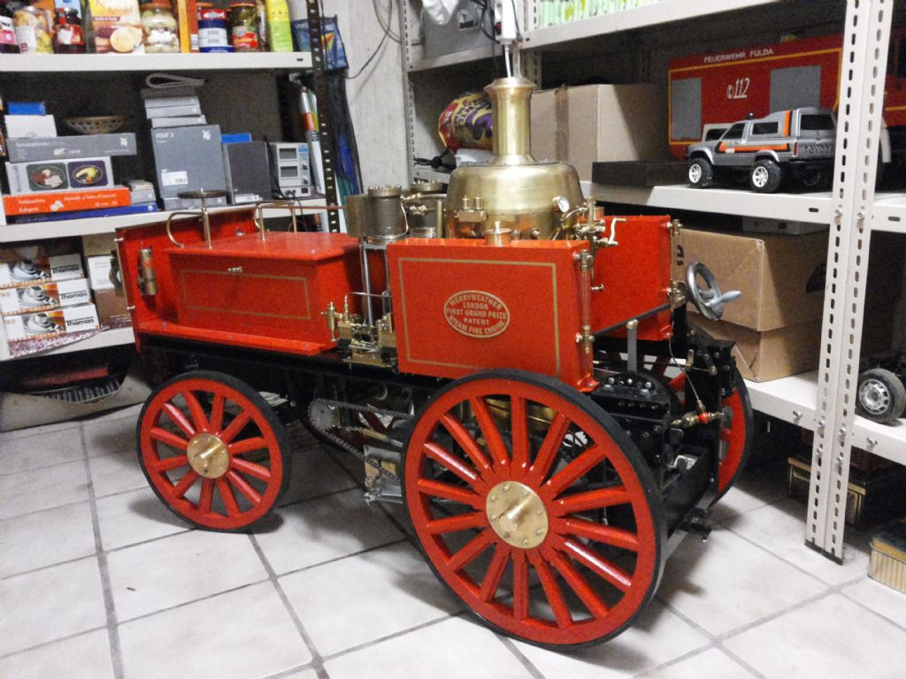

                              I describe now the next steps. The wheels were covered with rubber.
                              The pipe work was done with check valve ,bypass valves and so on.

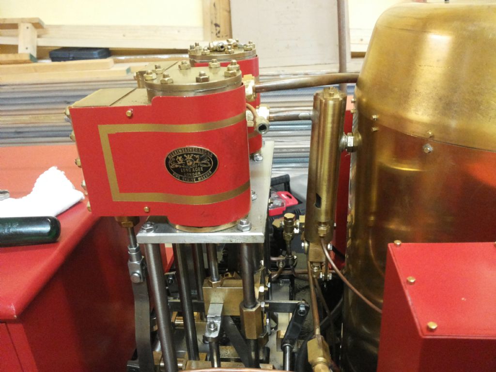

                              The plates were fitted. The watertank and the front box get theire golden lines.
                              And email conversation was made with the hungerford virtual museum, merryweather and sons to find out what was in the box under the driver seat,because I had found no pictures of that stuff. I got some information material and I made my interpretation of it.

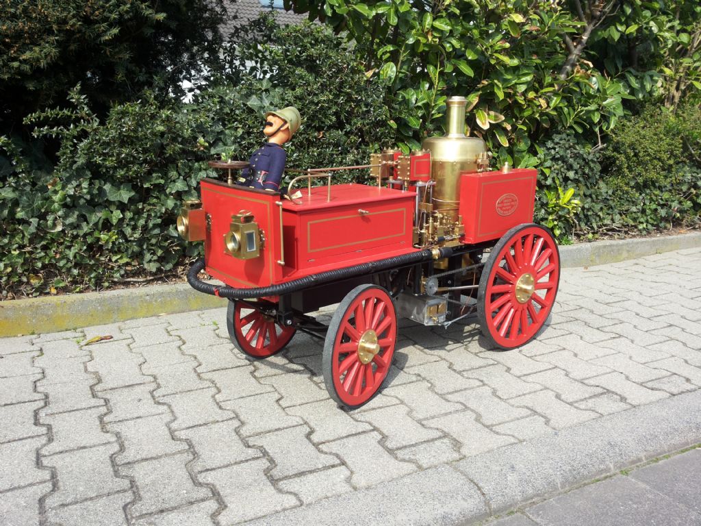

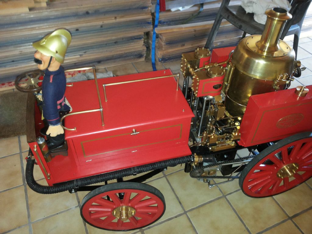

                              The first time out of the basement . We pulled it out with an electrical winch carefully over the stairs.20170401_142250.jpg
                              The black suction hose on the front is a standard suction hose for a gardenpump.It looked terrible like plastic. The idea came up to wrap around a mull bandage and paint it black. Now it looks like a suction hose.
                              More pictures and step by step you can see in my video.
                              I hope you can enjoy the video.
                              Werner

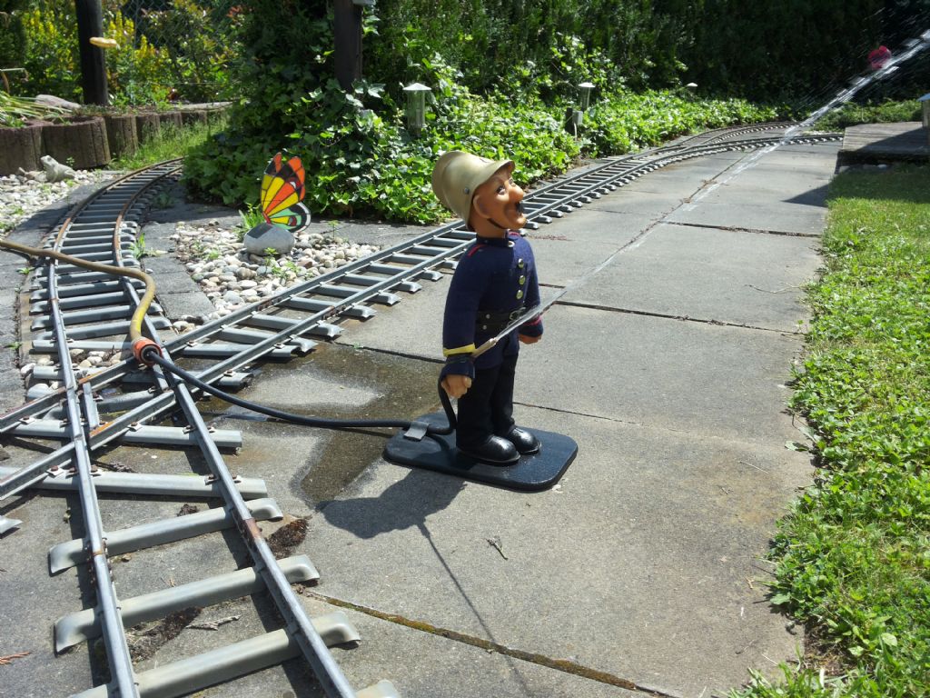

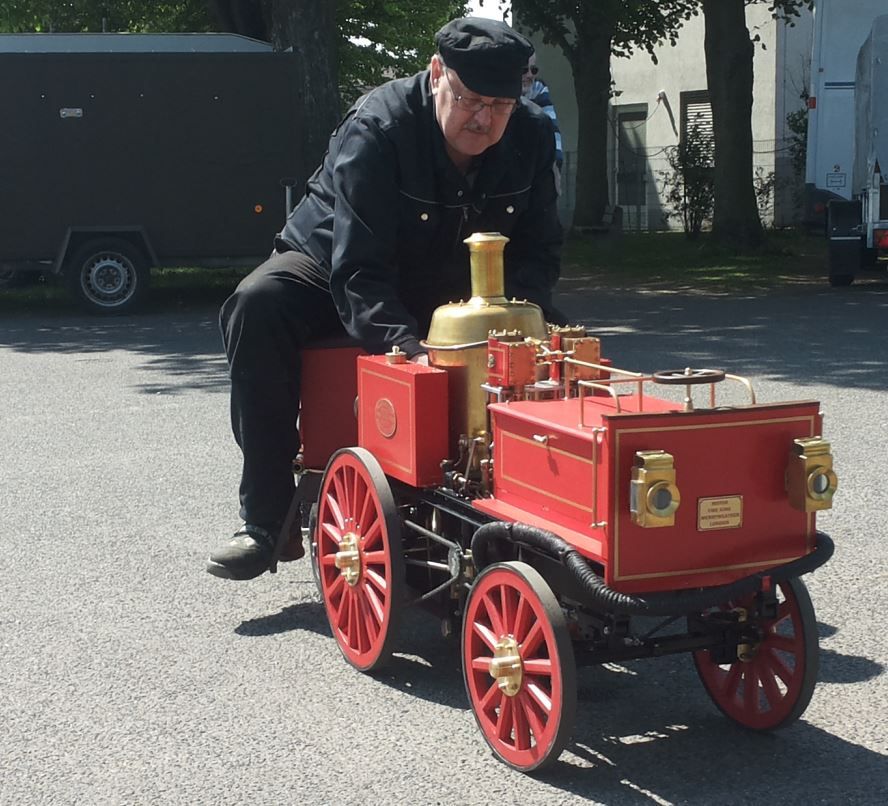

                                    On the second test ride I found that the fire water pump is not able to get water from the suction hose.
                                    I was frustrated ,but never give up. So I investigated what is the the problem.I made a setup in my garage and put the boiler under air pressure. So I could run all for testing. After several test I found out that my compression gland is not suction tight. And I decided that I use only one water cylinder, because it was very difficult to get them out ,because the boiler is very close and it was difficult to come to the screws.
                                    After that I tried the pump again and it worked. Than I regognized with the water pressure it can build, that my flat hose is not thight. With several steps I got it under control. Than I made a special nozzle adapted to the flow the pump can bring. Here my experience making injector nozzles were very helpful.
                                    In normal working condition it can spray 5 to 6 meters wide. But I found that the ports to the check valves were very small. I started to rework one cylinder to get more flow and less back pressure, but this is not ready now.
                                    On a very hot second driving day on our club track I gave the fire king a 3. test ride.
                                    The test target was to found out how far I can drive with which amount of coal and how stable is the mechanical system. And testing my new made pop valves.
                                    Close by our club track we can drive to the junction of the river rhine and main with a nice look to the city of Mainz. That means a trip of 3 Km in total .I started with smaller steps of a about 1.2 Km in total. After two rounds it looked very good. And I ignored in that positiv sight that on the first round the oil pump failed. I had changed my mounting system and so I was able to replace it in a short time.
                                    On the first round we had proplems with one of the safety valves it stucked half open. The boiler hold 3 bar and we came back .With a small electronic pliers I gave a full lift and the valve was thight again and in full function.
                                    I had the feeling that there is some dirt in the boiler from soldering.
                                    After two rounds, water and pressure,mechanic and all was OK I decide to drive wider than before. I drove than about 1.4 Km and 100 meter to the base I ran out of water. I drove the machine into the gras on the side of the street and ran to took 5 Liter of feed water.
                                    All systems was OK on that day. In total I drove about 5 Km that was satisfying. Then we made a fire pump session . There was lot of improvisation to adjust the water jet. The idea came up to have a firemen with a water nozzle in his hand.
                                    The only remaining problem I have is that the rubber glued on the wheels is to soft with 65 shore. It is more a stone collecting rubber . And in winter I have to replace it. to hard rubber , but I have at the moment no idea were I can get the replacement.

                                              As the frame was ready with cylinder and propulsion sytem I made the same test with 2 bar on the cylinder in the basement with a good effort and I was glad as the engine starts that the hose was short it prevents from an accident.

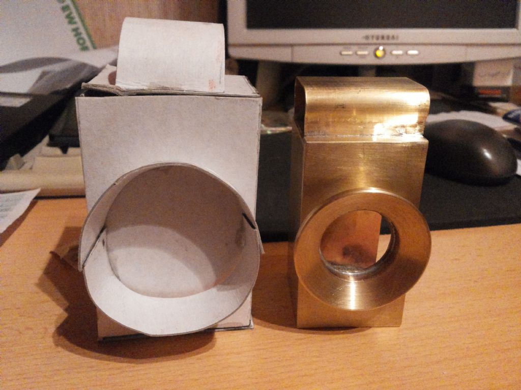

                                              I want to add a picture of my clinder cover. Made from brass formed by hand and bended over a piece of pipe and refined with a small Merryweather sign. This sign was made and interpreted after old pictures of a stamped sign.
                                              I interpreted it as good as possible from the details of the pictures.
                                              My fireman got now a footstool with a stand and so he can do better his job.
                                              And the second fireman is eagerly waiting for his first work under real conditions his first test was very successful.
                                              Fitted with an old breakfast plate and pole in the britches over booty  to the head so the poor guy is under pressure to do his next job.
                                              Werner

                                                I want to tell that my self build oil pump is now working satisfying. To get this it was unbelieveable easy. From a colleage i get the tip that he used a flat NBR rubber with a guide for the spring.
                                                In my design, a copy of a Martin Evans design, i had a support piece to guide the spring and that pressures the stainless steel ball. And that was not perfect thight.
                                                I was looking for flat rubber material and I found it in a large seal. I took a caliper to make holes in belts and adjust the right diameter an gave it a try.
                                                That little flat piecet was tight at the beginning and under steam too.

                                                  Hello,
                                                  I reworked my firepump to get more flow.I found out that the pipework and the inner diameters of the water channels are to small. I decided to look what I can do with a moderate rework. I opened the whole as much as possible and built a new valve box. And in addition I added a small wind vessel.
                                                  We made a new ride and test. The pump is much better now nearly two times the flow as before.
