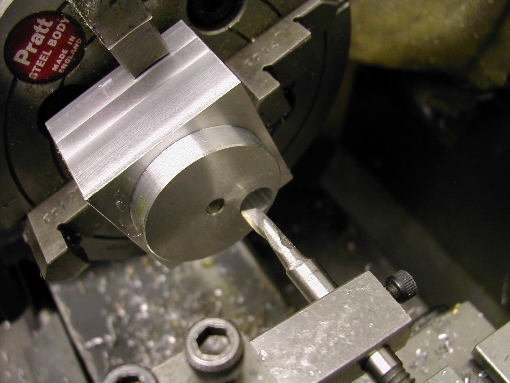

                                    You can make very nice small boring bars from old endmills/slot drills – just grind it all away save one tooth038.jpg

                                        I've made the small GHT boring bar holders and use them very frequently, but why in nearly 50 years in engineering have I never thought of using an old slot drill as a boring bar? ( please don't feel you have to answer that!)
                                        Thanks Tug what a great idea, I'll make some tomorrow before the workshop gets too hot.
                                        Learn something new every day!
