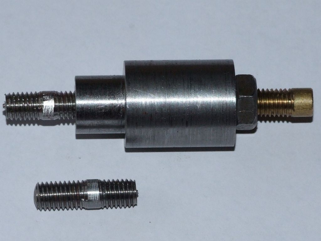

                    I make the studs I need on a repetition lathe, using a Coventry diehead for the threads. For cutting the second thread I use a jig as described:
                    The stud is 1/4" BSF and the plain portion, including the partially cut threads, needs to be no more than 3/16". I use a brass stop in the jig to prevent damage to the end of the stud. The thread that will be hidden is cut second. The threading process tightens the stud into the jig. I use a mole wrench to remove it, which leaves faint marks on the thread. These can just be seen, as a line of 'dots', in the stud that is in the jig. However, when the stud is installed these will not be seen, so I don't care!
                    The standard throat angle on Coventry dies is 20º, similar to a split die. To make a thread with no 'taper' at the bottom you would need to screwcut or thread mill it.
                    To avoid trouble with armchair 'experts' and tyre kickers the visible end of the stud should be rounded as shown above. teeth 2
                    Andrew

                    Les Jones 1
                      @lesjones1
                      I should have suggested using two locknuts then the stop could be slackened first so the finished stud could be removed easily. Although is would be slower having to remove the jig from the chuck / collet each time.
                      Les.

                            I take a bit of bar (hex or round) about as long as the threaded bit of the stud, and drill and tap it, then slit it length wise, Screw the half threaded stud in the fixture and clamp in the 3 jaw lathe chuck. If the stud doesn't undo easily, put a screw driver in the slit to open it. Good for as many studs as I make.

                                        To hold a short thread make a flanged threaded bush, with a single split, to fit a 3 jaw chuck or small collet

                                          The devices into which a threaded component is screwed, and locked with a screw, are known as stud boxes in my world. They are easily made from hexagon bar, and the locking screw can be of any type that suits, (hex head, Capscrew or grubscrew. The lockscrew ensures that there is enough friction to stop the workpiece rotating whilst the thread is being cut on the other end.
                                          If made of hexagon bar, rather than round, they can be used to set, or to extract studs. To set a stud, drive using the setscrew. To remove a stud, rotate using the spanner on the hexagon bar, but keep the locking setscrew tight with a second spanner. Once finished just slacken the locking setscrew, and the studbox should unscrew by hand.
