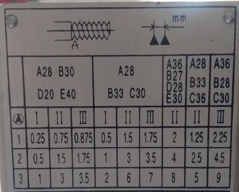

      My lathe arrived without a full set of changewheels, so one of the projects I'd like to do is to replace the missing items. According to John P's manual for the Warco equivalent, the gears should be:
      26 27 28 29 30 33 34 35 36 38 41 43 45 (ones I have in bold)
      They are mod 2.5, p/a 20 degrees, 6mm thick, and rotate on a splined hub.
      However, the front panel of the lathe:
      also has 20 and 40 tooth gears listed (and it occurs to me I should check the imperial and DP charts as well!)
      Either the Warco lathe has a slightly different internal gear train or there are more ways of achieving the same thing than what is listed – quite possible with the slightly unusual setup.
      So the actual list of needed gears is pending, but in the meantime I'm thinking about the making process. I've already acquired the necessary M2.5 cutters – fortunately, two cutters covers the 26-54 tooth range. I don't have the next one down, but I suppose instead of making a 20/40 pair I could make a 52 to go with the 26.

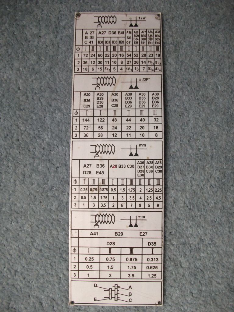

                Hi Calum
                Here is the change wheel list from the Warco GH1000
                lathe ,i expect the internal gears will be the same but they
                have replaced some of the changewheels.
                The third list down has the same result as your listing
                but the gears in the first rows are altered.
