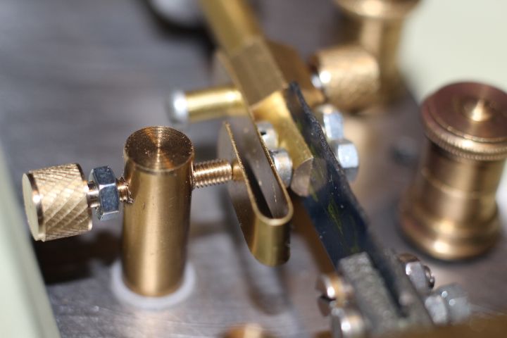

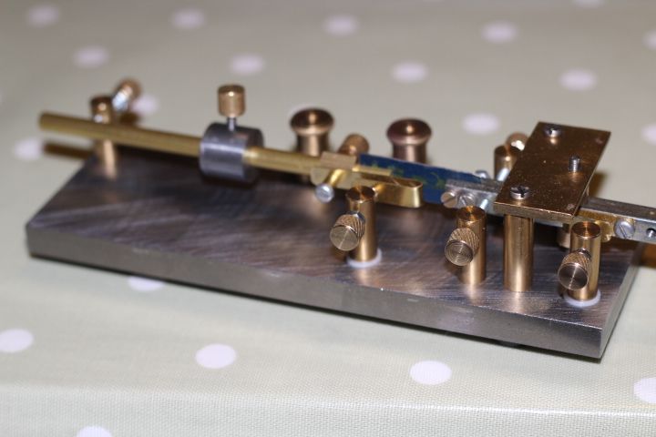

      I'm making an experimental semi-automatic morse key (like a Vibroplex) and need some advice about how to make reliable electrical contacts for it.
      The key has two contacts. One hits a vibrating arm to make dots. The other is a simple on-off used to make a dash. When contact is made a 5V control voltage is earthed to key a telegraph relay or radio transmitter. The switching current is of the order of a few milliamperes.
      At the moment the contacts are made between an adjustable M3 screw and a strip brass spring.
      The arrangement works but brass on brass is far from ideal, especially given that my wetting current is low.
      I own an ex-military morse key with tungsten contacts. Tungsten appears to be readily available as 2.4mm diameter welding rod. Has anyone had any success machining this? My Mini-lathe and I are intimidated!
      Alternatively, has anyone tried silver plating brass at home. Is it possible without using Silver Nitrate and Potassium Cyanide? I doubt either is available 'over the counter'!
      I see 2mm diameter silver rod can be bought on ebay. This looks like something I could work with but none of my practical books cover silver and I have no experience with it. Am I cruising for a bruising?
      Finally, does anyone have any other suggestions? The cheaper the better!

                                      Lots of good ideas here thanks. Now I'm spoilt for choice!
                                      I'm going to experiment. I'll start with a relay contact and a pin stolen from a D-connector. Then I'll try some silver wire from a bangle. If that doesn't work I have plenty of cupro-nickel in the shape of old florins and dud nicads.
                                      I've gone off tungsten because further research indicates it's more suitable for high-voltage / high-current applications.
                                      I have always believed that silver oxide is a good conductor. Now I'm not so sure. I couldn't find much on the internet.
                                      Thanks again everyone.

                                              Colin: good idea especially as I have some nice new plugs that don't fit my current car.
                                              Francis IOM: It's a fair cop guv! My design rationale for building the key is far from logical. I like retro technology and making mechanisms. Brass and steel are sexy. In my twisted mind an interrupted beam would be the thin edge of a wedge leading to a fully electronic or computerised solution. I enjoy that kind of project too, but we ME types have to justify all that expensive metal bashing kit in our workshops somehow!
