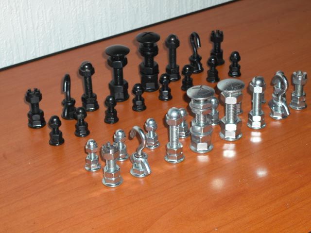

                                            I made a chess set using nuts and bolts. The black pieces were treated with brick cleaner (hydrochloric acid) to remove the bright zinc plating and then blacked by heating and dunking in oil.chessmen3-1.jpg
                                            #656490
                                            Roderick Jenkins
                                              @roderickjenkins93242
                                              Anthony, your fastenings chess set is utterly charming yes
                                              Rod
                                              #656503
                                              Mick B1
                                                @mickb1
                                                Posted by Roderick Jenkins on 14/08/2023 09:46:57:
                                                Rod
                                                It is indeed!! laugh
