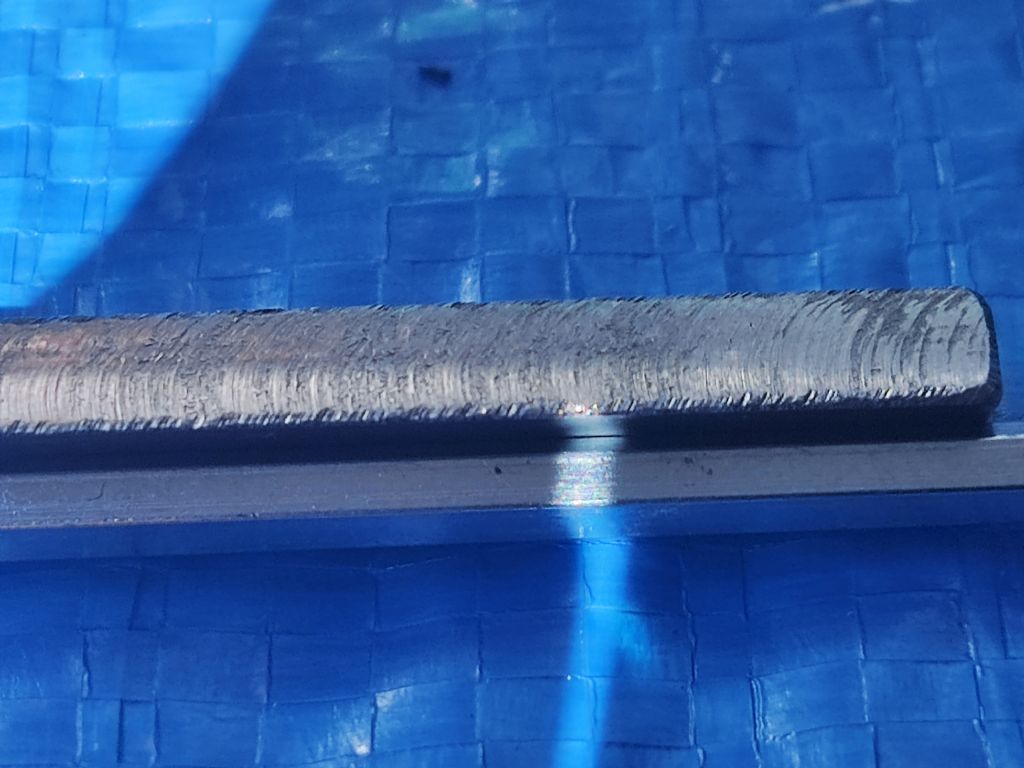

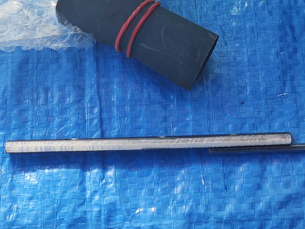

                          Yeah, you should see the state of the quills (ill post a photo or two of the crosslide quill) and the undersides of the slides. But i was sort of getting into slowly fixing everything and eventually making it into a machine worth owning. I had figured this is what you get for a $1000 (600 quid?) Lathe.
                          Ill see what vevor will come at.

                                  Heres some pictures of the crosslide quill to amuse you all…

                                                  ps. That gib strip looks a bit grim.
