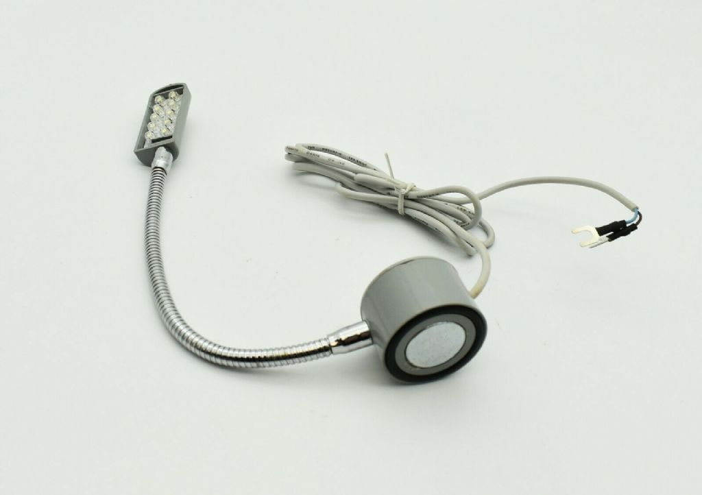

                    My experience for what it's worth! I experimented with two types and decided neither did what I wanted. More on that at the end!
                    To my lathe, I fitted a magnetic sewing machine light, like this one but cheaper.
                    Prices range from about £5 to £40. They come with either a plastic clamp or magnet base, making them easy to fit to most machines, moveable, and they produce a reasonable white light. The swan neck isn't long enough, and, more important the electrics may not be fit for purpose. (The more expensive versions might be: my cheap lamp was cause for concern.) Problem is sewing machine lamps aren't designed for rough workshops, exposed to knocks and fluids, where the user is dangerously well earthed by big metal machines and concrete floors. The circuit that powers the LEDs is safe enough on a sewing machine in a dry internal room, but risky as a machine lamp. The same concern applies to other domestic lamps; are they electrically safe in a workshop?

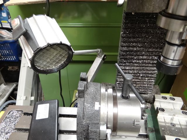

                    My mill is fitted with a proper machine light, electrically safe and mechanically robust. It contains a 12V power supply driving a quartz halogen car headlamp bulb. Fixed to the machine with four bolts, so attaching it may be problematic, particularly as gantry movement limits where the base can go. From memory, about £60.
                    Neither lamp is satisfactory in my workshop. They both create unhelpful deep shadows and bright reflections. So I upgraded my workshop's general lighting instead. Squeezed into a single garage, after painting the ceiling white, I fitted three pairs of diffused 60W fluorescent tubes – 360W daylight total. The lamps are positioned to brightly light everything underneath evenly: no shadows and reduced reflections.
                    So although occasionally useful on the mill, I don't need a machine light. Not perfect, as soon as the fluorescents pop their clogs I shall upgrade to LED – the light is better. The change was so successful I wondered if machine lamps are bygone hangovers from when factories were relatively dimly lit – 100W tungsten bulbs are about 2.5% efficient, compared with a strip lamp's 20%. My garage is brightly lit!

                                          8 hours have past and no one has made a comment about S O D leaving his chuck key in the chuck !!
                                          Keith

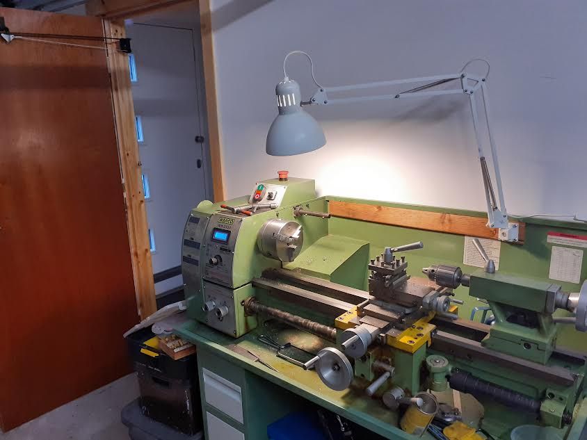

                                              Posted by Dave Halford on 04/09/2021 17:28:31:
                                              I use the £9 TERTIAL ones from Ikea. They just need careful placement.
                                              Another vote for the Ikea cheapie. It comes with a bracket you can fix to a suitable vertical surface, and unlike some other anglepoisoids it doesn't restrict the forward pivot of the lower arm.
                                              I removed two of the tension springs to improve its articulation and its ability to stay where you set it when you let go.
                                              I put in the wooden batten on the splashback to provide grip for an earlier spring-clip lamp, that wasn't as good.

                                                Posted by KEITH BEAUMONT on 04/09/2021 20:30:17:
                                                Keith
                                                That is because it is a Rotary Table !!!!! they are not known to harm people.
                                                #561276
                                                KEITH BEAUMONT
                                                  @keithbeaumont45476
                                                  Brian,
                                                  I was being facetious. Normaly someone comes out of the wood work to point out that such practice, whether stationary or not, is not to be encouraged.
                                                  Keith

                                                      I bought 2 of those sewing machine lights as in SOD's post. Potentially lethal, 2 very spindly wires up the metal Swan neck, one of which could be at mains voltage. Spent far to much time modifying them to run on safe voltage, should have binned them
