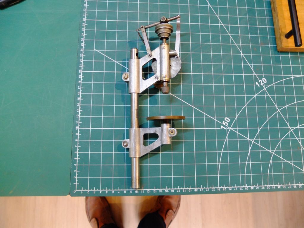

      I wish to paint the aluminium castings of a very small pillar drill I'm rehabilitating and I really want to keep the outlay to a minimum.
      I realise that i will have to splash out on an etch primer (U-Pol Acid 8) but I'm hoping I can use that for other projects as well.
      Ideally, I would like to use Paragon paint in machine colour of my choice but a 500ml tin is enough for dozens of castings this size.
      It's not so much the cost as the waste that I don't like.
      Can anyone suggest an alternative? I can't find any sample size tins that would suit me.
      Is Humbrol and the like suitable for a job like this? I will be applying it by brush.
      Also, the castings are a bit rough and pitted and I think maybe a high bulid primer over the etch primer might help.
      Any thoughts on this or any alternative.

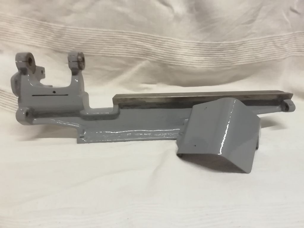

                          #655191
                          Andy_H
                            @andy_h
                            In case this helps anyone else….
                            After spending at least 6 hours last weekend (bit sad I know!) researching on the internet for a suitable product, available in small volume (250ml is more than enough) and at a sensible price I decided to opt for Rust-Oleum Universal Paint (All Surface Paint) in Slate Grey gloss finish. Must say I'm pretty happy with it – really nice to apply and levels out nicely to a flat finish.
