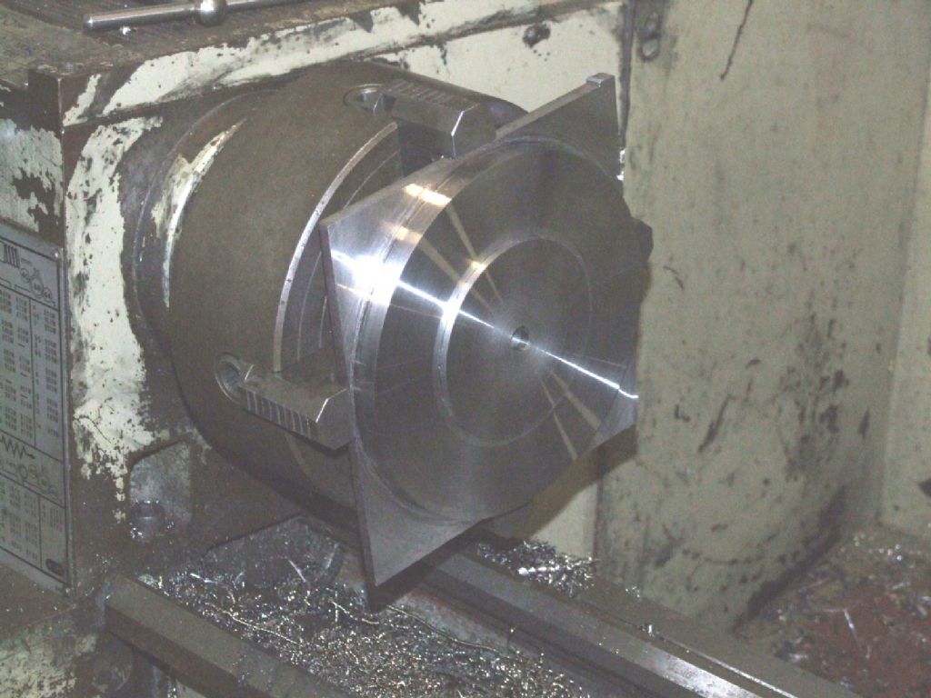

                      Don’t know about the small stuff, or using HSS tools, but hot rolled turns fine with carbide, if the surface speed is high enough. As in this picture:
                      The block is 160mm square and was finish turned at 540rpm. This gives a peripheral speed of about 890fpm. The surface finish is about 1.8µmRa; not great but adequate for the job and not too much of a surprise given the tip had a radius of 0.2mm with a feed of 0.1mm/rev.

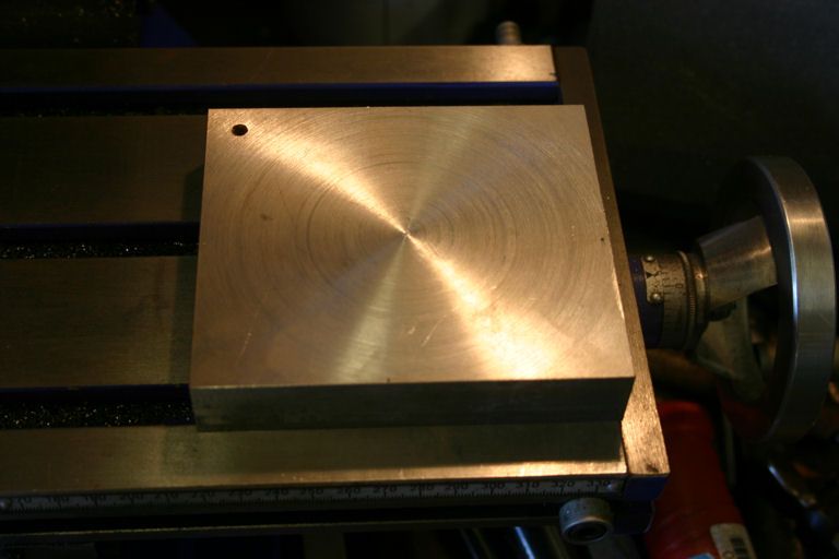

                        Hi Andrew and John,
                        I can get good results with Hot Rolled
                        black but I meant that it needs extra care with tool shape and grinding,
                        being that bit more tenacious than cold drawn. Perhaps I expressed
                        myself badly in my original post. The rings in the photo below of a machined part in hot rolled (of very dubious origin – from a skip) are not as pronounced on the actual piece and are a result of hand feeding the tool, no coolant.
