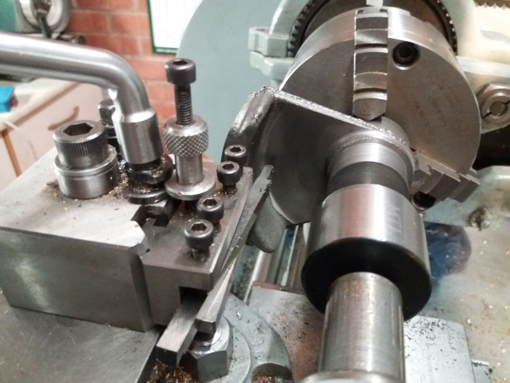

  • #401348
    David George 1
      @davidgeorge1

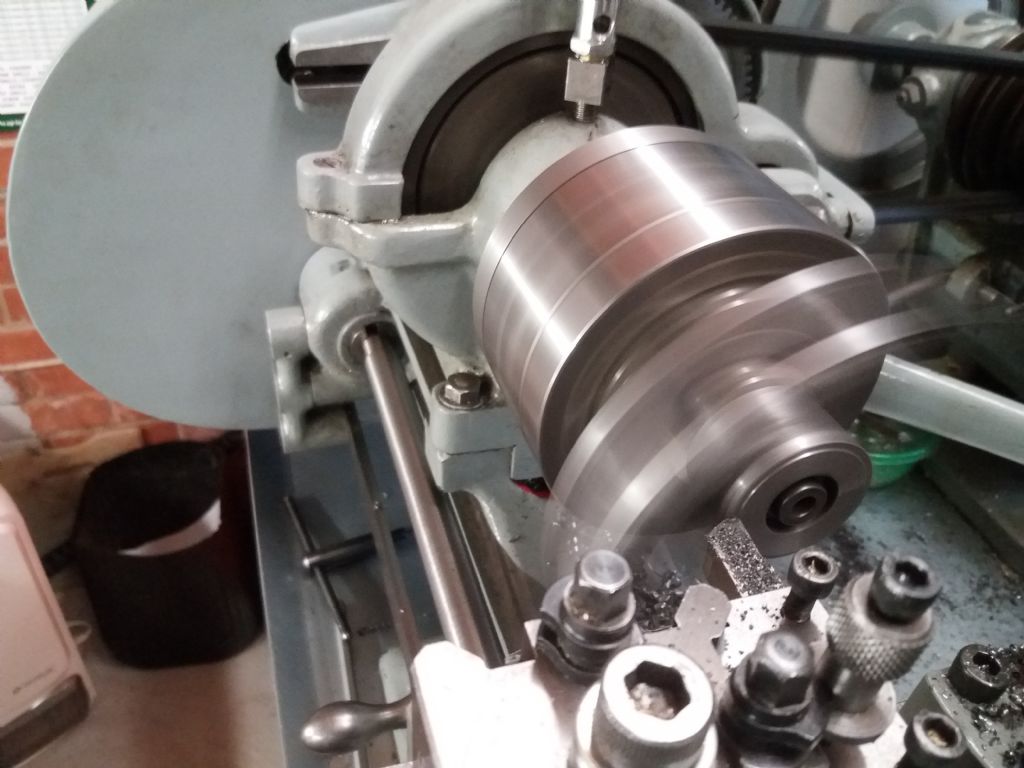

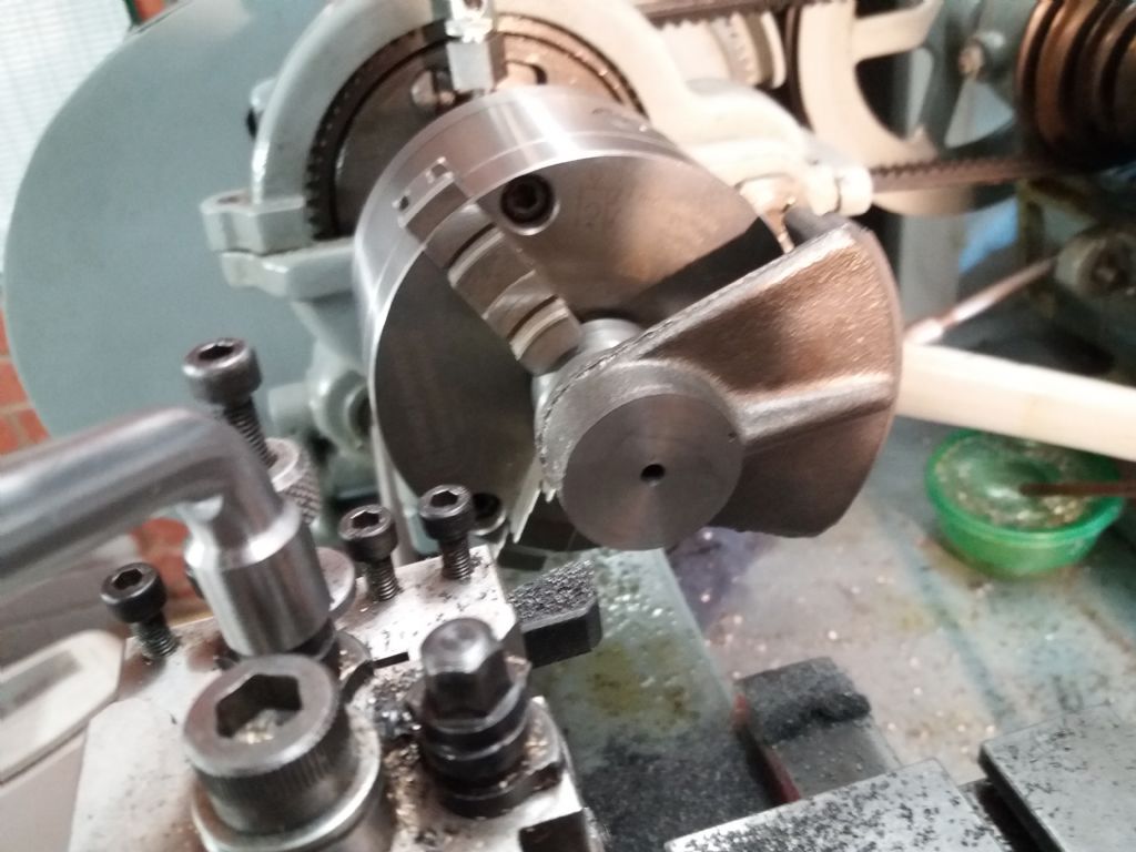

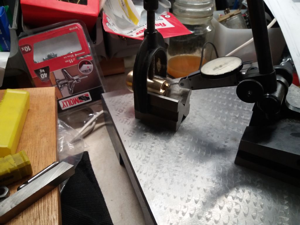

      I acquired some castings for tumbler reverse so started machining first casting.
      Held in 3 jaw chuck skimmed machining boss and centred to hold square and machined outside to size.
      Skimmed inside face to help hold whilst cutting radial slot etc.
      Turned round to face boss to length and bore to size for spindle.
      David

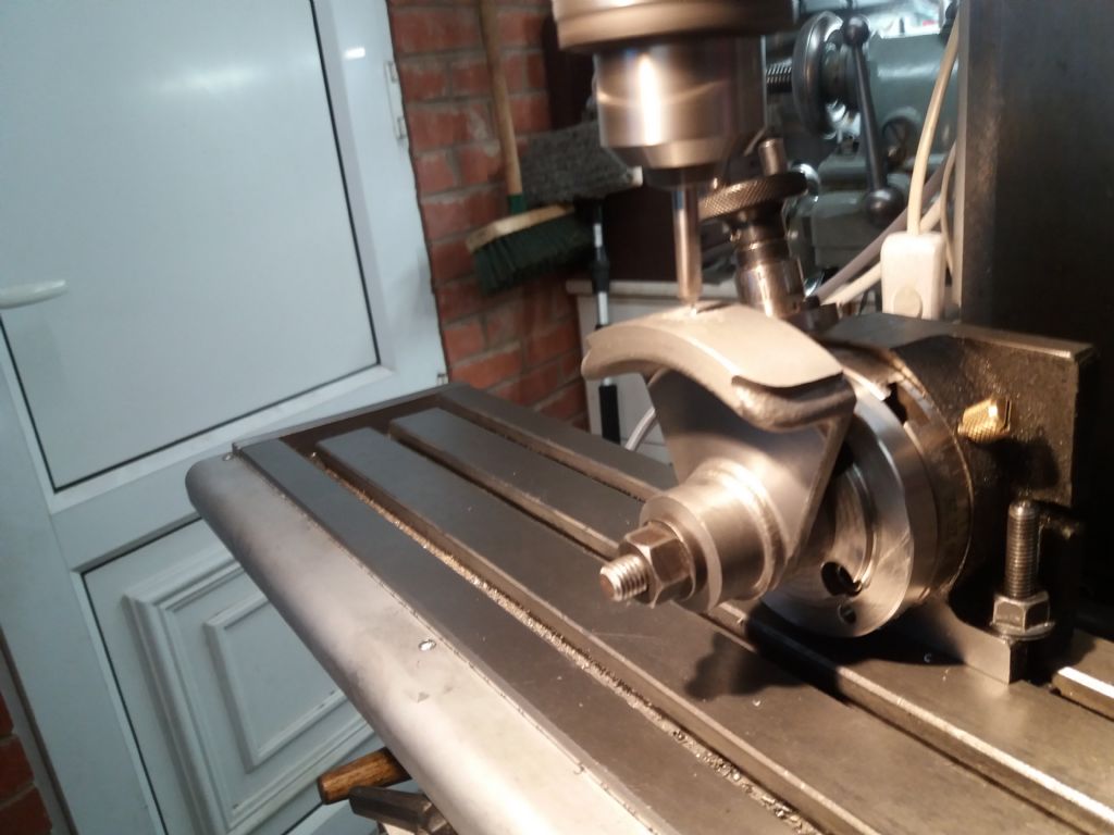

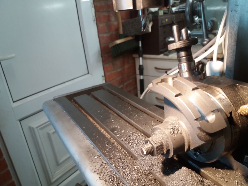

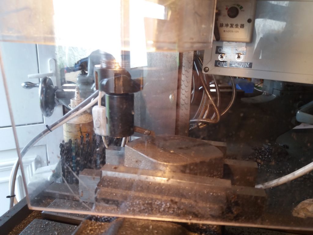

              Next set up on rotary table for milling.
              David

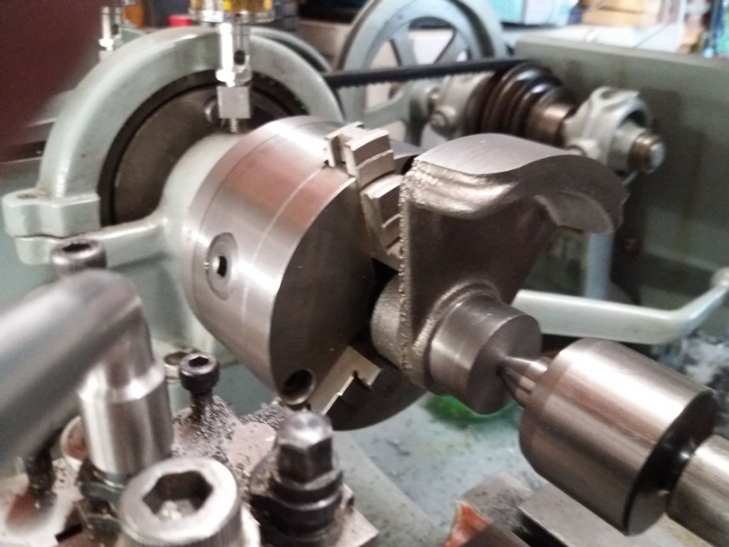

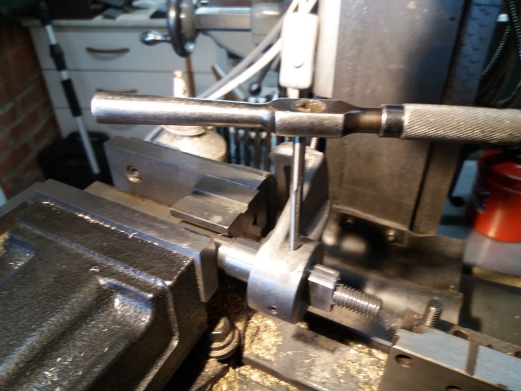

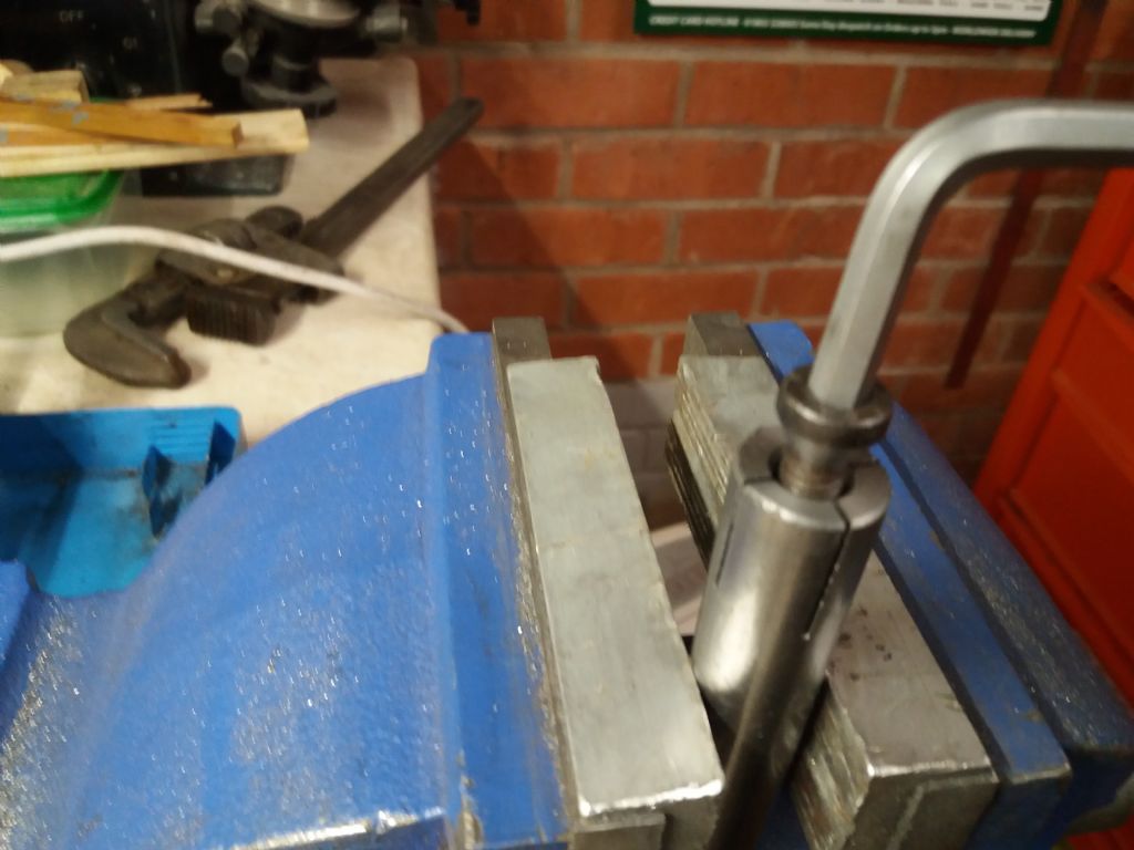

                  #401848
                  David George 1
                    @davidgeorge1
                    Now to turn the boss to length. Hacksawed the boss waste off and made a expanding shaft jig to hold the part. Piece of size material, centre drill with large drill to make 60 deg cone and tap M8 for screw. Turn 60 deg on back of head on cap screw. Hacksaw two slits to allow diameter to expand. Debur and screw in screw check amount of expansion, loosen and put on part tighten to grip part and check that it won't slip, OK.
                    Put in lathe chuck turn to length and the main casting bar drilling for pin on assembly us done.
                    David

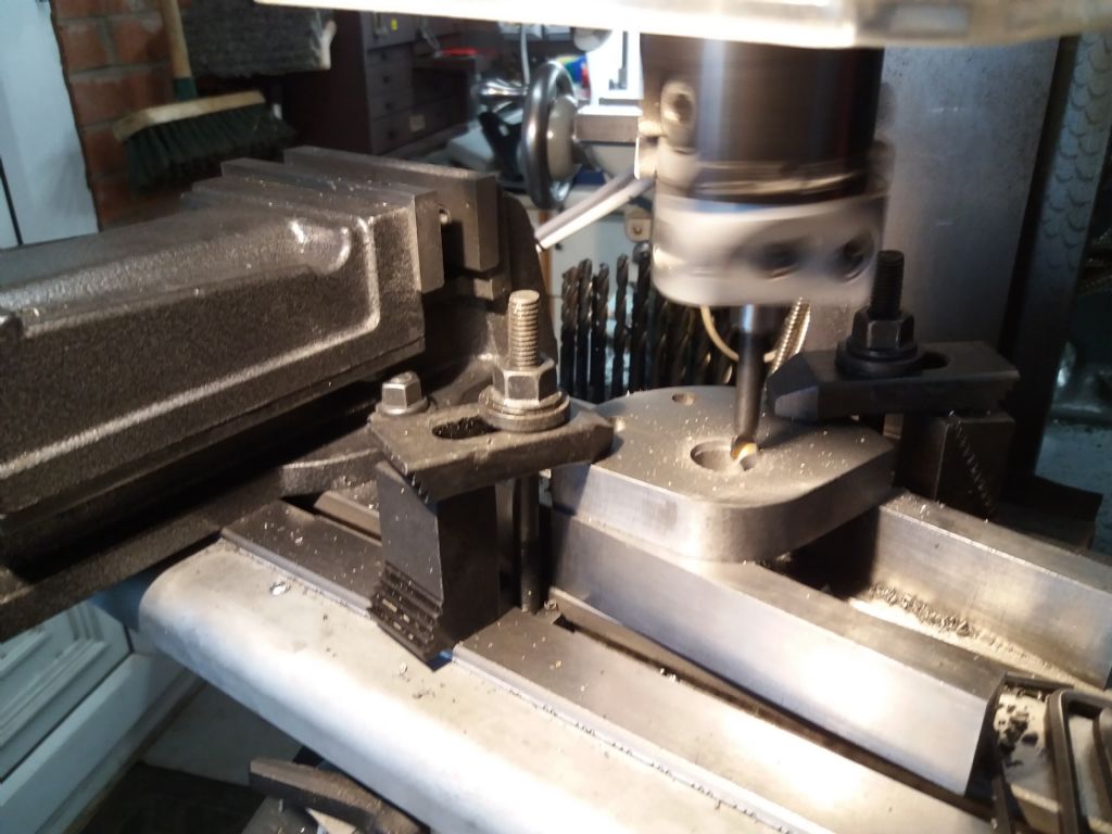

                    #402339
                    David George 1
                      @davidgeorge1
                      Started work on quadrant casting.
                      Fly cut the casting to thickness and then clamp down to bore the holes for gears.
                      Finally bore the shaft hole for support shaft.
                      David

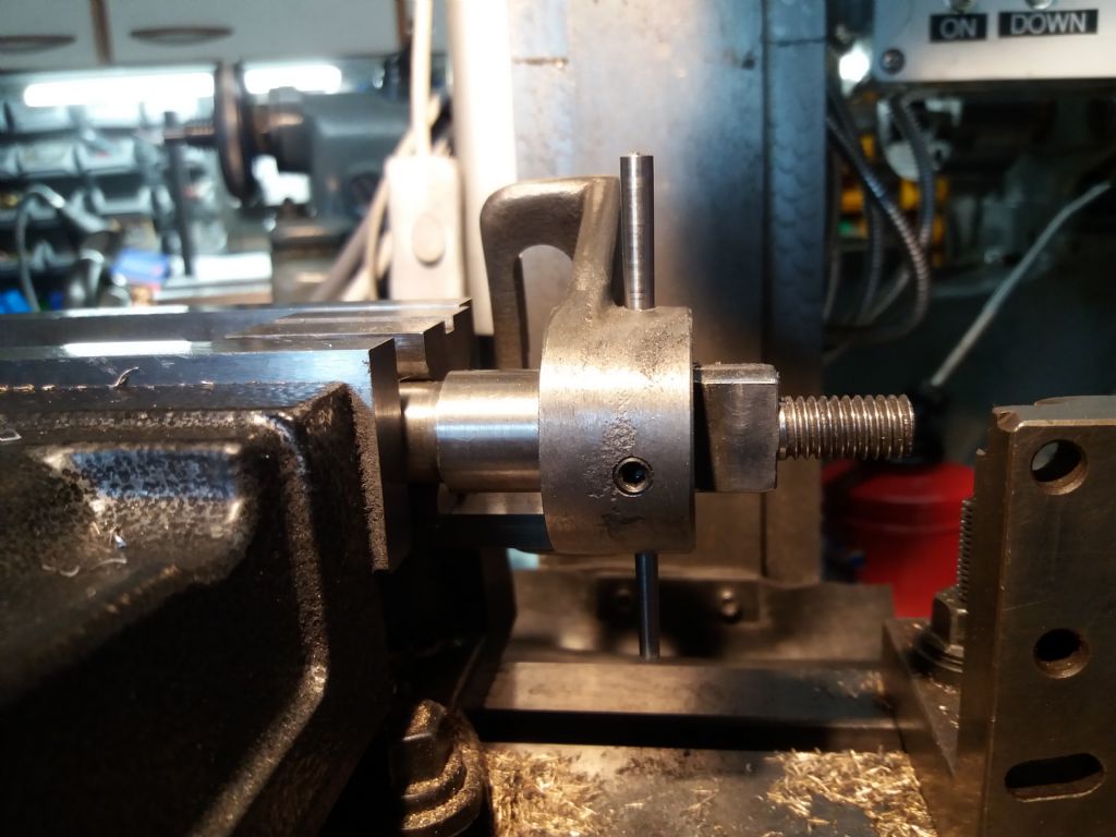

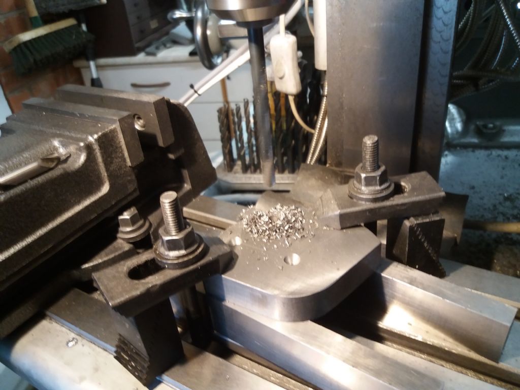

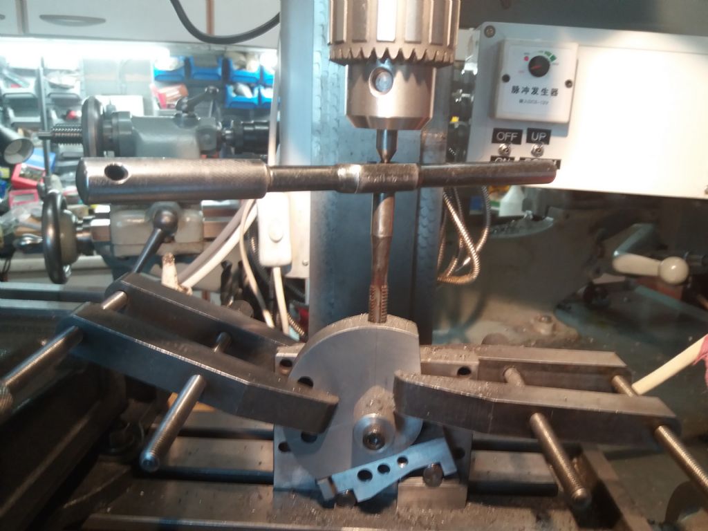

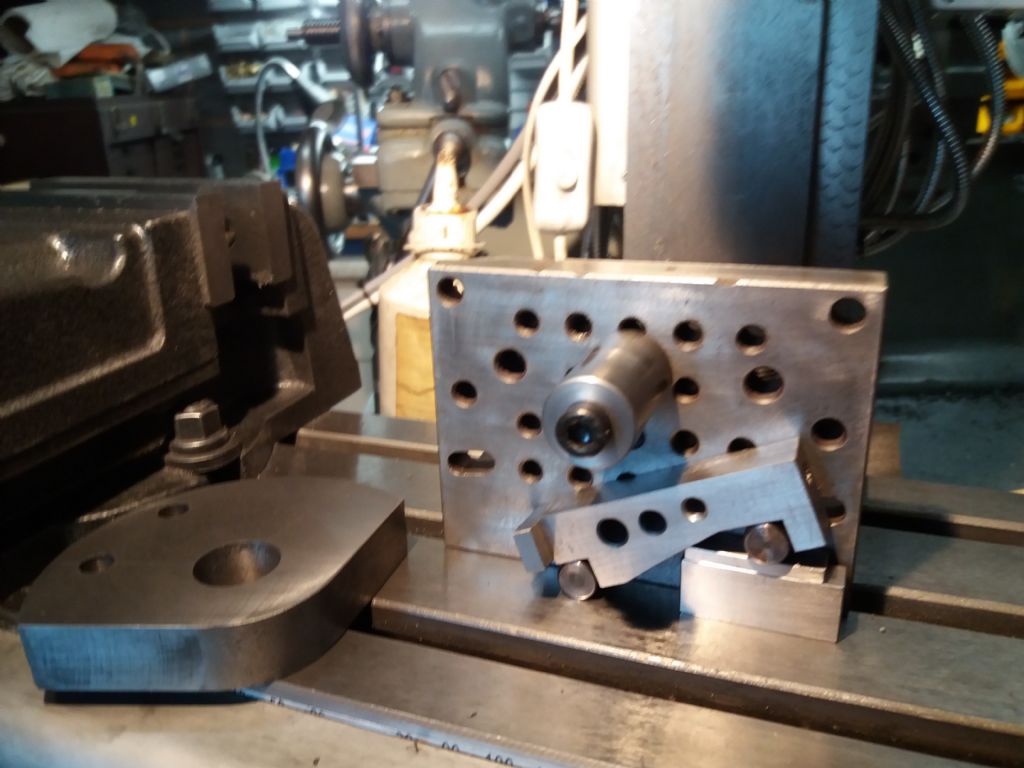

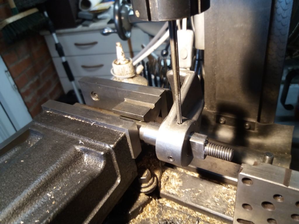

                      #402413
                      David George 1
                        @davidgeorge1
                        Started to drill the quadrant casting edge holes. As the hole for the location plunger has to be at 112.5 degrees to gear holes I used a sine bar to set the angle. The hole has to be in relationship to shaft hole so bolted a short length of shaft to angle plate and centred mill on shaft. Put casting on to shaft, rotated to suit the sine bar and clamped problem solved.
                        David
                        #402443

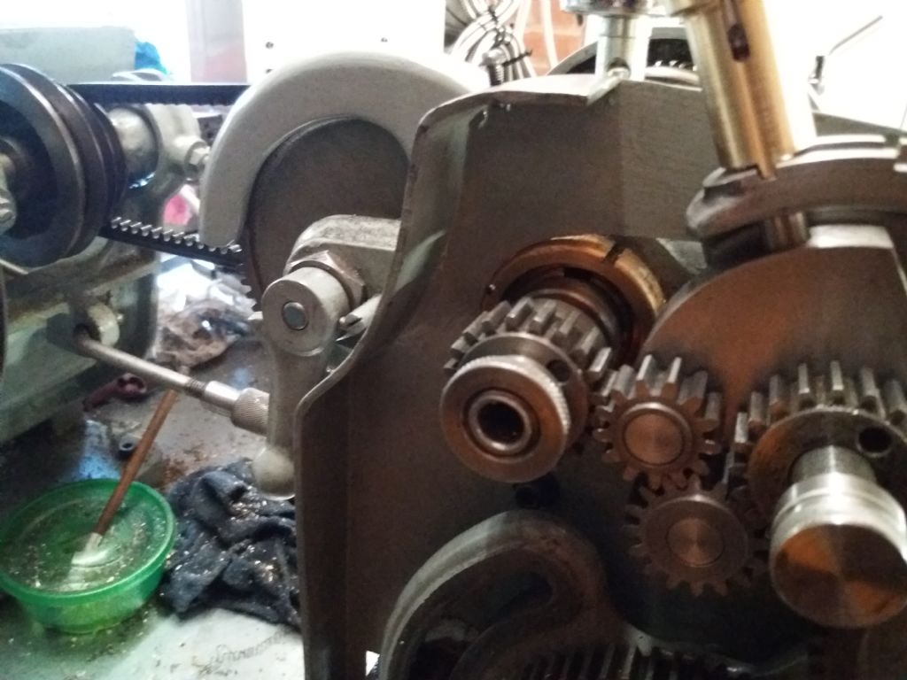

                            #403299
                            David George 1
                              @davidgeorge1
                              Done a bit more on tumbler reverse, made the turned parts and started drilling and milling them to get them to work and the small gears have arrived so I can try to fit it and set it up for drilling for taper pin to fix it rotationally. I drilled and tapped the main casting for a grub screw to help with holding it whilst setting it up.
                              David

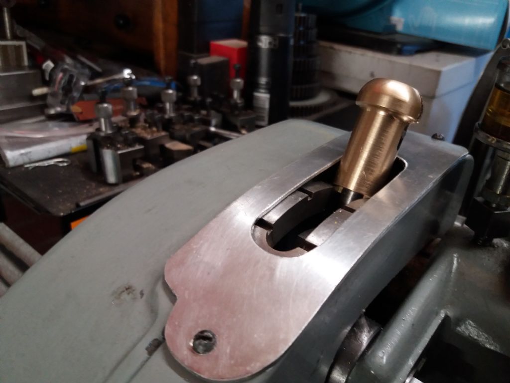

                                  #403401
                                  David George 1
                                    @davidgeorge1

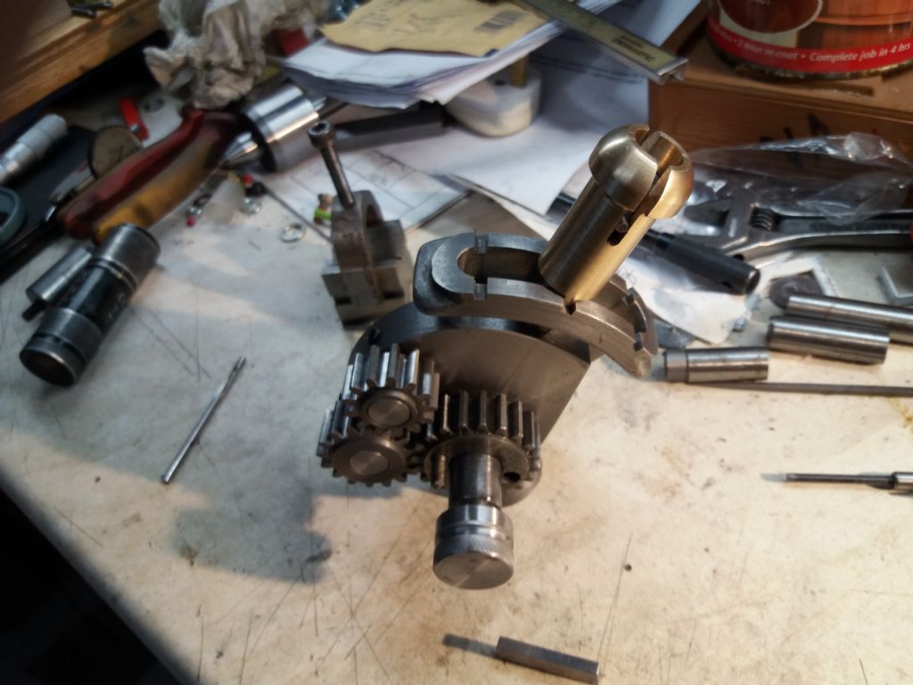

                                    Made a new top cover for gear casing.
                                    David
                                    Edited By David George 1 on 03/04/2019 19:53:10

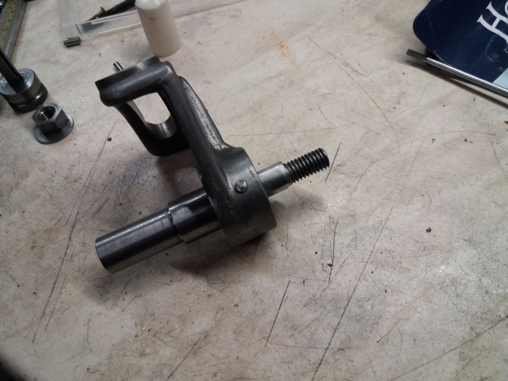

                                    #403548
                                    David George 1
                                      @davidgeorge1
                                      Pinned the casting to the shaft.
                                      David

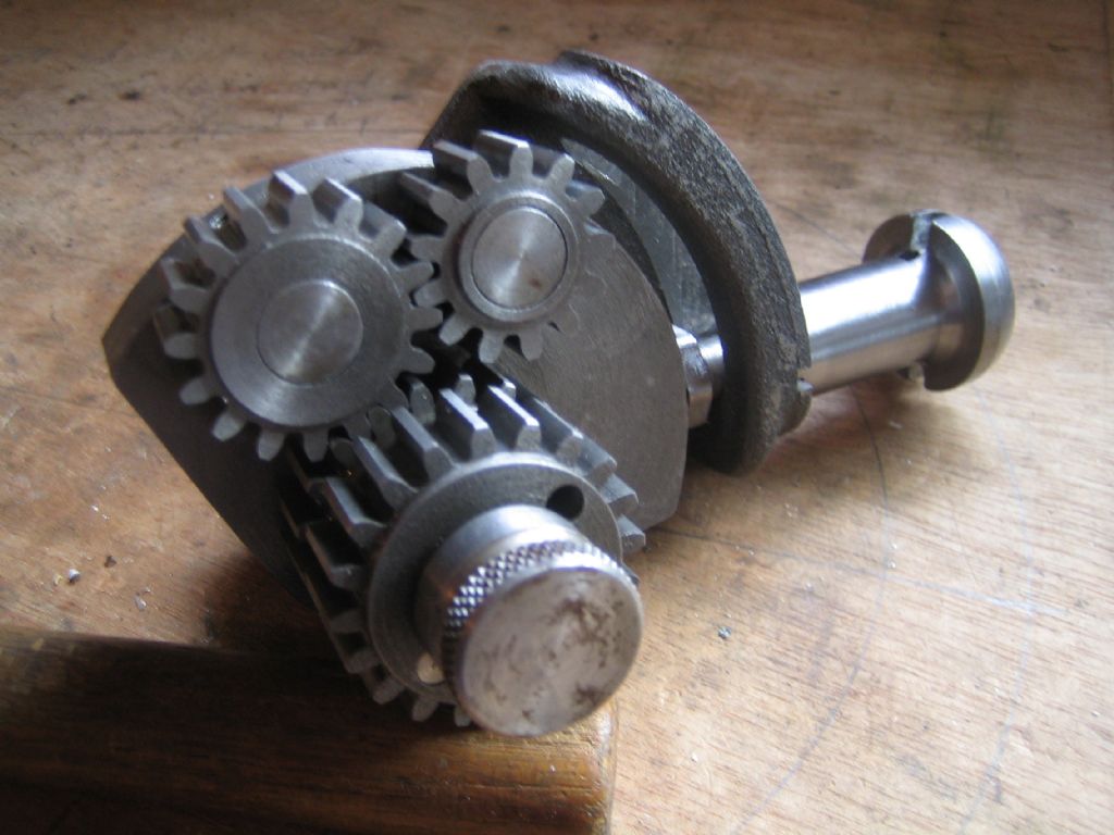

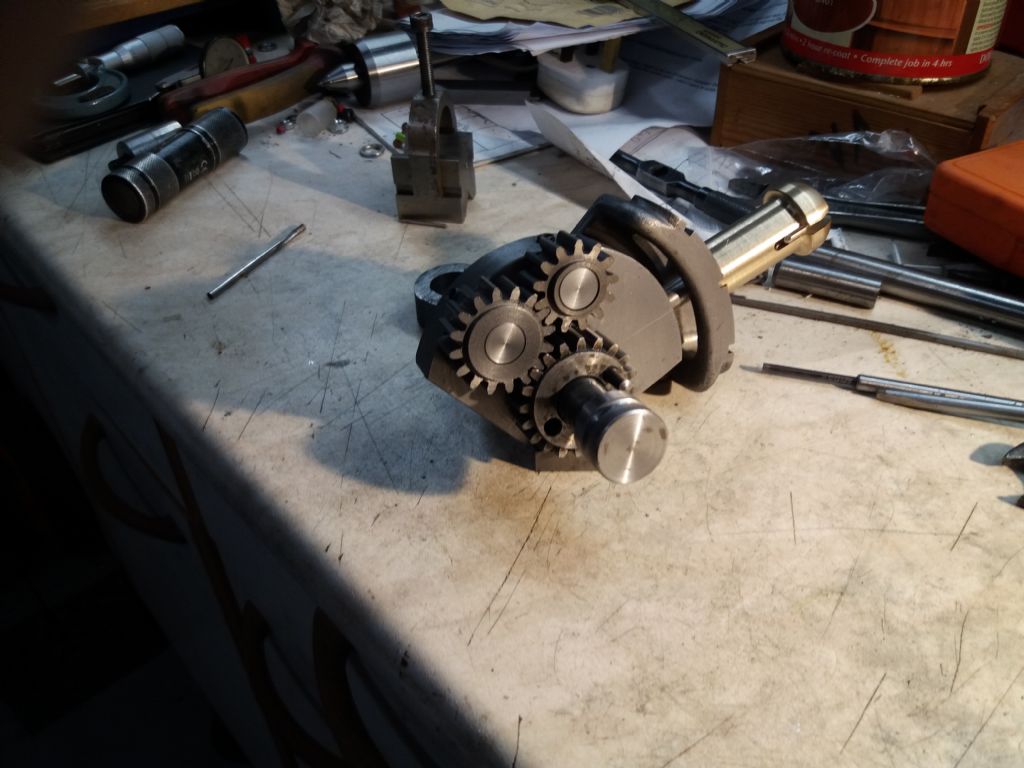

                                      #403582
                                      geoff walker 1
                                        @geoffwalker1
                                        Looks finished now David, except for the painting.
                                        Assume the gears are ok, whole job very professional.
                                        I used the grub screw method to hold it together while fitting the taper pin, GMTA?
                                        Completed mine about 9 years ago, same patterns used for the castings as yours.
                                        Here is an archive picture.
                                        Geoff

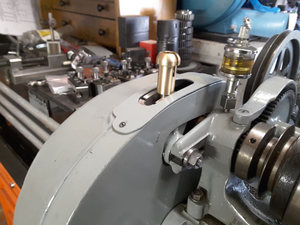

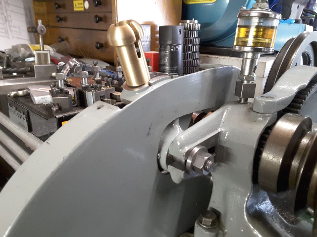

                                        #403902
                                        David George 1
                                          @davidgeorge1
                                          Finished and painted Tumbler reverse. It works very well but need to play around with gearing for fine feed.
                                          David

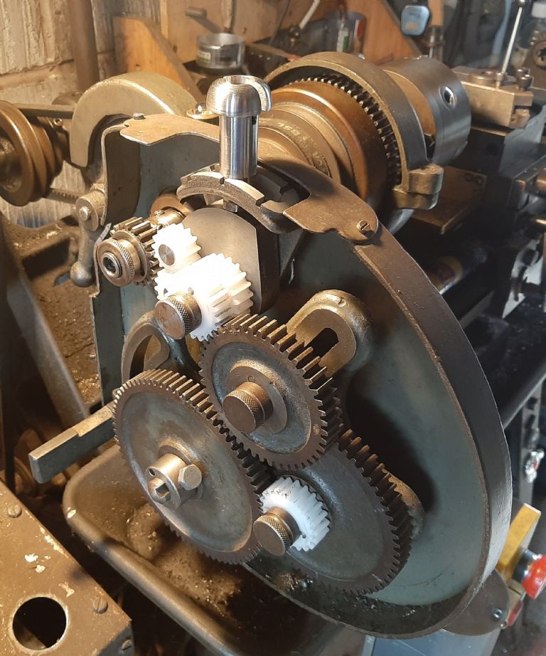

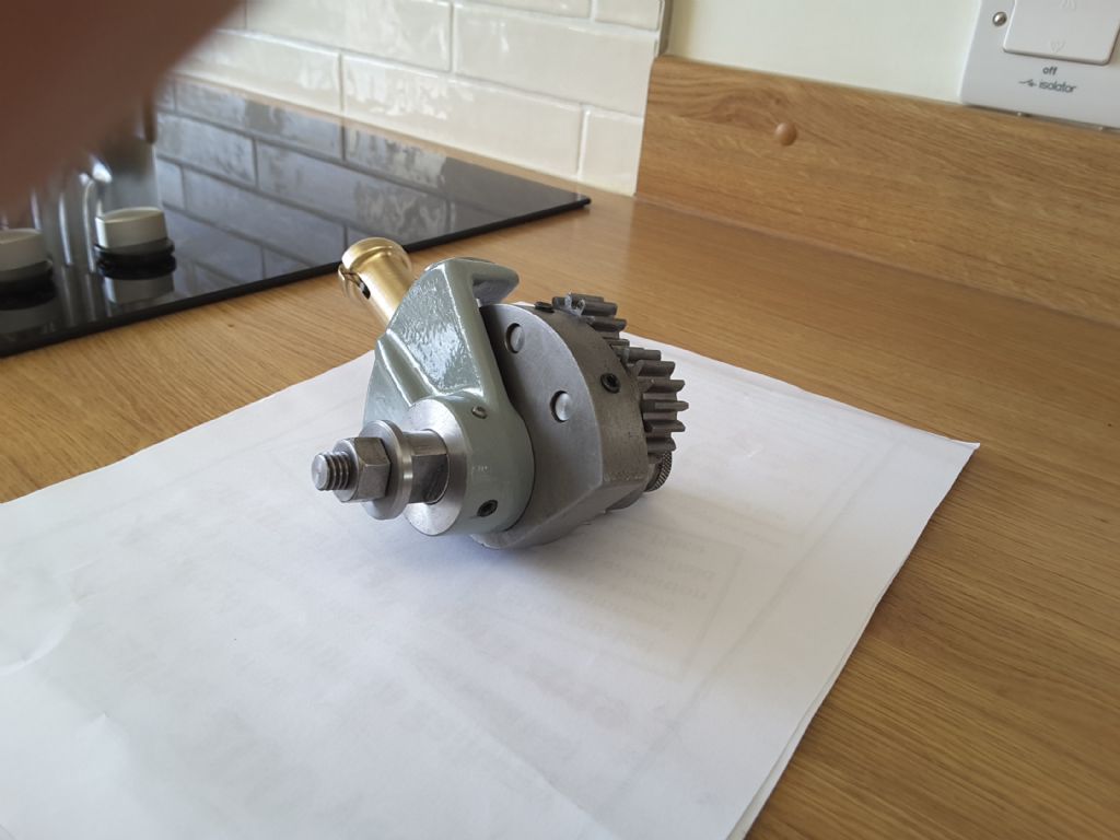

                                          #651523
                                          geoff walker 1
                                            @geoffwalker1
                                            …….and here is another recently made tumbler reverse for a myford M type.
                                            Complete with acetal (delron) gears.
                                            No two cast iron gears mesh in the fine feed set up shown (214 t.p.i.)
                                            The drive is very smooth and very quiet.
                                            Very impressed with the physical and practical properties of acetal, easy to machine but very tough and in my opinion entirely suitable for replacement gears on a lathe of this size.
                                            This tumbler is here to stay!!!
                                            Geoff

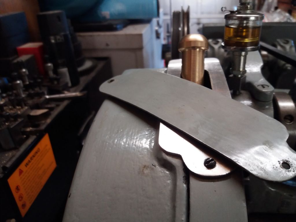

                                              #651567
                                              Bazyle
                                                @bazyle
                                                Odd coincidence that I was cleaning my knob at the weekend and was a bit jealous that yours appeared to be brass but it is just the lighting. Mine (Myford post war) has a flatter mushroom though.
                                                #651597
                                                David George 1
                                                  @davidgeorge1
                                                  Hi Bazyle my knob is brass. I just thought a brass knob would look well instead of cast iron on the drawing and it pollished up easily with a quick rub ocasionaly. I also adjusted the shape to suit my whim.
                                                  David
