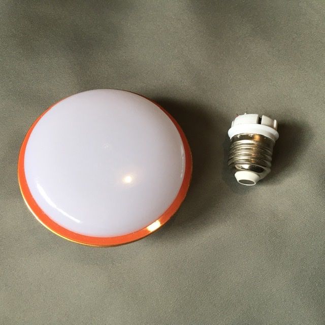

        #484005
          Posted by Robin Graham on 04/07/2020 23:45:28:
          Does anyone know how these lamps typically fail? The LEDs themselves, or the drivers?
          Robin.
          I don’t have sufficient data to assert that it’s typical, but a recent failure resulted in two visibly burnt LEDs in the array [one of which went open-circuit]. A replacement lamp also quickly failed … and I am convinced both failures were caused by a poor quality light-switch.
          Swapped the switch for a good MK one with a nice crisp action, and all has been well.

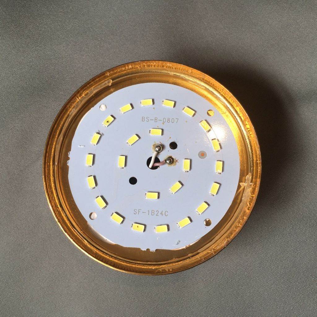

                      No … The driver seems to survive, but I think the bad switch contacts are acting as a diode for a few mains-cyles: de-stabilising the driver and over-driving the LEDs.
                      To quote my previous post: … a recent failure resulted in two visibly burnt LEDs in the array [one of which went open-circuit].
                      For the avoidance of doubt; that’s two LED chips in the array within a single ‘mains light bulb’

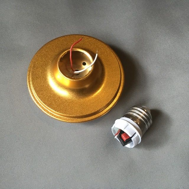

                                          Just to keep the conversation going … here are some pictures of my failed ‘flying saucer’
                                          The two burned LEDs are clearly identifiable:

                                                      I may be missing your point, John [in which case, please accept my apologies], but:
                                                      My hypothesis was not that the contact was intermittent, but that it was [briefly] diodic in nature
                                                      [ Steve’s comment about self-cleaning is relevant ]
                                                      The replacement lamp on that circuit was perceptibly ‘slow to start’ until I changed the switch.
                                                      I don’t have the skill or enthusiasm to properly test the hypothesis, but I am fairly confident that the driver circuit was imbalanced [and therefore produced a spikey output] for a few mains cycles immediately after switch-on … no harm done to the driver, but over-voltage on the LEDs.
                                                      My photo shows the two weak links in the chain.
