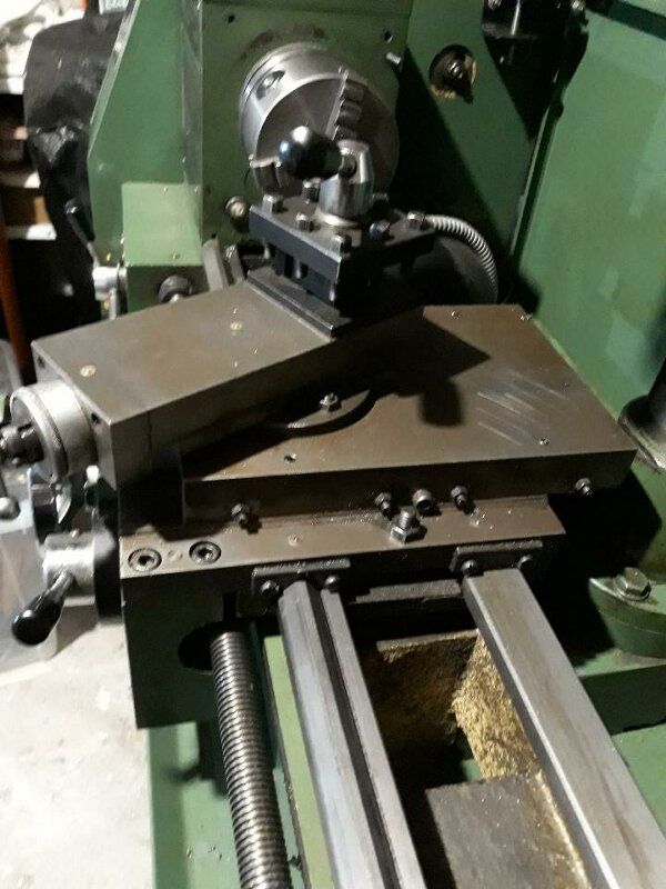

      Hi I have just bought a Lathe Mill combo and it is currently set with a rotating tool holder that was holding a 20mm tool. Testing its center it appears to be 14mm so is packing a 12mm higher the only way to get the cutter tool correct. Also what sort of vice attachment works on the lathe to allow the mill to be used?

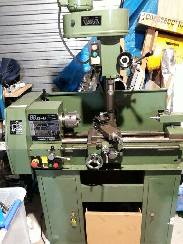

            Hi All, the Lath Mill combo is a BB 22A Cutting Machine made by Beike Machine Tool Factory.e.jpg

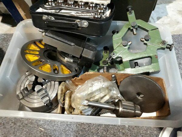

            This is the box of parts that came with it a Collet set, 4 jaw chuck, faceplate 2 steadies, changewheels, tailstock drill chuck and spare jaws for the 3 jaw.
            I bought a set of 12mm tools and that's whats in the second picture but it was still leaving a little nob on the end. Bought a whole series of Workshop practice books and nothing talks about getting the tool to match the centre or how to set up the mill on a lathe set. Most talk about verticle vices and milling with the lathe.

              Yes you need to put packing under the tool shank to bring its cutting edge to centre height, standard operating procedure. Should be described in one of your books if it covers turning properly. Use strips of aluminium or similar.
              For milling you need to bolt a tee-slotted plate or a machine vice on to the cross slide in place of the topslide, or a vice on top of the plate. I would have thought that at least the plate should be part of the spares kit. Looks like quite a tidy and useful machine.

                Just to add that the cross slide top seems to be very wide which supports the idea there should be a tee-slotted plate. Probably a Myford boring table (which would do the same job on an ML7 / Super 7 lathe) would do the trick.

                    Owen, there seems to be 4 tapped holes in the cross slide which would indicate provision for fixing a T-slotted sub table similar to the Myford example, you could possibly use one of these suitably modified to fit your machine. The make of you machine is not evident but its likely if you can find this you may well be able to purchase a dedicated one. Maybe search the usual suppliers for a similar item e.g. **LINK**
                    For packing tools to height I would recumbent steel shim and if you can find any the steel banding used for holding goods to pallets etc is useful but much of it is now plastic.

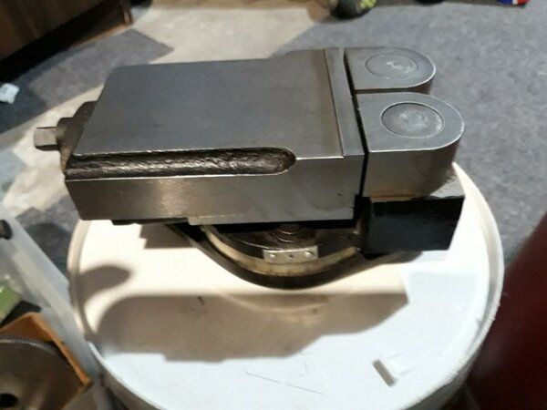

                        The bottom flat part rotates and there appears to be two tee bolts inside it, viewed through the outside hole on the bottom when rotated.

                          Owen, probably worth removing the top slide — the one with the 4-way tool box on it and post a photo of the cross slide then we can see what's there, it does look as though a sub table will be needed

                            That's a machine vice! It may or may not be designed for the lathe, if you take the topslide off and compare you may find that the vice will bolt down instead.
                            A slotted table may well be more useful than a vice as it gives more ways to clamp down the work. That one from ARC looks quite useful. Myford ones will generally be used now as I don't think they are in current production.

                                That's your missing milling vice. If you turn that square shaft sticking out the left hand end in the pic, the moveable jaw will open. The fixed jaw appears to be a two-piece type than can grip either straight/square jobs, round jobs or odd shaped jobs as the two parts of the fixed jaw pivot.
                                The base appears to be made so it can bolt to a T-slotted plate that would be bolted on to the cross slide once the top slide has been removed. The two small half-rounded blocks on the base drop into the T slot. Then two T-bolts stick up from the table through the slots in the vice and then two nuts are tightened down on top to hold the vice firm.
                                I'm sure I have seen T-slotted plates for sale somewhere, maybe one of the suppliers that advertise on this site? That would be cheaper than a Myford cross slide jury rigged up.
                                The graduated dial above the vice base is to swivel it so you can mill at an angle or do simple dividing such as drilling a circle of six holes in a flange etc.

                                            It looks like a Clone of an EMCO Maximat 11. You do indeed need a sub plate for doing work with the Millinghead. I have seen these for sale from tool suppliers,

                                                    The "spare jaws" for the three jaw chuck are likely to be reversed configuration jaws which allow larger items to be held.
