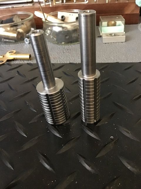

          This is what I was making.

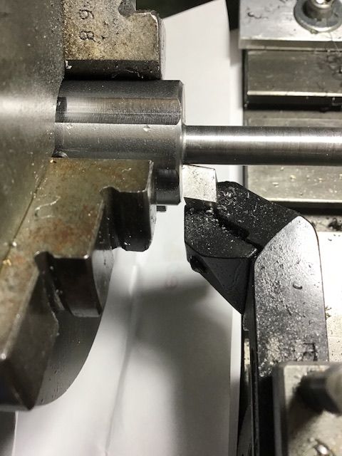

              This is the tool setup.

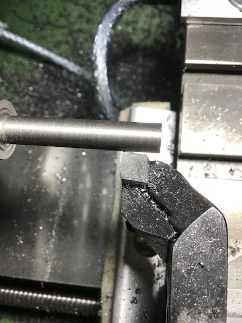

                                Thanks for all the replies and suggestions,The tool holder is less than 6 months old and I put the finished part in to chuck so I could take a picture of it with tool up against the shoulder and I can see I have more clearance one side and not much near the shoulder.
                                Dell

                                  Dell, looks to me like there is enough clearance on the shoulder side.
