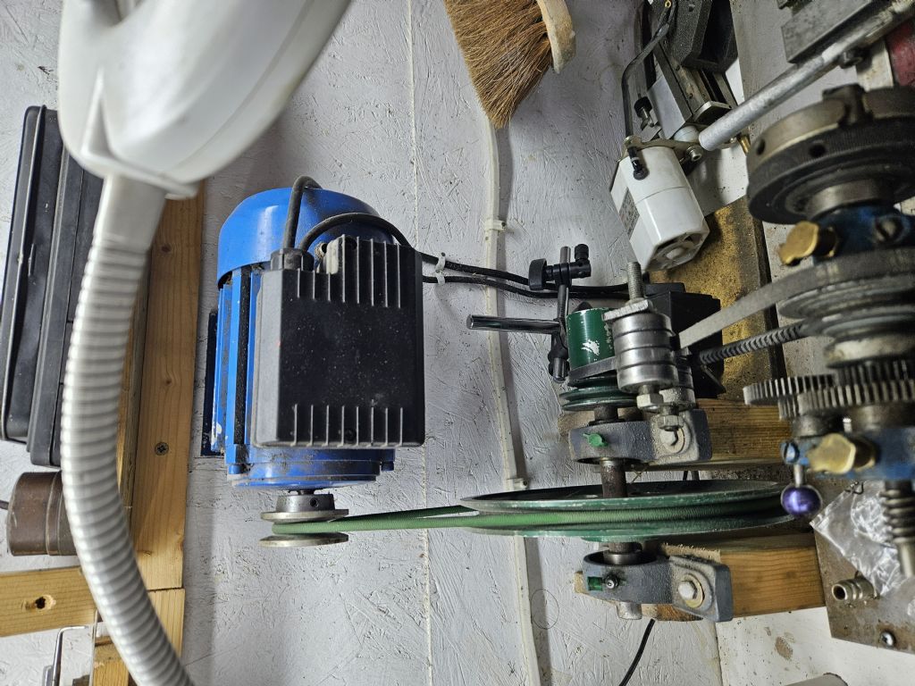

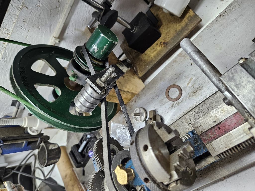

                                                #656138
                                                James A
                                                  @jamesalford67616
                                                  20230811_183628.jpg20230811_183637.jpgIf it helps, this is the drive on my Flexispeed. Ignore the dust: I have been refitting the bathroom for ages and have not touched the lathe for months.
                                                  Edited By James Alford on 11/08/2023 18:51:25

                                                    Andy_H
                                                      @andy_h
                                                      Posted by James Alford on 11/08/2023 18:50:26:
                                                      Thanks for this James.
                                                      I like the idea of that jockey wheel as that's obviously the tension adjuster and there's then no need to rig up a method of adjusting the countershaft position. The same principle can be used on the motor to countershaft belt.
                                                      Am I right in thinking you have assembled that jockey wheel from roller bearings mounted on a bolt or threaded stud?
                                                      The restoration is coming along reasonably well. I think I will be seeking some advice on a few final points but will raise them separately to avoid taking this post way off topic!
