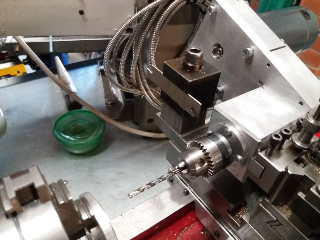

              Hi Jonathan herd is one i made a whikd ago with variable speed motor.
              If you want the drawings i can email them to you.
              David

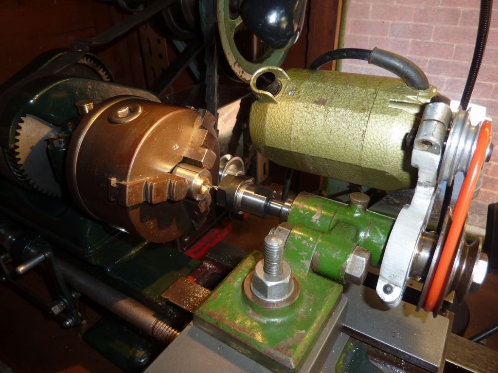

                Another option… a Potts spindle with an MT1 ER16 holder from China (with drawbar) and a belt drive. Traditionally these things were driven from a line shaft above I think but few people have those now. I made a sleeve from a bit of PVC drain pipe so that I could clamp my Unimat SL motor bracket onto it. Having the motor this way round helps with the overall length but is clearly not helpful with clearance/visibility around the job. It works though. In this pic I was using a small carbide milling cutter to higbee the start of an internal thread.
                I've also used a cannibalised flexi drive to make a toolpost drilling attachment for my little Cowells lathe. The drive motor (drill) can then be well out of the way. The flexi drive bearings would not cope with milling though.

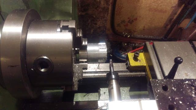

                      Posted by DiogenesII on 12/01/2022 06:51:52:
                      Posted by Nicholas Wheeler 1 on 12/01/2022 00:02:25:
                      That's what I use; an ER11 spindle motor, collets, clamp and power supply from Ebay. I bolted a piece of 10mm square bar to the clamp and fitted it into a quick change holder. took about ten minutes. It cross-drills, mills slots etc and will drill along the lathe axis too.
                      ..What's the lowest RPM that that will run at, Nicholas ?
                      No idea, but it's low enough for anything you can put in the 7mm collet to work well, like this 6mm ball end mill:
                      That's with it mounted to a vertical slide, which I did originally but it takes far too much setting up to be really useful. The QC holder means it drops straight into place. I didn't want to spend hours building something, but to have a tool that can save a considerable amount of time making another setup for a simple job like cross holes.

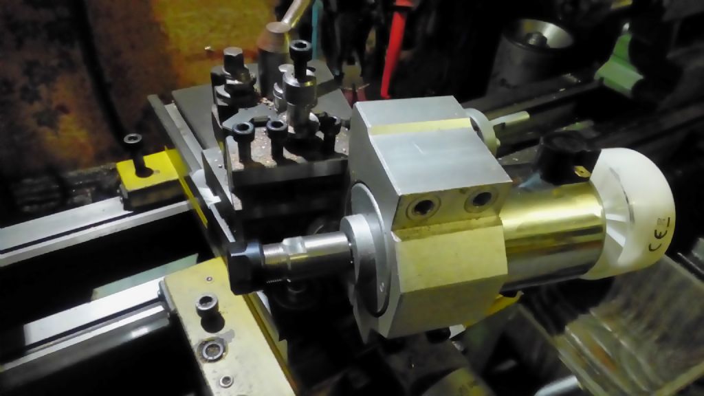

                        Another one based on an ER11 collet extension here:
                        One of the main limitations of mini lathes is their *very* restricted cross slide travel. My spindle has to be flipped over (which means swapping the motor mount to the opposite side of the body) between cross drilling and face drilling to give a reasonable working envelope.
                        Set up for cross drilling:
                        Set up for face drilling
                        The original 10mm diameter straight shank ER11 collet chuck. The only modification was to drill and tap the tail end of it M4.
                        The motor is from a child's ride-on toy and runs at ~3000 RPM on 12V. I have two sets of pulleys that can either gear that up or down to the spindle. Most (>99%) of the time I run it flat-out on the slowest gearing (so ~1800 RPM on the spindle).
                        The whole thing was made on the lathe – the spindle is mounted in a block of 38mm square aluminium bar that was trued up in the 4 jaw chuck – rough and ready cross-section:
                        The front bearing is a 3200 double row angular contact bearing and the rear bearing is a plain ball bearing. There was originally a spacer sleeve between the two bearings so that they could be clamped up tight with the outer race of the rear bearing floating in the housing. I though that it would be a good, solid bearing, but actually there was quite a bit of axial play in the double row A/C bearing (my fault – I didn't appreciate that this would be the case). To get around this, I just removed the spacer and used the clamping screw in the rear of the spindle to preload one half of the A/C bearing against the rear bearing. If making it again, I would replace both bearings with opposed A/C bearings with a proper preload adjustment.
                        It is quite capable of drilling 6mm holes in steel and some light milling.
                        Timelapse of milling steel (5mm HSS cutter):
                        They're very handy things!

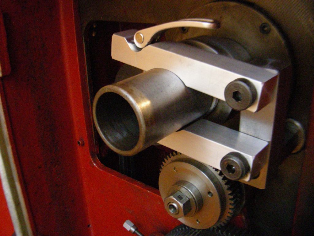

                              With that point in mind, I made this spindle lock for my Willson lathe:
                              The cam action clamp will be familiar to cyclists.
