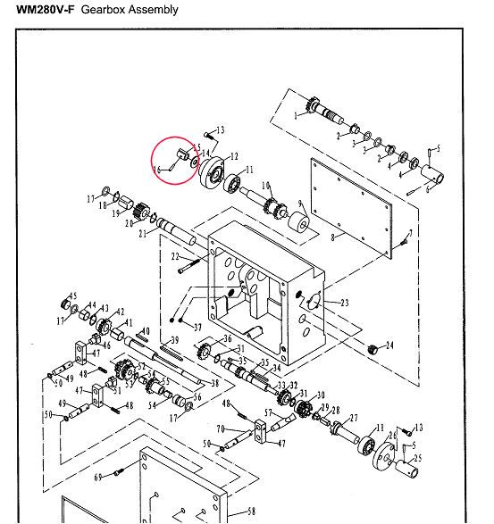

            I had a similar problem on my Warco lathe. A different model to yours but could be a similar problem. If you study the parts list there is a shear pin in the drive gear on the end of the shaft. This is designed to shear in order to protect the machine in the type of event you describe. If you don't have a spare in the supplied toolbox a piece of brass of suitable diameter will substitute. Don't use steel just in case of further 'accident'.

              Hi Mat,
              Oout of 'jamas now (but fully clothed), so here is a scan of my gearbox parts list. The pin is item 16 and secures the gib key collar (item 15) to the input shaft of the gearbox.  Click on picture to enlarge:
              Hope this helps,
              Seasons greetings and Best regards,
              Terry

                Thanks for the diagram, I need to dig my manual out, it did mention shear pins, is it possible that they're half sheared and half working? How hard is it to disassemble?

                  It is not difficult to dismantle the input shaft. you just need to remove the drive gear from the end of the input shaft, then the collar with the key simply slides off after knocking out the remains of the shear pin with a slim pin punch.
                  My leadscrews turned when engaged but stopped when I engaged the half nuts. It was the inherent friction between the collar and driveshaft that was driving the shafts.

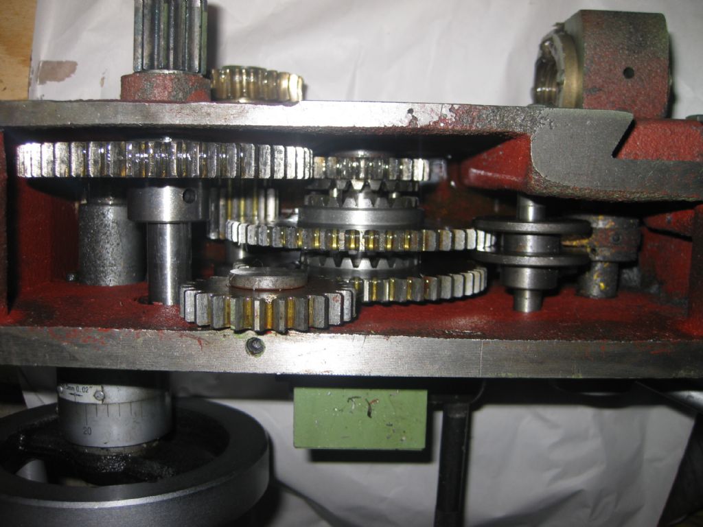

                              Hey Mat, if you can please take some pictures of the internal gubbins as I've not found any on the web so far.

                              Mathew Lee
                                @mathewlee79288
                                There you go
                                Edited By Mathew Lee on 02/01/2013 21:58:16
                                #107815
                                Bazyle
                                  @bazyle
                                  Thanks, Mat, Interestingly the threading interlock bobin isn't shown on the 9249 parts.diagram. Some other differences so not all designs are exactly alike.
