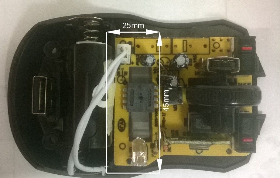

      I have been mulling over a suggestion I first mooted in 2013! It concerned the possible use of a mouse sensor as a device for producing an output to a display for use as a DRO for lathes, mills and the like. There have been a number of threads lately regarding the fitment of scales to, particularly, lathe cross slides and how they might restrict the movement of them and also interact with the chuck and/or tailstock. That set me off thinking, again. Always dangerous, but having a brief interlude in the metal-mangling, I thought – why not?
      So I took an old mouse to pieces and had a look at the innards:
      Not a laser mouse, but an LED one. I don't have one of the former. The rectangle indicates where I reckon the business end of the positioning electrickery is. Research has lead me to the conclusion that a laser sensor can detect movement changes of as little as 1 to 2 microns, better than my DRO glass scales, at 5µm. I therefore thought that if the sensor could be mounted in a suitable housing and secured to the cross slide, reading against an adjacent fixed part of the saddle, would it not be possible to utilise the bluetooth capabilities of a wireless mouse to communicate the output to a program running on a computer, tablet or phone in much the same way as Yury has done for the TouchDRO system? See Here.
      Regrettably, I don't have the knowhow to implement the idea and write the necessary code to interpret the quadrature output into a meaningful display.

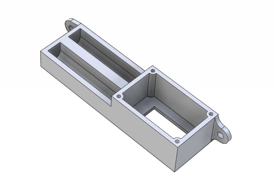

      housing
      The overall size of this would be in the region of 20mm x 30mm x 90mm long (plus mounting lugs).

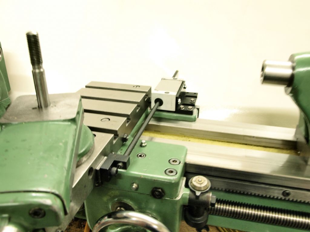

                                  John in first posting mentioned interference with tailstock.
                                  Photo shows minimal interference on a Myford S7 using a commercial (Newall) product.

                                    I know its only my opinion but that does not look like 'minimal' interference with the tailstock, it also looks extremely vulnerable by being bumped into by the tailstock.
                                    At a guess it looks like 30mm or so of lost tailstock travel towards the carriage. I have a much larger lathe and the magnetic scale mounted in the same place as yours only adds 10mm to the carriage width. and its more or less solid ali extrusion so does not mind being hit by a heavy tailstock.

                                      20mm to be precise, not much when you have 95mm travel on tailstock even if you are touching , a buffer below the bed level prevents collisions.
                                      Has not caused any difficulties in actual use. If you used a glued/screwed on magnetic strip you would get let less loss of travel. What was the make you used?

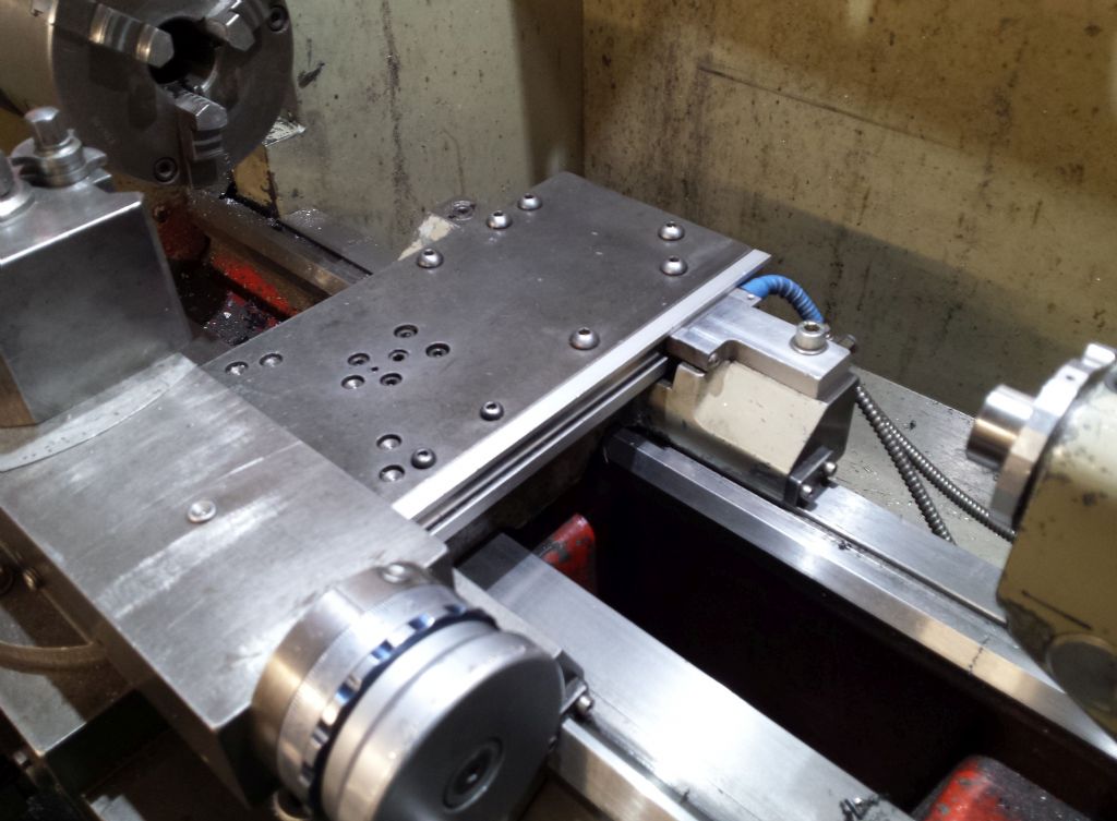

                                          The scale is the magnetic one from Machine DRO
                                          Tapped holes filled with button head screws came with the lathe (Harrison M250) I assume they are not original

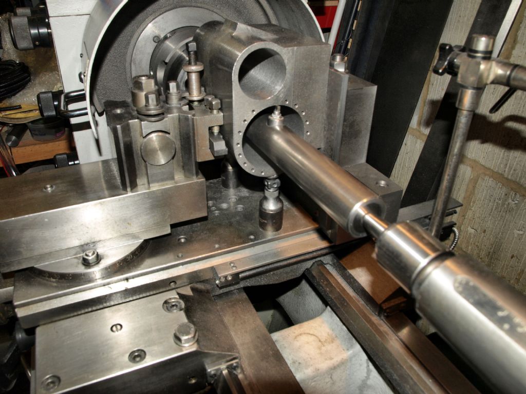

                                            I lost 15mm on the M300 but kept the dovetail edge of the cross slide.Highland/Black5 Main Cylinder

                                              I see your cross slide also has tapped holes, the ones on my M250 seem to be in mostly random positions and none really line up with counterbored holes in the (still unused) tee slotted milling table that came with the lathe.

                                                    Ian, accessories? I guess so, but I made my own.
                                                    A rear "post" that supports a drilled plate that allows for both the main bore and valve bore of the cylinder block (7.25" guage) to be line bored, actually jig pinned for exact copies. Shows clearly in the photo, boring bars fitted with Microbore adjustable tooling.

                                                      I know this is prolonging this off-topic discussion, but is the rear 'post' bolted straight down to the cross slide or does it in some way locate on the side dovetails?
                                                      Either way the cylinder block looks a lovely bit of work.
