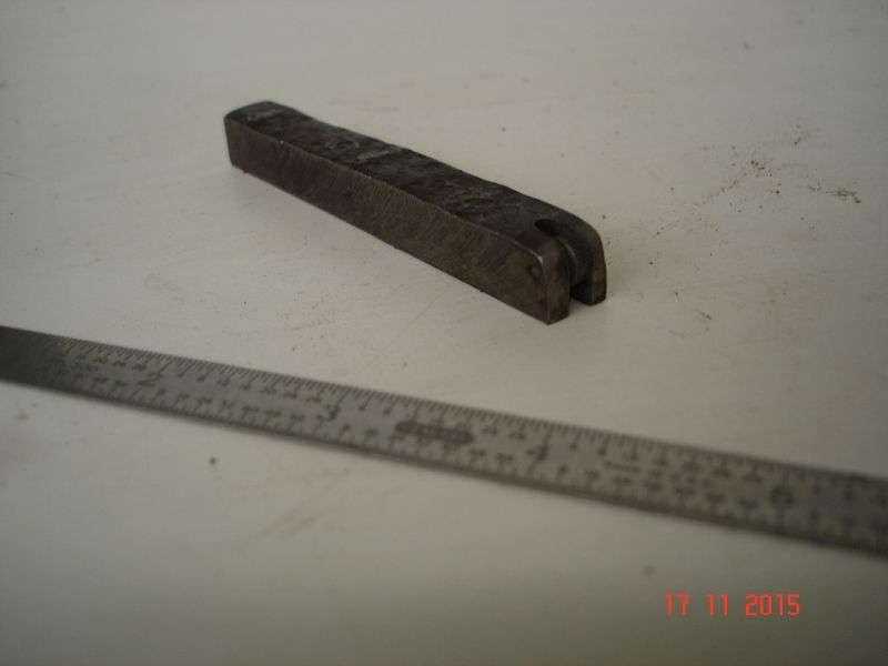

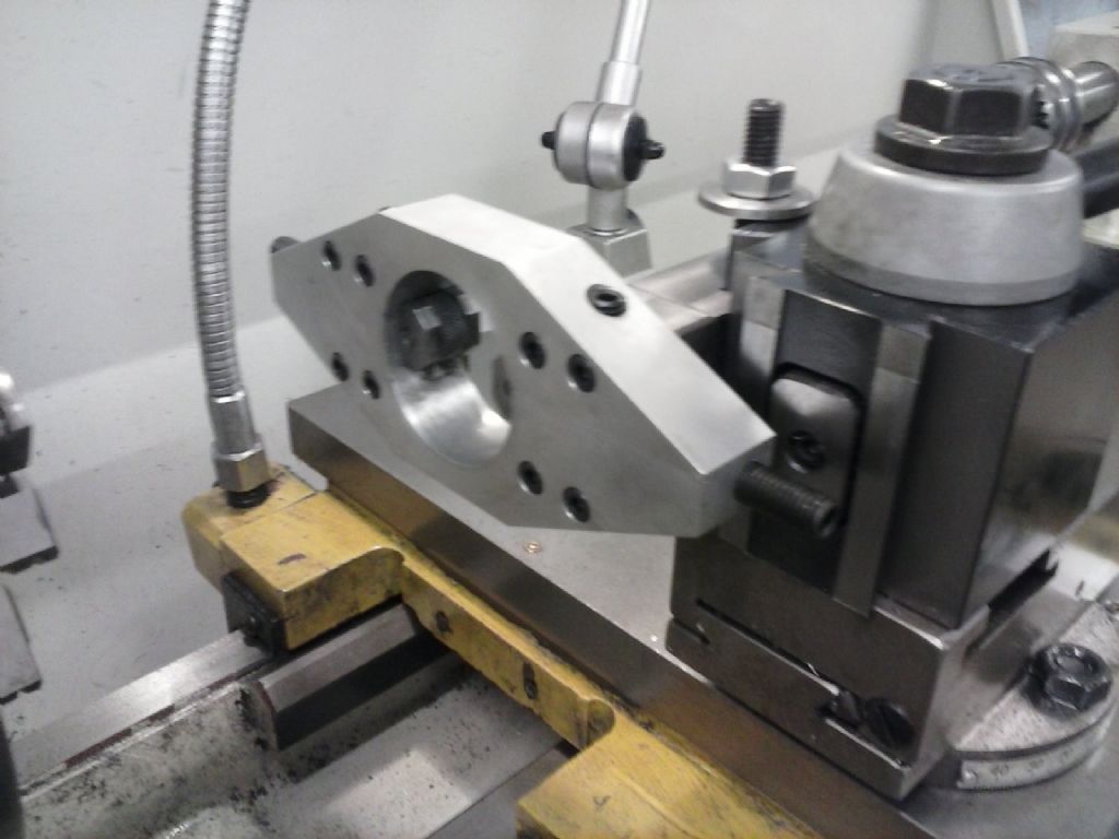

            Ajohnw
              @ajohnw51620
              These are a photo's of 2 designs in my main album. Th best one by far has plates on the side as per Vic's.
              There are some none clamp on types about that will work well but they may bend small parts.

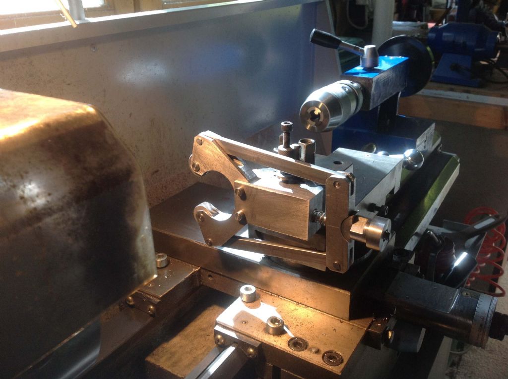

                John Hinkley
                  @johnhinkley26699
                  Graham Meek has a nice design of knurling tool in his book "Projects for your Workshop" I made one but altered the mounting to attach it directly to my QCTP. It works very well with a capacity of up to 60mm diameter, although I have used it in "push" mode to knurl the feed ring on my boring/facing head (78mm diameter).
                  knurling tool
                  All the joints need to be a good fit with no sloppiness and the knurls themselves should be parallel and in alignment, wherein I suspect a lot of your problems lie.

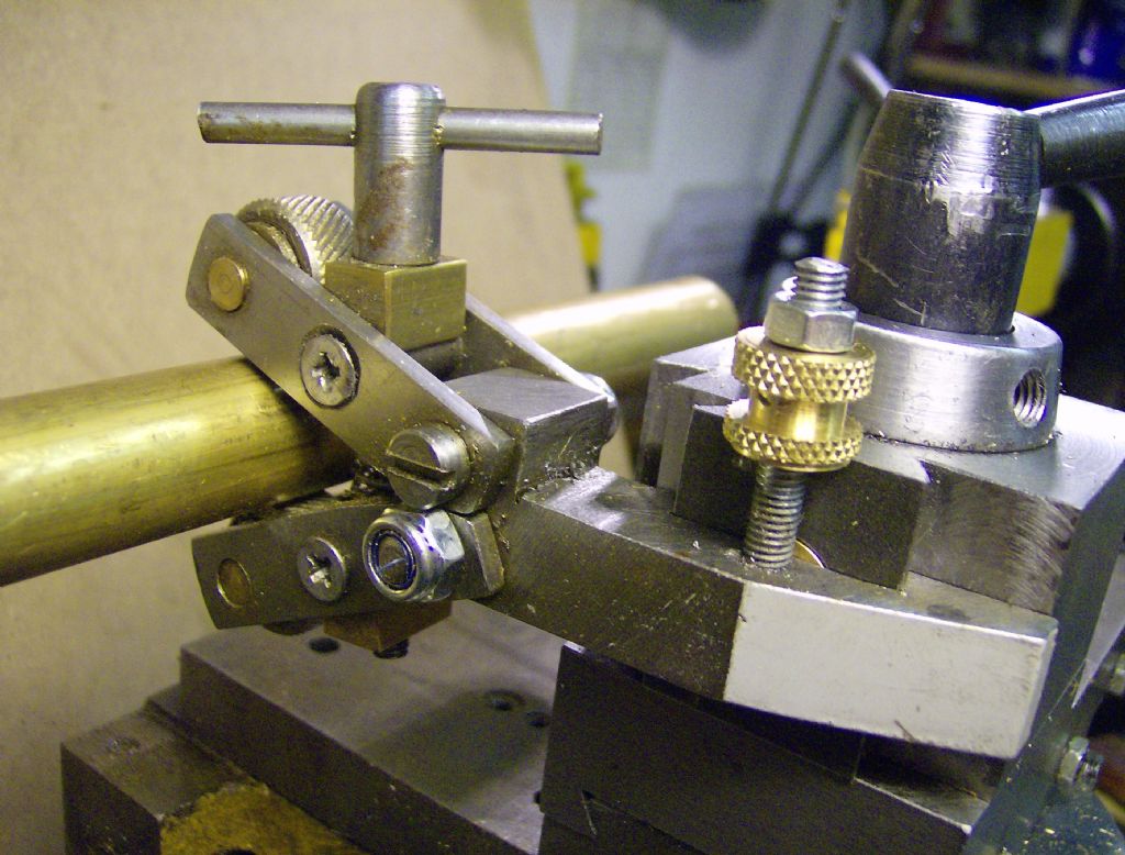

                    #246022
                      I don't buy the need for rigidity, this is my scrappy knurling tool and it does a first class job every time (including the brass knob in the photo and the aluminium parts in the image below).
                      QCTP Knurling Tool
                      #246028
                        Posted by Neil Wyatt on 09/07/2016 22:20:14:
                        Neil,
                        Question … Are all your knurlings 'less than or equal to' the width of your knurls [not conclusive from the photos], or have you traversed the tool? [I think that's where rigidity might prove beneficial].

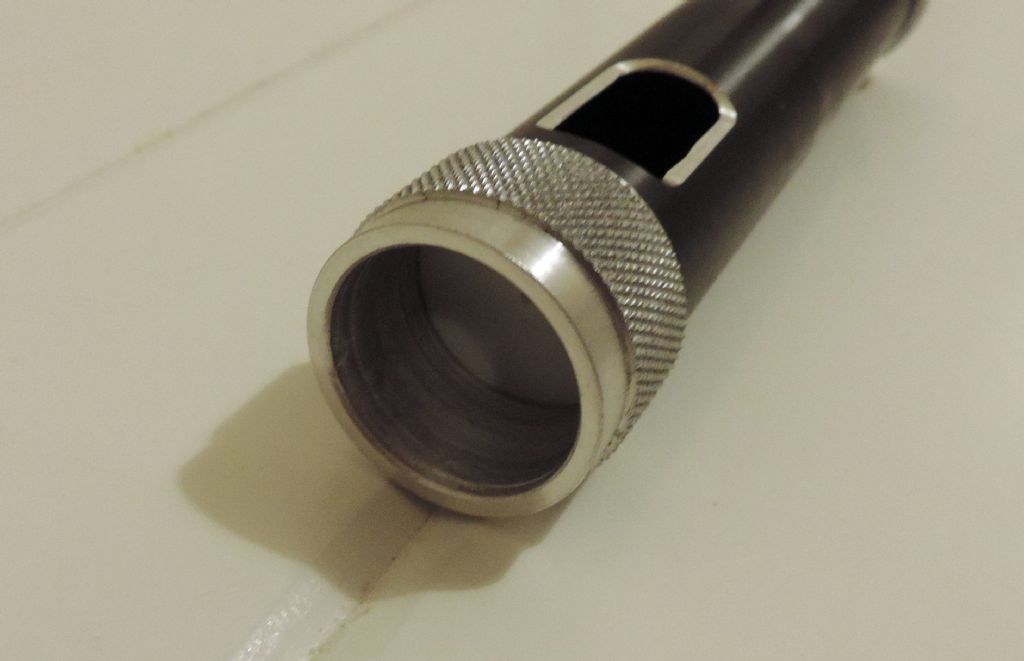

                                                  #246236
                                                  Ian S C
                                                    @iansc
                                                    For nice fine straight knurling, this one is a good one, it takes only a few minutes to make. Got the idea from Stan Bray's book "Introducing the Lathe", you need a bit of scrap steel about 10 mm sq x 75 mm long a small hard pin (old needle roller), a little piece of bronze for a bush, and a flint wheel from a ciggy lighter (I used a BIC disposable). Sorry the photo is not great.dsc01160 (800x600).jpg
                                                    Ian S C
