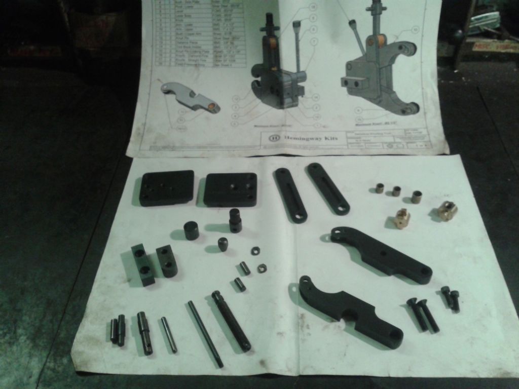

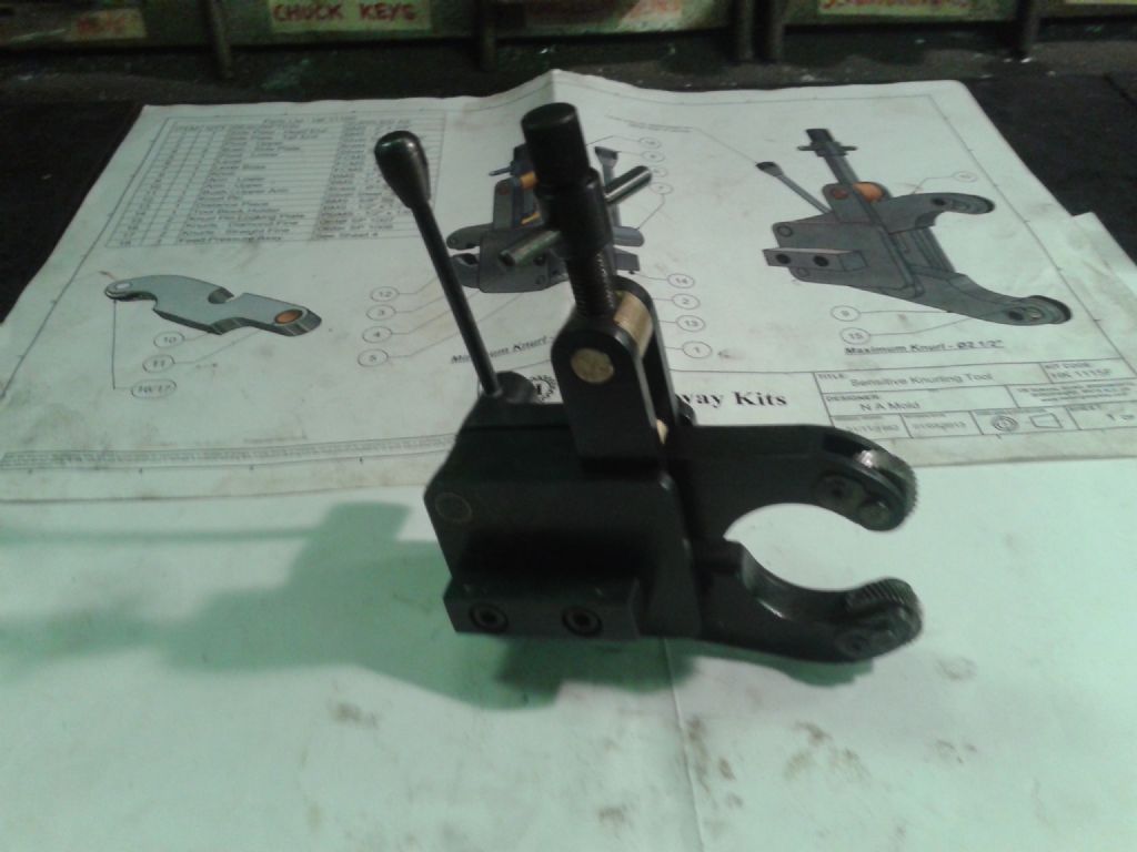

                  #357689
                  thaiguzzi
                    @thaiguzzi
                    phone photos to sept 2017 541.jpgphone photos to sept 2017 542.jpgI like the Hemingway Kits Marlco copy. Not expensive, relatively easy to make, and does what it says on the tin.

                      Hi thaiguzzi. I looked at the Hemingway kits. Do they come as a kit of parts that just needs assembling or is there some machining to do as well?

                        #357701
                          Posted by Nige on 14/06/2018 08:20:26:
                          They just supply a pile of materials, you need to make each and every part.

                                  I made the Hemmingway kit some years ago. If my memory is correct, the actual wheels are a bit of an oddball size and the choice of knurl is limited from Hemmingway. However choices were available from Cromwell Tools.

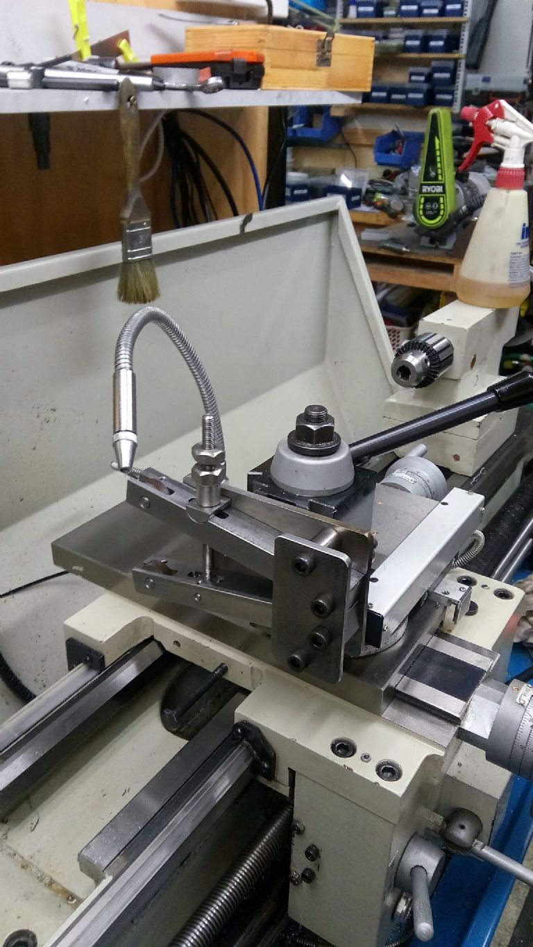

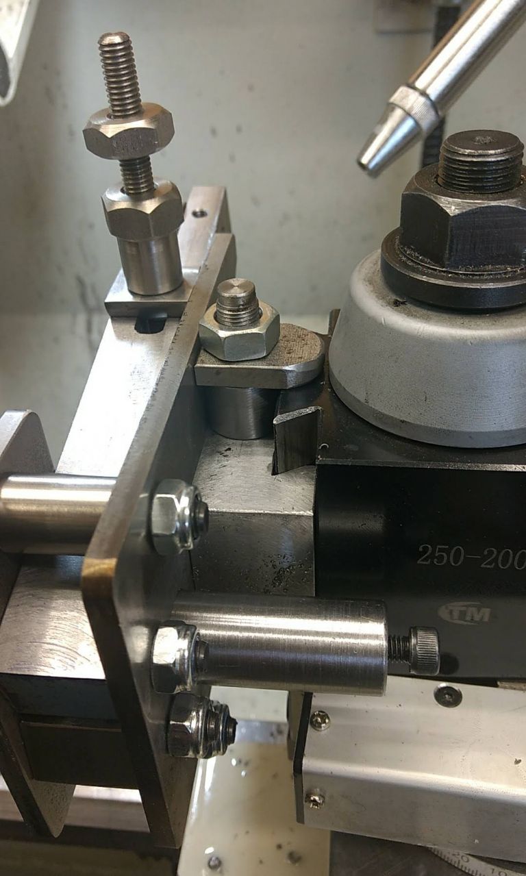

                                    Form follows function
                                    QCTP Knurling Tool
                                    #357819
                                    thaiguzzi
                                      @thaiguzzi
                                      Posted by Spurry on 14/06/2018 11:21:05:
                                      Pete
                                      Indeed.
                                      Hemingway drawings quote a 1/4" wide wheel.
                                      I had 3/8" wide x 3/4" OD wheels lying around spare, so ground them down to 5/16" wide in the Stent, and used them.
                                      #357820
                                      thaiguzzi
                                        @thaiguzzi
                                        Posted by JasonB on 14/06/2018 08:24:55:
                                        Yep, drawings included as well.
                                        #357821
                                        thaiguzzi
                                          @thaiguzzi
                                          All the Hemingway stuff comes as basic materials and drawings, some with instructions. You need to machine everything, but this particular kit is not difficult. I also found it to be reasonably priced.
