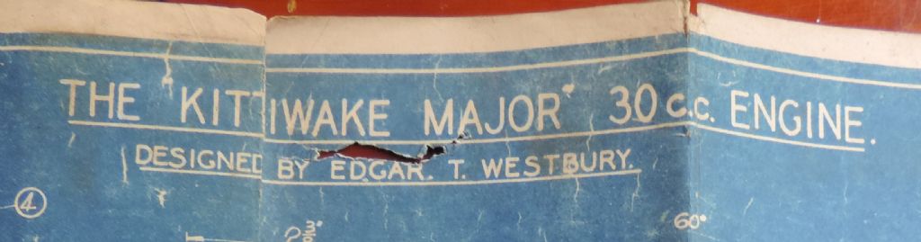

                                                    Here is the original blueprint:
                                                    The plans are definitely marked Kittiwake Major:

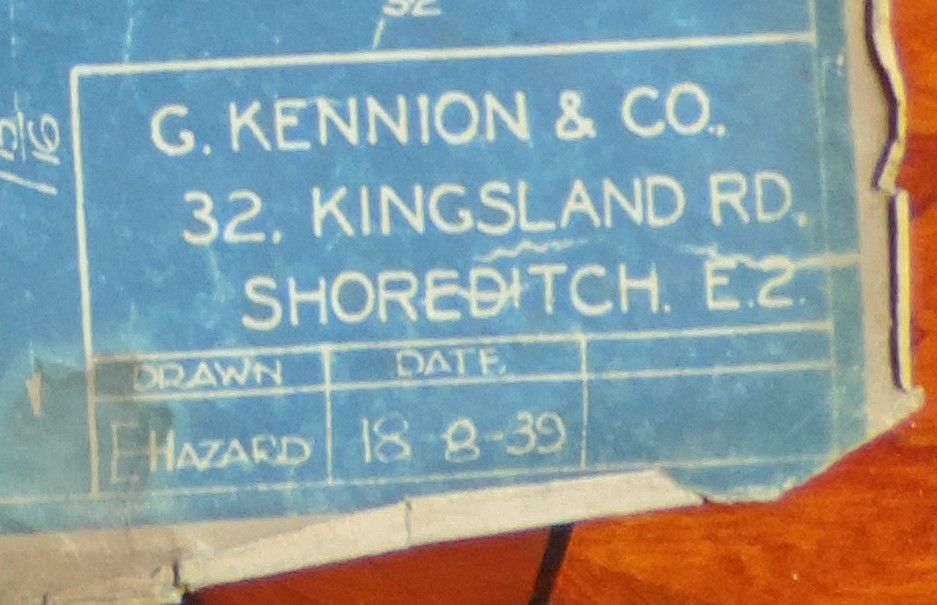

                                                    But I was wrong about the year, my conspiracy theory crumbles! It's 1939:

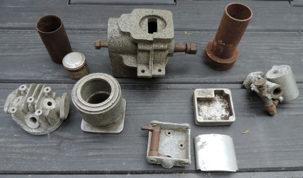

                                                    And the castings themselves:
                                                    I think they may be ally, they are light, but not super-light and don't look black at all. There's no corrosion where they have been in contact with other metals either which apparently is worse with magnesium. They may have been fettled as one inside surface shows signs of sandcasting where it was a little short of metal.
                                                    The rocker cover was anodised by my benefactor, apparently some 50 years ago! It's a bit scratched but the upper surface is still bright. Might be teh best way to fish the model, if I can get a good enough finish.
                                                    Screws holding the crankcase together (brass) were not seized and came out easily. I used some Lidl rust-dissolver spray and the lovely castellated nuts at each end of the crank came free.after about ten minutes with modest effort. The crank came out of the bearings with a gentle tap from a nylon faced hammer.
                                                    Inside the crankcase is clean, despite being partly open to the elements. The central portion of the crank is sound though I may need to skim the big end, or rather polish it. It's in Evaporust now, and I expect to get a wholly usable part as it runs in bearings. I expect the 1:10 taper to be fine as it is very fine rust, although all over, presumably it's a good hi tensile steel that resists rust.
                                                    The cylinder liner looks great on the top half – still shiny! – but the bottom is corroded more, not sure if it will be possible to rescue it by honing until evaporust does its work. I think the piston rings could compensate for 2-3 thou of honing, if not there is a cast iron blank for another cylinder liner.

                                                      The bearings – two sets of ball races, 0.500 x01.125 x 0.250". One with 16 crowded balls, and two opposed insertion notches – you don't see that often these days. Marked "Hoffman Made 5.5 " on the outer race and "c.o. 5.5" on the inner
                                                      The other has 11 balls in a brass or bronze cage of riveted construction. "KL 2" on the outer and "KL 14P2" on the inner.
                                                      The back one had plenty of clearance to get it out with a bit of 15mm copper pipe and the little nylon hammer.
                                                      The front one was at the back of a hole just clearance for the crankshaft (to stop oil leaks). I had to use the shank of an old 13mm drill which just tapped into the hole and then forced the bearing out.
                                                      The accuracy of the light press fits of the bearings on crankshaft and in the crankcase suggest the work was done by someone who really knew their stuff.
                                                      I don't suppose Ketan lists these under the old numbers, but a pair of R8s should be fine (at least one has to be open as the oil passes through it to get back to the pump, but maybe a R8RS at the front and slightly open up that clearance hole in case it has to come out again.
