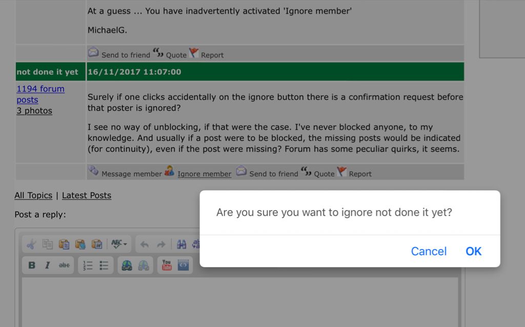

                                        #327427
                                        not done it yet
                                          @notdoneityet
                                          Can anyone tell me why I cannot see the posts by Douglas Johnston, please? They are totally invisible, only known to exist from quotes and the 'lastest forum posts' list!
                                          #327428
                                            Posted by not done it yet on 16/11/2017 10:19:30:
                                            At a guess … You have inadvertently activated 'Ignore member'
                                            #327440
                                            not done it yet
                                              @notdoneityet
                                              Surely if one clicks accidentally on the ignore button there is a confirmation request before that poster is ignored?
                                              I see no way of unblocking, if that were the case. I've never blocked anyone, to my knowledge. And usually if a post were to be blocked, the missing posts would be indicated (for continuity), even if the post were missing? Forum has some peculiar quirks, it seems.
                                              #327449
                                                Posted by not done it yet on 16/11/2017 11:07:00:
                                                Indeed there is:
                                                But it was the only explanation I could suggest.
                                                I think you can administrate blocked members via the 'Settings' menu
                                                … but I'm on the 'bus at the moment, and one demo is enough.
